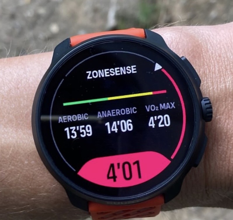

    Stoke80S
    @EzioAuditore Thank you for your answer. One Space more for another S+ App
