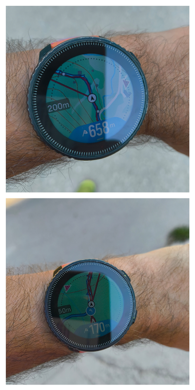

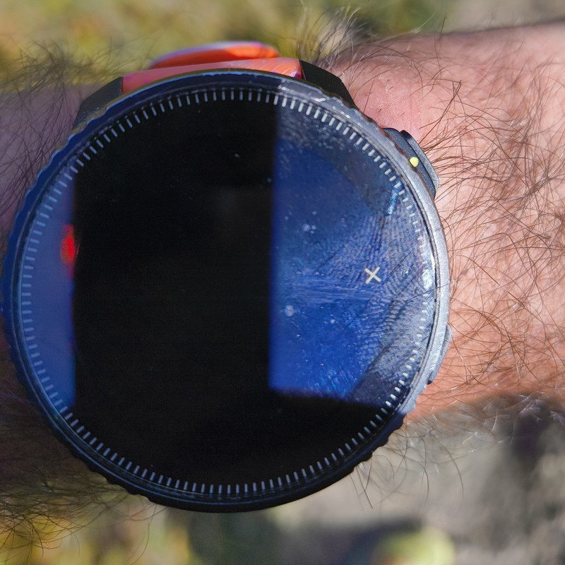

      For a few months now, there have been some pretty serious problems with navigation with GPX routes.
      The first is some craziness with breadcrumb trail. The watch shows some nonsense location, non-existent traces, incorrect position on the map. It’s a scandal that such a basic and crucial function was broken by bugged software updates (watch and SuuntoApp). Does anyone at Suunto even test this or, as usual, a handful of clappers claim that there are no problems?
      alt text

          • inkognitoI Offline
            inkognito Platinum Member @maszop
            @maszop
            The only strange behaviour connected to breadcrumb I noticed is that strange straight line visible in your photos. It sometimes appears after a pause while/or if the watch loses GPS signal, and it seems to point directly to the beginning of your activity. It disappears immediately when the location moves.
            When it comes to route sync during activity, aren’t you just a bit too fast? The sync can take 10–20 seconds, and if you use your watch during this, you might interrupt it.
            The last one happenes to me as well, and I think it is connected to climb guidance. It usually happened when I directly changed my route during steeper ascents or descents. Loading a new route immediately triggered this black/empty pop-up and dismissing it takes you back to route selection. To overcome this, do not select a new route directly, but first switch navigation to breadcrumb and only after that select your new route.

              @inkognito Thanks for the climb guidance hint. It’s quite possible that this is the source of the problem. I hope it gets fixed soon.
              As for the first problem, it’s definitely not a GPS issue, because reloading the same route clears all this rubbish from the watch screen and the current location is displayed correctly and the breadcrumb is displayed correctly. For some time, until the watch starts displaying some nonsense on the map again, as if it kept going back and forward to the same place in some completely uncontrolled way.
              M 1 Reply Last reply Reply Quote 0

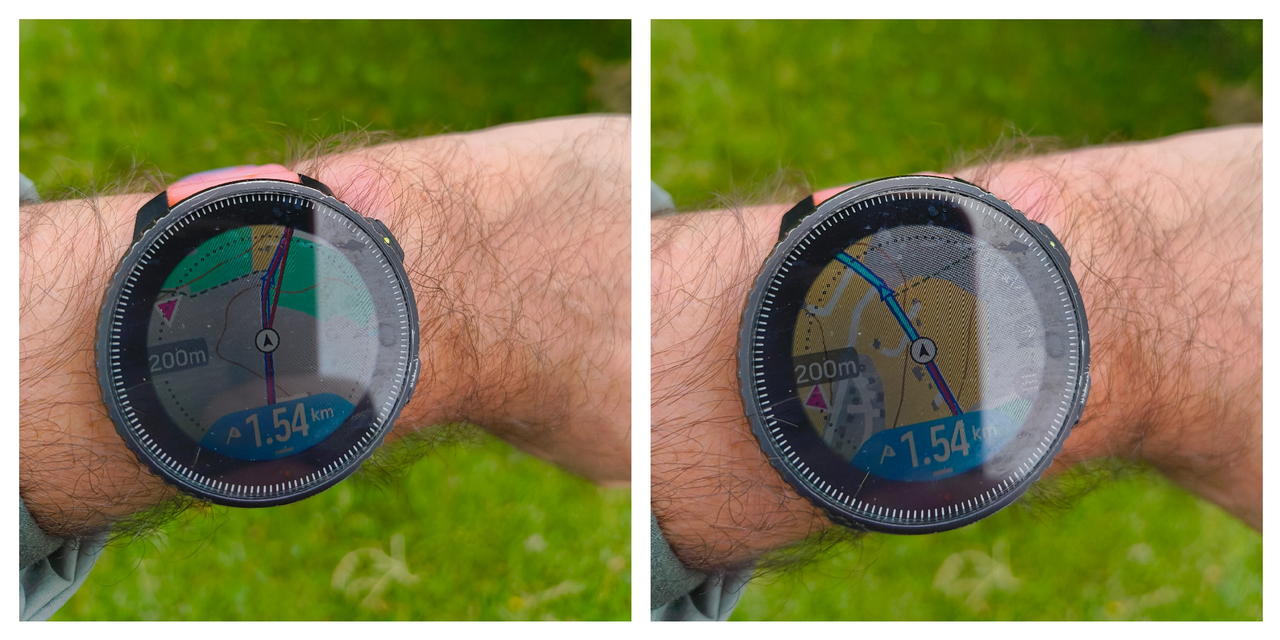

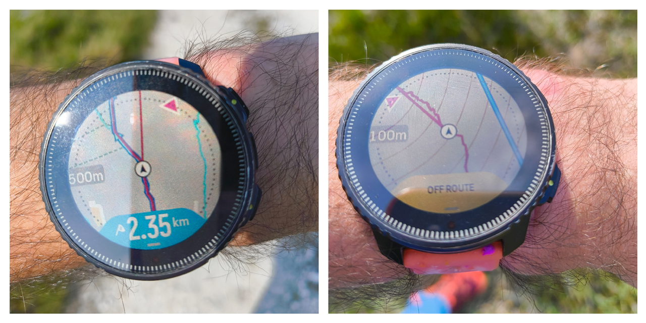

                Today I decided to take a closer look at this problem. I managed to catch 4 cases of this problem during one activity.
                The problem results from the fact that the point with the current location sometimes does not update despite further movement.
                This results in the map view either not updating (1 case today), or it displays an incorrect, outdated position on the map and such a crazy breadcrumb (3 times today) because the actual route is recorded (real breadcrumb) and additional breadcrumb lines relative to this outdated point with an incorrect current location.
                Reloading the gpx route updates the screen and fixes the breadcrumb. It’s definitely not a gps error because regardless of the craziness on the watch screen the route saves correctly.
                In my opinion, this is a critical bug. With these types of bugs maps and navigation are unreliable, if not useless.
                alt text
                alt text
                Left - before, right - after reloading the route.

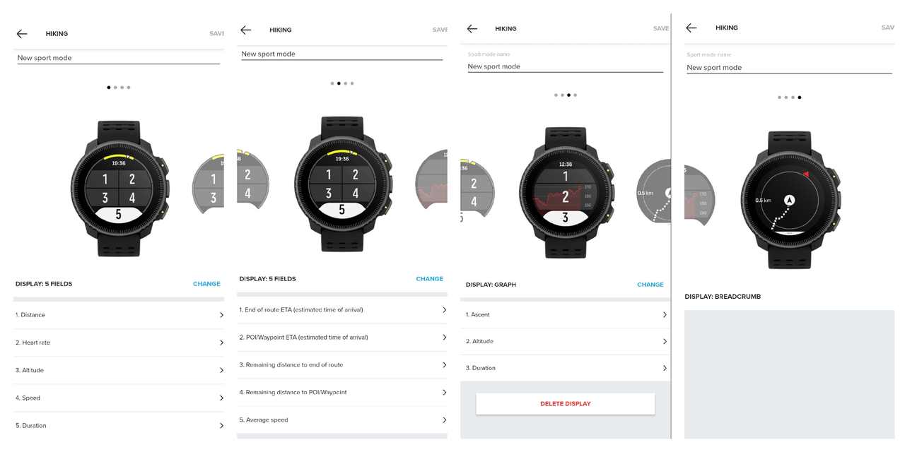

                                        @Egika Custom: GPS - best, Touch - disabled, Display timeout - off.
                                        Basically all like a Performance mode but with touchscreen disabled.
                                        Other options
                                        Custom mode hiking.
                                        Ruler: disabled.
                                        SuuntoPlus (yesterday’s setup): Last km/mile, Weather Insights,
                                        OHR.
                                        alt text

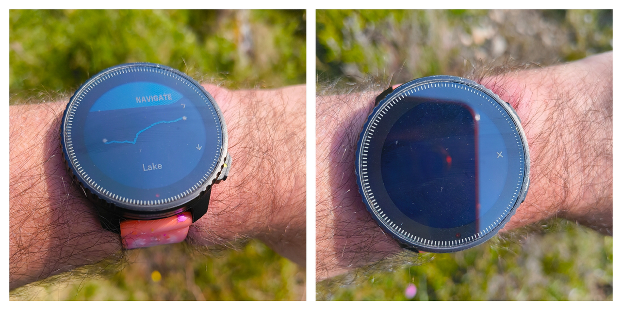

                                          I’ve done some more tests recently.
                                          It’s possible to add a completely newly designed or imported to SuuntoApp route to the watch during an activity. It doesn’t have to be saved in SuuntoApp beforehand. There are some problems with synchronization during an activity, but it works eventually.
                                          However, there’s a rather annoying bug when changing the route during an activity. During an ascent or descent, you can’t change it on the fly - there’s some conflict with Climb Guidance (black screen with X symbol on the watch). To get around this, you have to completely disable the current route (Breadcrumb option) and only then load a new route.
                                          I hope this gets fixed because I usually don’t have time to mess around in the field with such non-intuitive route changes.

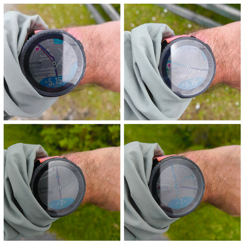

                                            @maszop Several months have passed, and of course, nothing has changed. The problems remain.
                                            It’s still impossible to change the route during ascent or descent.
                                            And there are still serious problems with breadcrumb display.
                                            alt text
