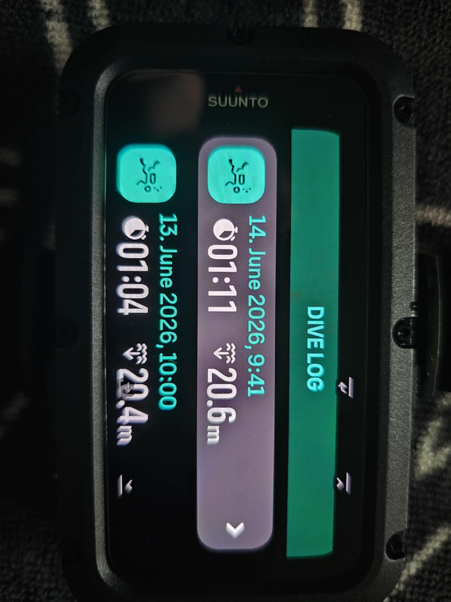

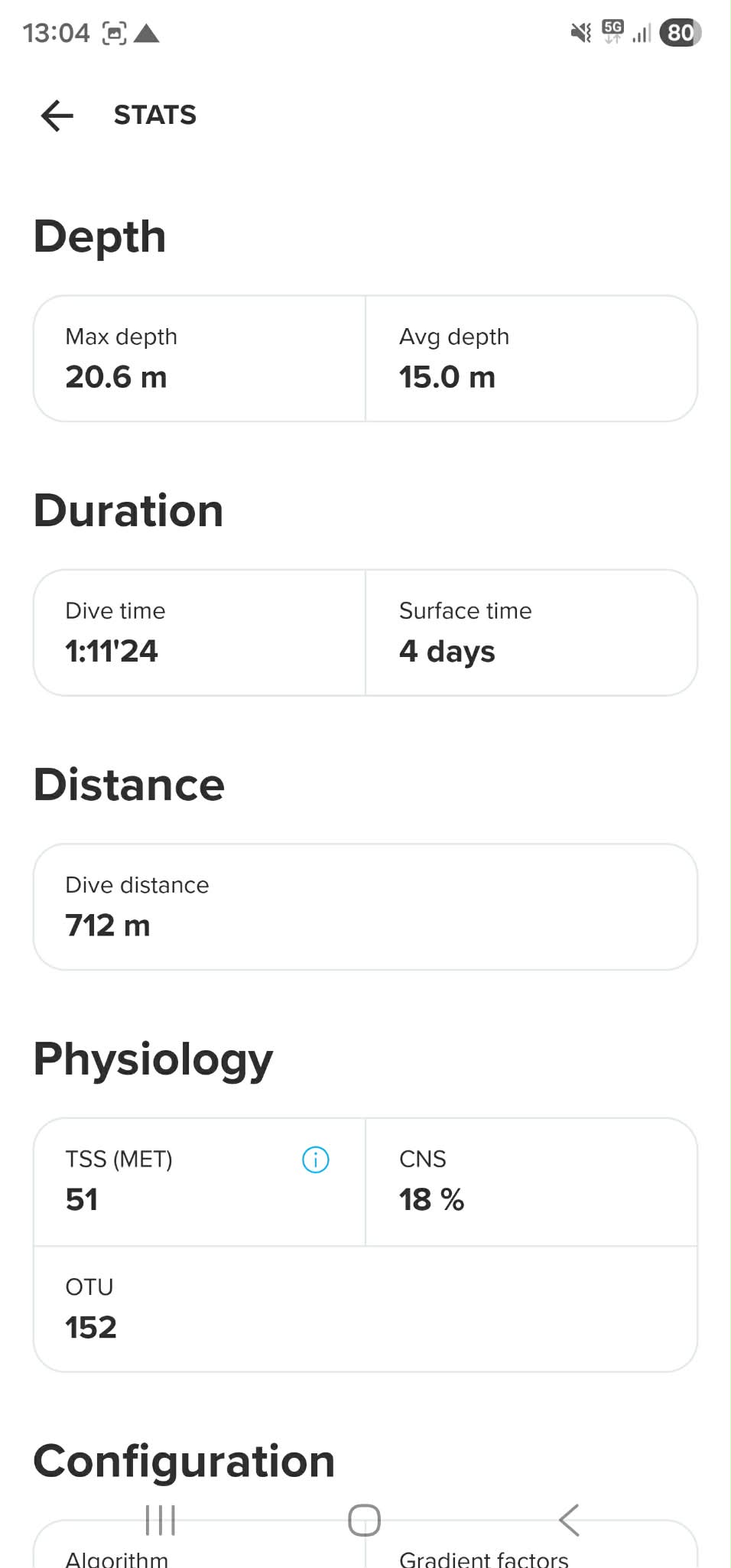

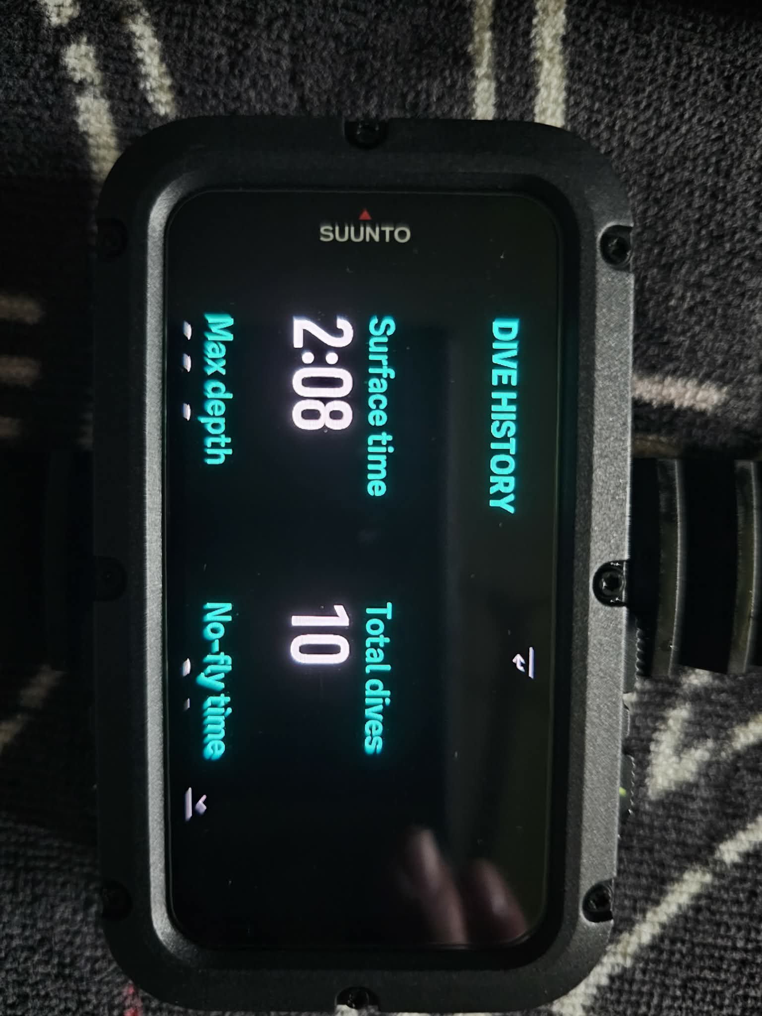

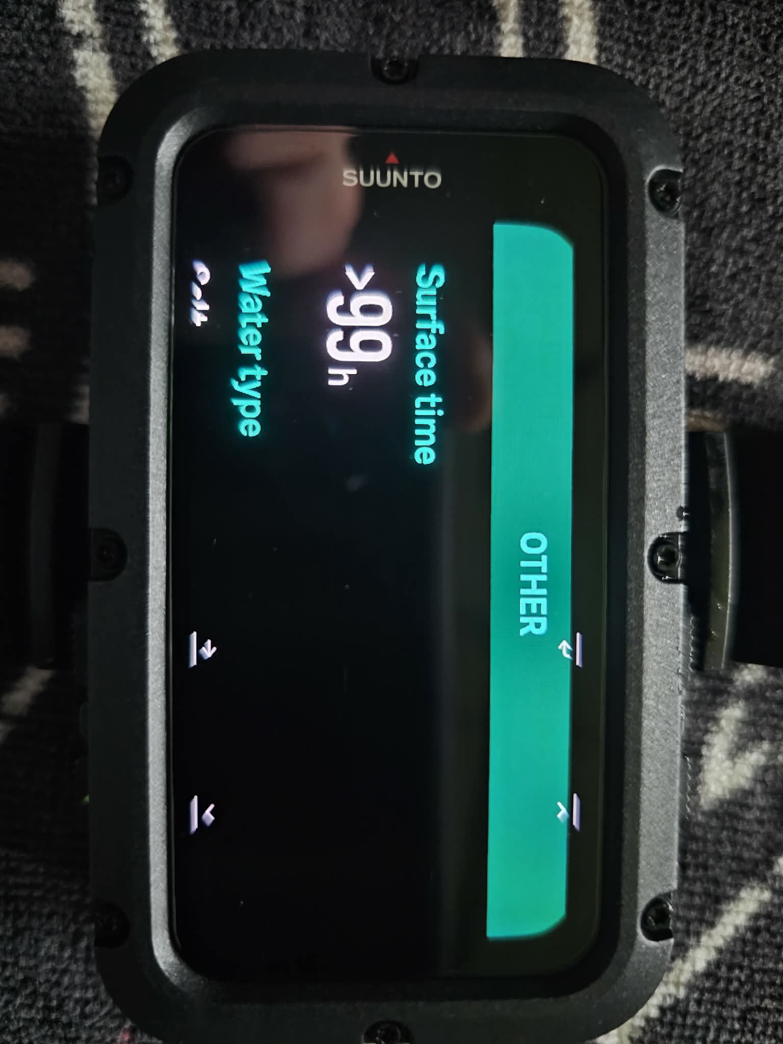

      I recently purchased the Nautic, but am having trouble with the device not logging the correct Surface Time for daily diving events. The Surface Time is being correctly tracked on both the Surface Screen and in the Dive History menu, however once a dive is saved to the internal log, the log data is showing Surface Time as being >99 Hours, and once synced to the app, it is showing as 4 days there also.
      As an example, I went for a dive on Saturday morning, after not diving since the previous weekend, so that was fine with Surface Time being >99hrs. However, the dive on Sunday morning was ~24hr since the last dive, and the Surface Time on the Surface Screen indicated this correctly, but after the dive when it saved, the log data was indicating >99 Hours (and 4 days on the app).

      • That the Surface Time is correctly being indicated on the Surface Screen and Dive History menu (currently showing 2 Hours 8 Minutes in photos).
      • A photo of the internal Dive Log to show 2 dives within ~24 Hours.
      • A photo of the internal log data from the dive on the 14th June, incorrectly indicating a Surface Time of >99 Hours (should be ~24 Hours).
      • And finally, a photo of the Suunto App log once synced, showing a Surface Time of 4 Days for the dive on the 14th June.

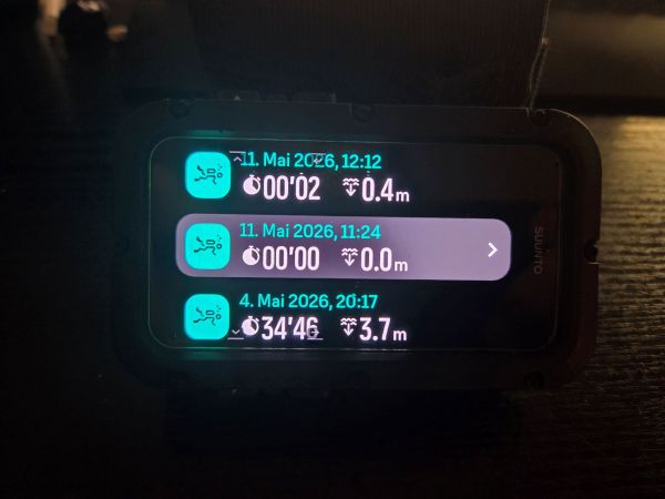

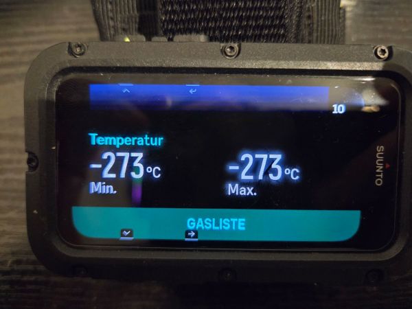

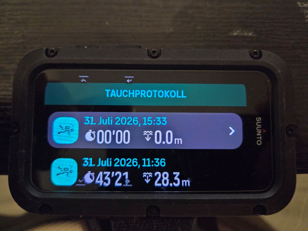

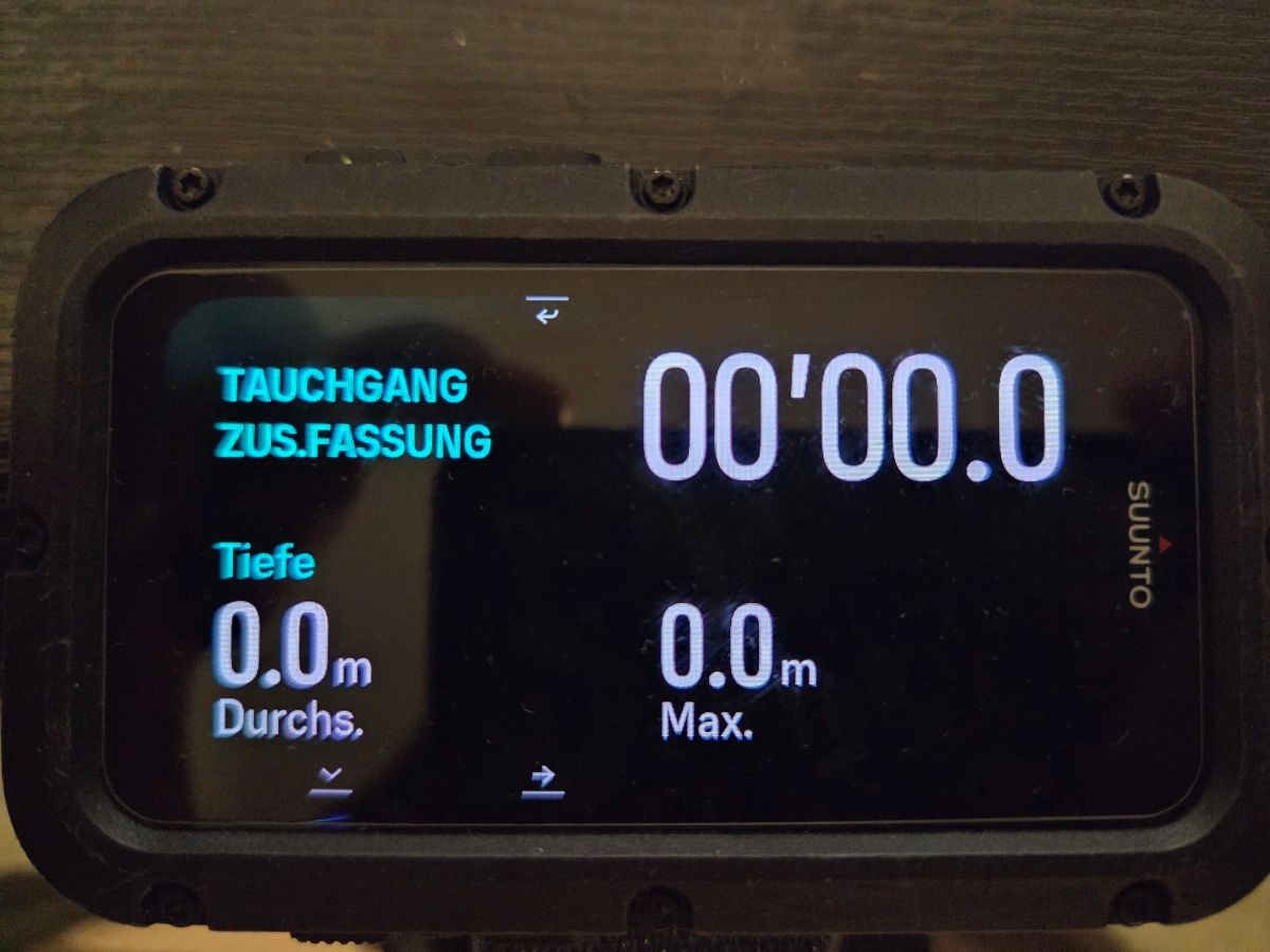

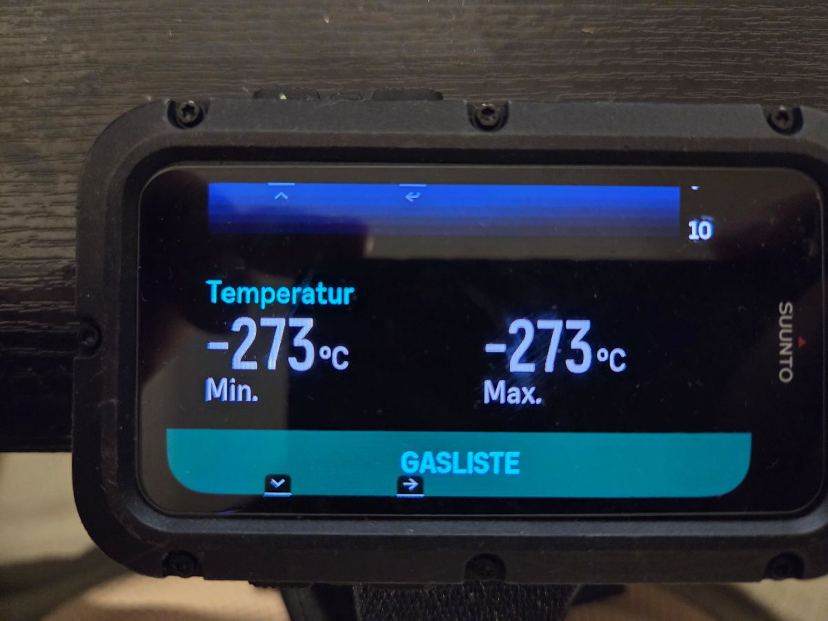

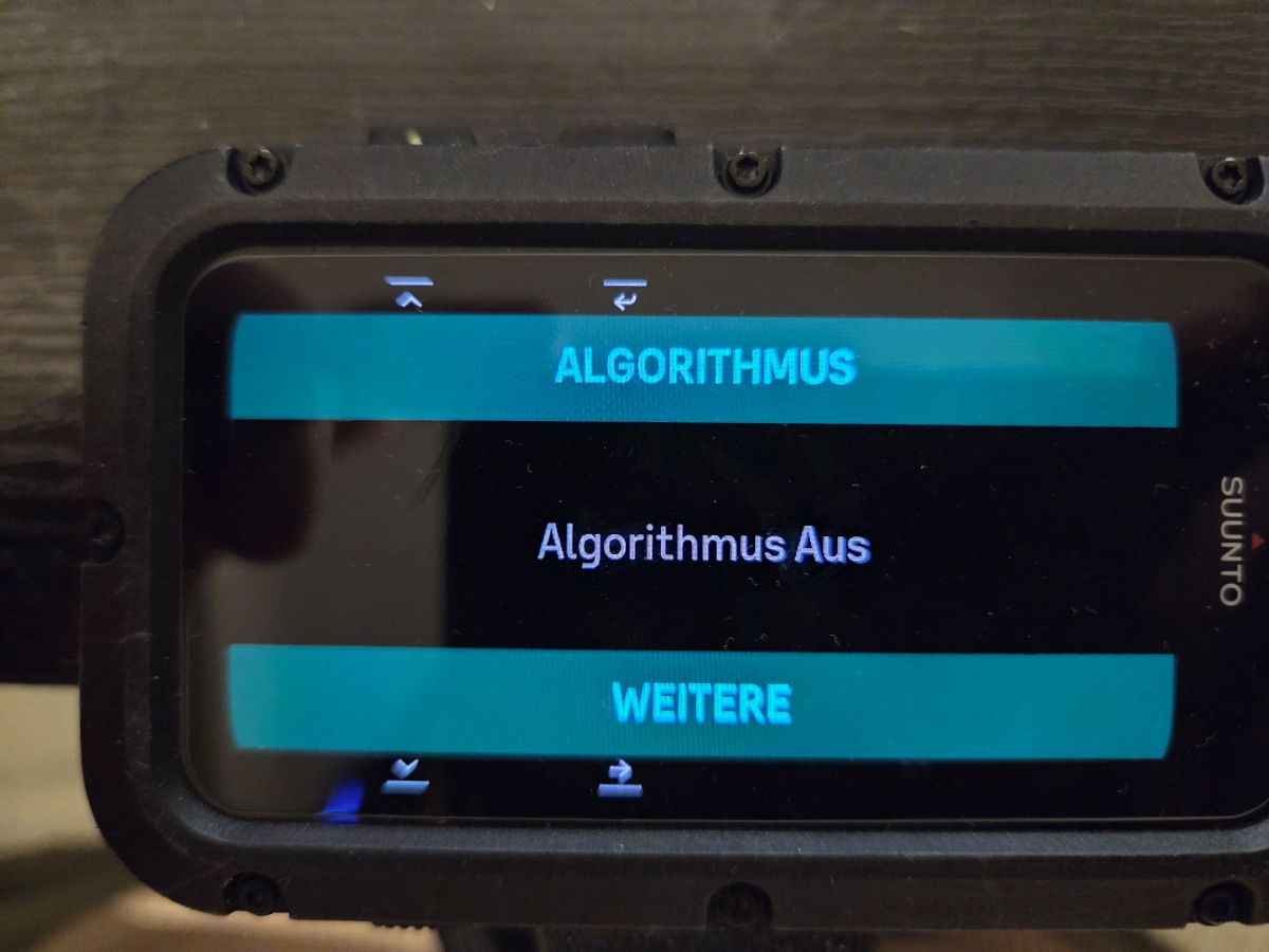

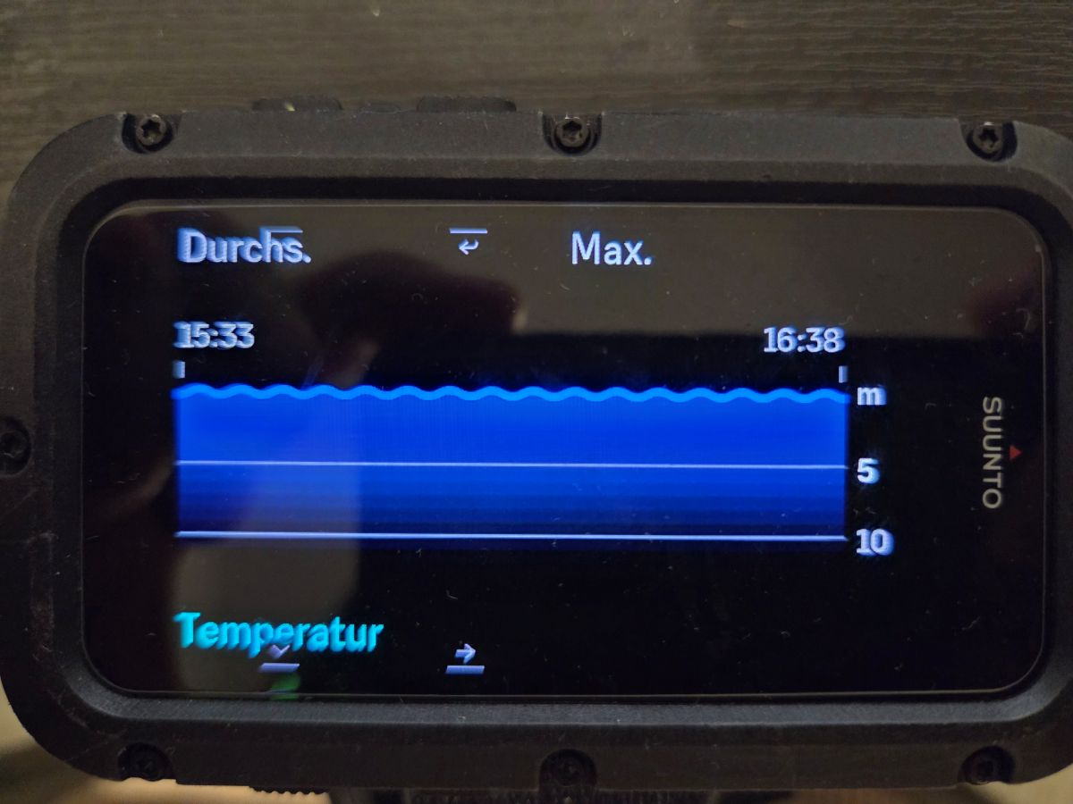

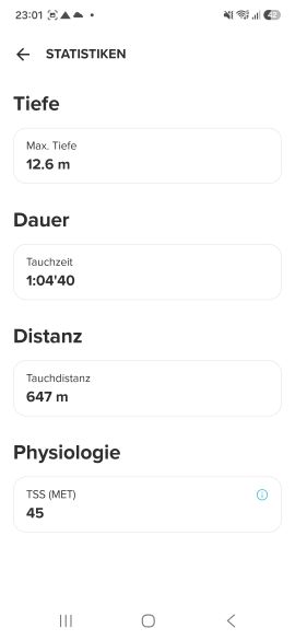

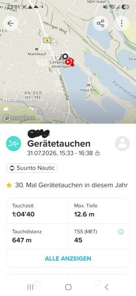

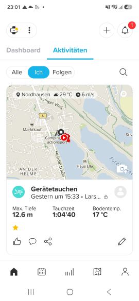

          Here we go again. Another completely broken dive log from the Suunto Nautic.
          The actual dive lasted 1:04:40, with a maximum depth of 12.6 metres and a water temperature of 17°C. The Suunto app even shows these values correctly.
          But on the Nautic itself, the same dive suddenly shows:
          00:00 dive time
          0.0 m maximum depth
          0.0 m average depth
          –273°C minimum and maximum temperature
          a completely useless depth graph
          missing or obviously corrupted dive data
          Seriously, Suunto: –273°C? Absolute zero? Was I diving in outer space?
          This is not a minor cosmetic issue. This is a dive computer that cannot even display its own recorded dive data correctly. The data clearly exists because the app shows it, but the computer itself displays complete nonsense.
          There have already been numerous posts in this forum about firmware problems, corrupted logs, incorrect calculations and other serious bugs. Yet Suunto continues to remain silent while the support team gives customers the same useless answers and tells them to wait.
          When will Suunto finally respond to these reports publicly?
          When will Suunto acknowledge that the Nautic firmware is broken?
          When will there be an actual fix instead of customers being endlessly passed around by support?
          This is an expensive dive computer, not an unfinished beta product. Customers should not have to collect screenshots, open support cases and repeatedly prove that the device is malfunctioning.
          Stop ignoring the reports. Stop hiding behind support tickets. Give Nautic owners a clear statement:
          Is Suunto aware of these firmware problems?
          Which bugs have been confirmed?
          When will corrected firmware be released?
          N 1 Reply Last reply Reply Quote 1

              @DJWilko I compare my dive logs on the Nautic and on the app
              They match exactly the surface time…
              But when the dives are more than 4 days apart, it show >99h on Nautic and show 100:00"00 in the app
              99hours are 4 days + 3 hours

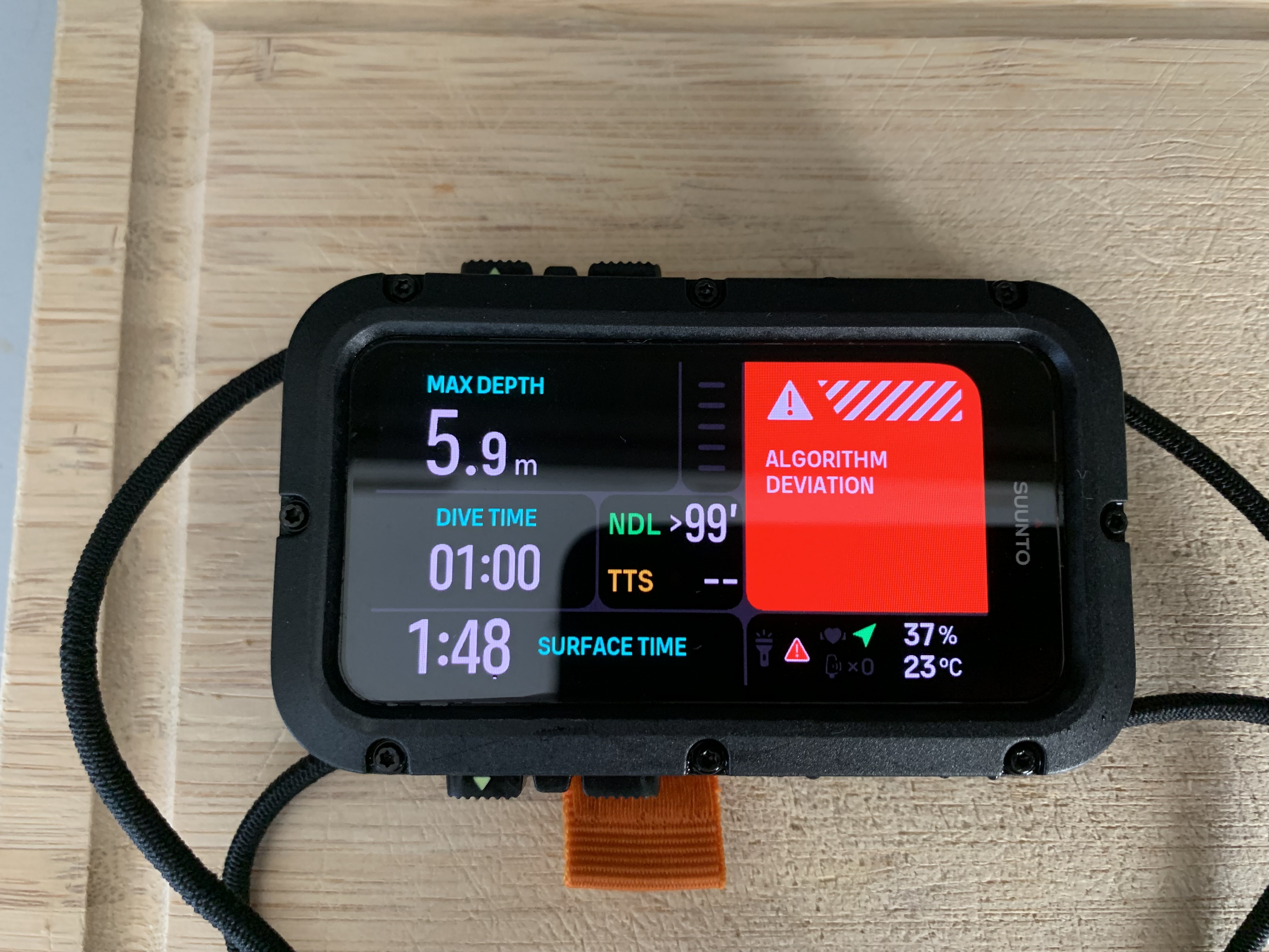

                I had the same issue today: dive logged as 0 minutes, 0 meters depth. On top of that, I got an algorithm deviation warning.
                My theory is that the logged dive didn’t match what the algorithm had actually calculated internally, which triggered the deviation warning (but this is what i speculate).
                It seems impossible that my dive itself caused a deviation, because it was no deeper than 5 meters, with an average depth of 2.5 meters, for 1 hour. No rapid ascents or anything unusual.
                I’ve had this computer for 3 months now, 42 dives so far. This is the first time I’ve encountered this issue. Not exactly reassuring when it comes to trusting this computer underwater.
                Is Suunto aware of these issues?
