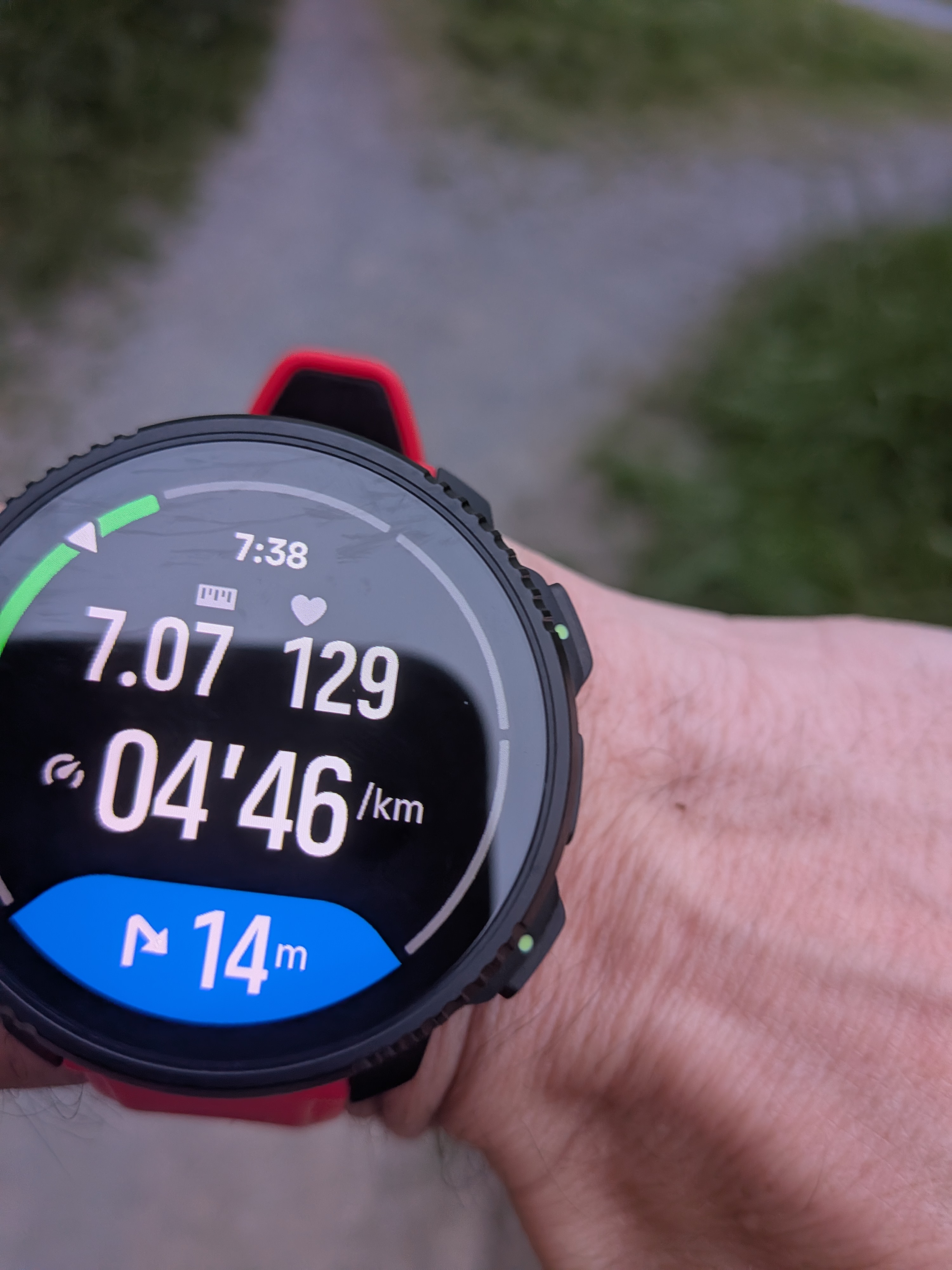

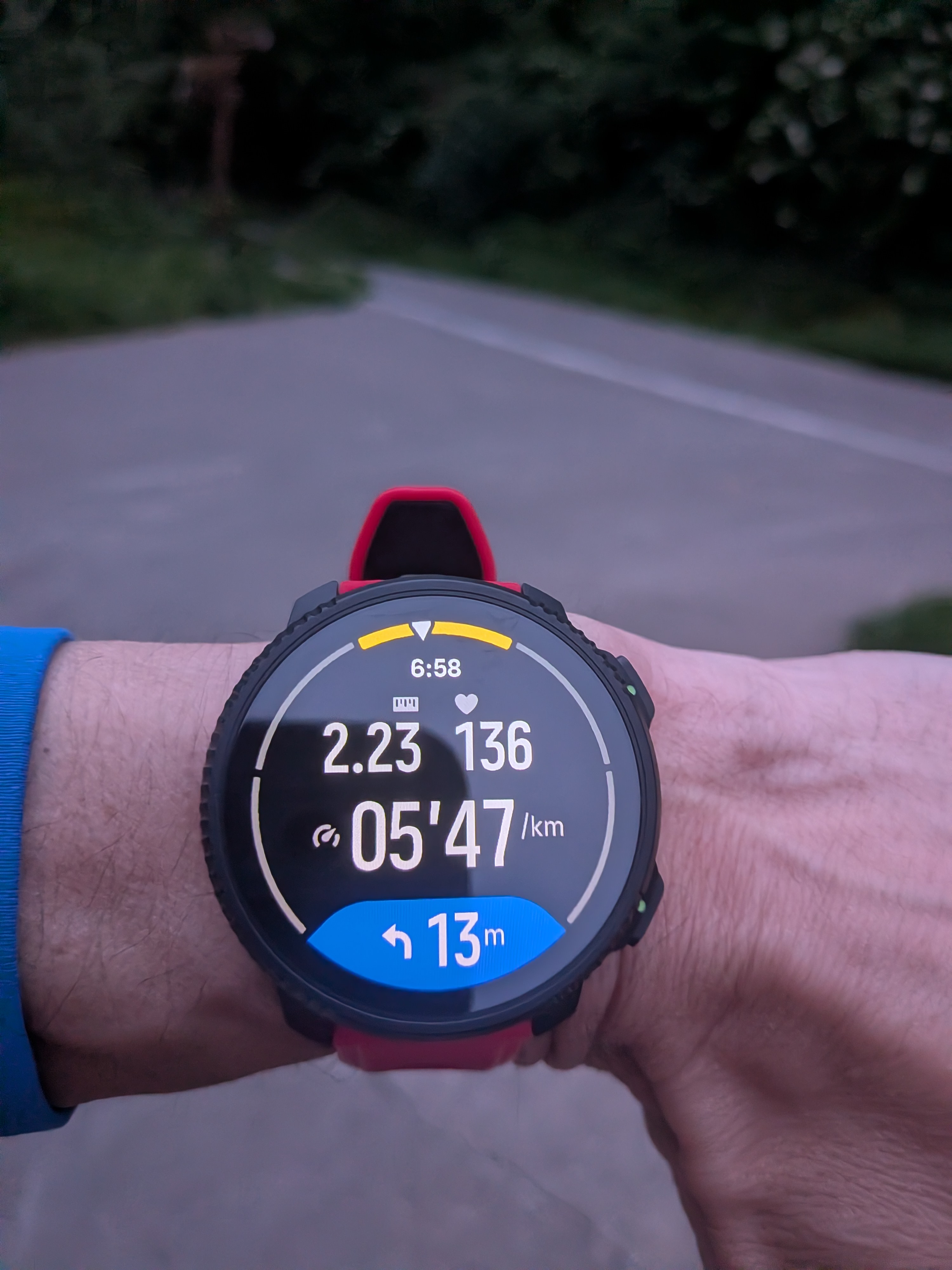

      Today, I repeated the whole track.
      A shot inside a turn:
      Another one:
      The offset issue is there all time. Worst thing seems this is caused by Komoot, not Suunto. And basically Komoot’s algorythms are not as strong as other’s (which is bad for Suunto).

                                I tested the Run using the route created with Komoot’s algorythms. That’s the key of my post (no matter if I was using the Run or my Vertical 2 Titanium, since I used Komoot’s algorythms for creating the GPX with TBT indications).
                                About the issue, you are right. It seems created by Komoot and it happens in both my Vertical 2 and my wife’s Run. It’s very clear Joaquin. In fact, Komoot’s support confirmed the offset is created by them.
                                There are also several things I was talking , like missing the final part in that route because Komoot’s issue or wrong Climb notifications because Komoot does a pre/post-processing of the routes, affecting the performance of the navigation to several things.
                                But if you want TBT in a route that is already created (I.E, a GPX track provided by a race organization) , at this moment. you need to use Komoot.
                                In my opinion, now you have a super nice tool like Route Planner, I’d be incredible nice if all the algorythms are made by Suunto instead of using Komoot’s.
