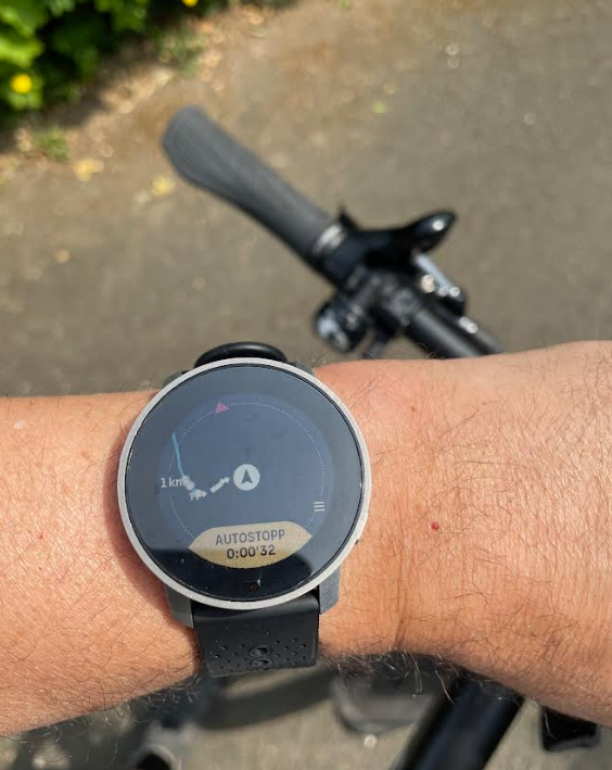

                  Have been on a long biketour last weekend and went of route several times.
                  As far as I can remember it was pretty straight forward as you could see the breadcrumb your on and the planed route aside. This is a 9PP, so no maps. Didn’t have to zoom out, so I guess it has been zoomed automatically but will re-check later.
                  As for direction, this depends on how you turn the watch, an arrow would be great of course but you can find the direction by turning the watch.
                  Sometimes it happened when you get back on track, that it is guiding you in the wrong direction - even while planned in the other direction. Did check on the app and watch but it seems to send you back sometimes to the latest waypoint. As soon as you ride in the correct direction it fixes this again.
                  My biggest wish for navigation is speech output, next left, now left and so on. I often ride with headset and it works fine with komoot but I don’t wont to waste phone battery.
                  So if the app can tell heartrate and pace it shouldn’t be that hard to tell you directions.
                  Looking at the watch at higher speeds on trails is a bit critical.

                      Okay, did a test ride. On the route screen it zoomed out two 500m, 1km, 5km. Latest software update is installed. The white dots show the breadcrumb the blue line the planned route.
                      If there is no auto zoom on the SRS it seems there is a difference at that point.
                      Should be added to the SRS too.
