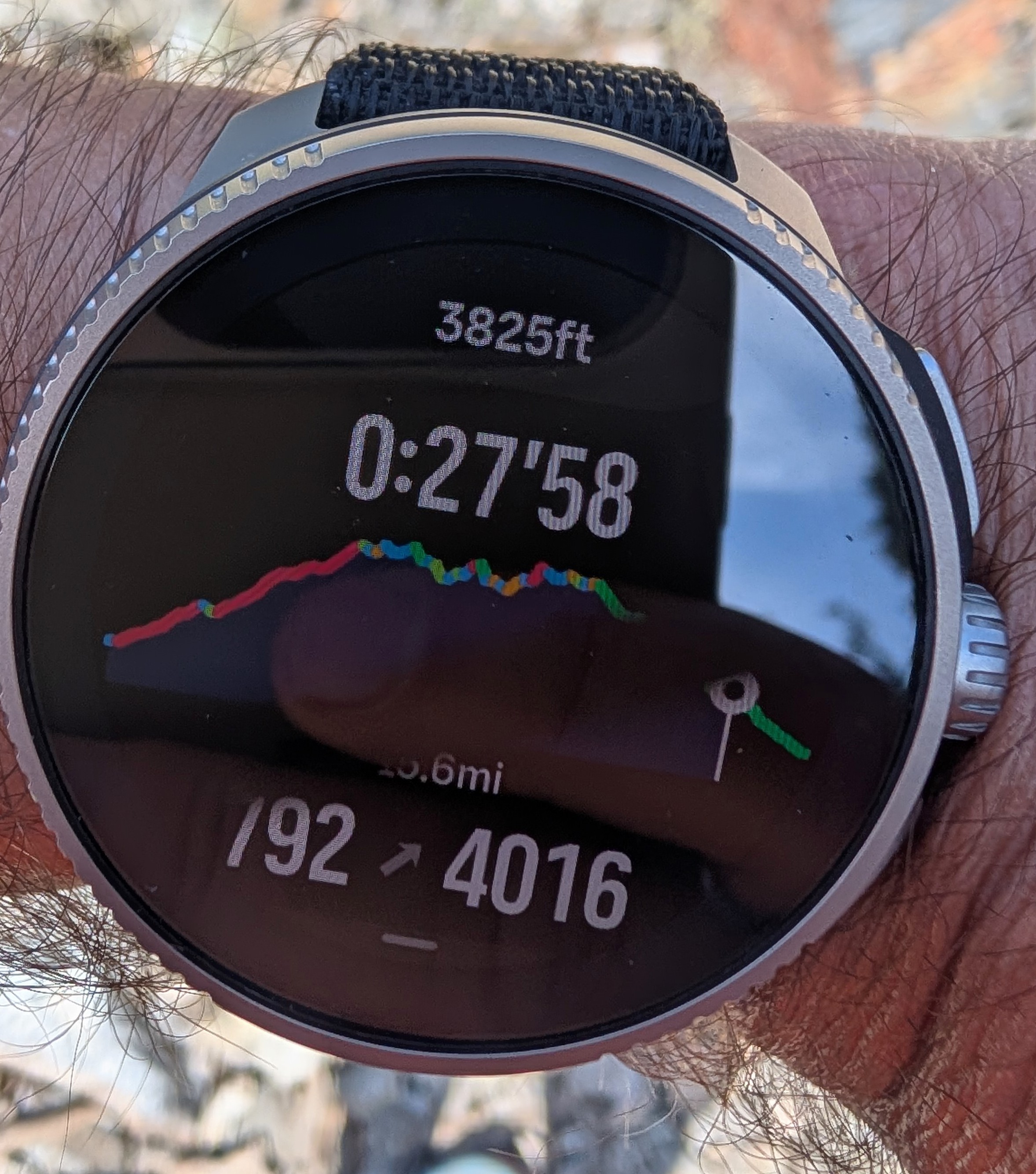

      On a few occasions I noticed a tendency of navigation to inappropriately auto-reverse the route where I wouldn’t really expect it to. Here is one recent example:
      I ran counter-clockwise starting at the point at the top of the watch screen. At some point towards the end I decided to take an alternative trail with an intention to later merge into the original route. You can see the point at the bottom of the screen (above the 0 digit) where I diverged. To my surprise, when I was about to merge back, the light blue directional arrow appeared on the map, and it pointed me away from the end (down on this screenshot) of the route as if the route reversed at that point. The problem is that with the map zoomed in it wasn’t obvious which way was towards the end. I decided to stop and double check the map because this seemed wrong.
      To make this even more misleading, the distance field at the bottom shows the distance along the original direction, not the one that corresponds to the light blue part. So it made me believe that it was only 1.4 miles to the end, but have I followed the light blue directional arrows, it would end up being a much longer way. At minimum, the distance must always be consistent with the direction guidance.
      I think route auto-reversing is potentially a good feature, but it should be activated only if I already run on the route in the opposite direction for some distance, meaning I know what I am doing. It cannot just decide to flip the direction when I go off-route for whatever reason. In this case I didn’t run any distance in the opposite direction, so it definitely should have preserved the original route direction. What it did was misleading and borderline dangerous! Imagine someone who has ran out of water being sent on a long detour away from safety of their car. I should add that this isn’t the first time this happened. I’ve definitely seen this issue in the past.
      If I could further improve this feature, it would be nice to keep seeing light blue directional arrows even when I am off-route - on the part of the route that it closest to me. That way, if I zoomed out I’d still see not only where the original route is but also which way it goes. That would give me a better idea how to merge back.
      Note to mods or beta testers: could anyone please mention this issue to the development team.

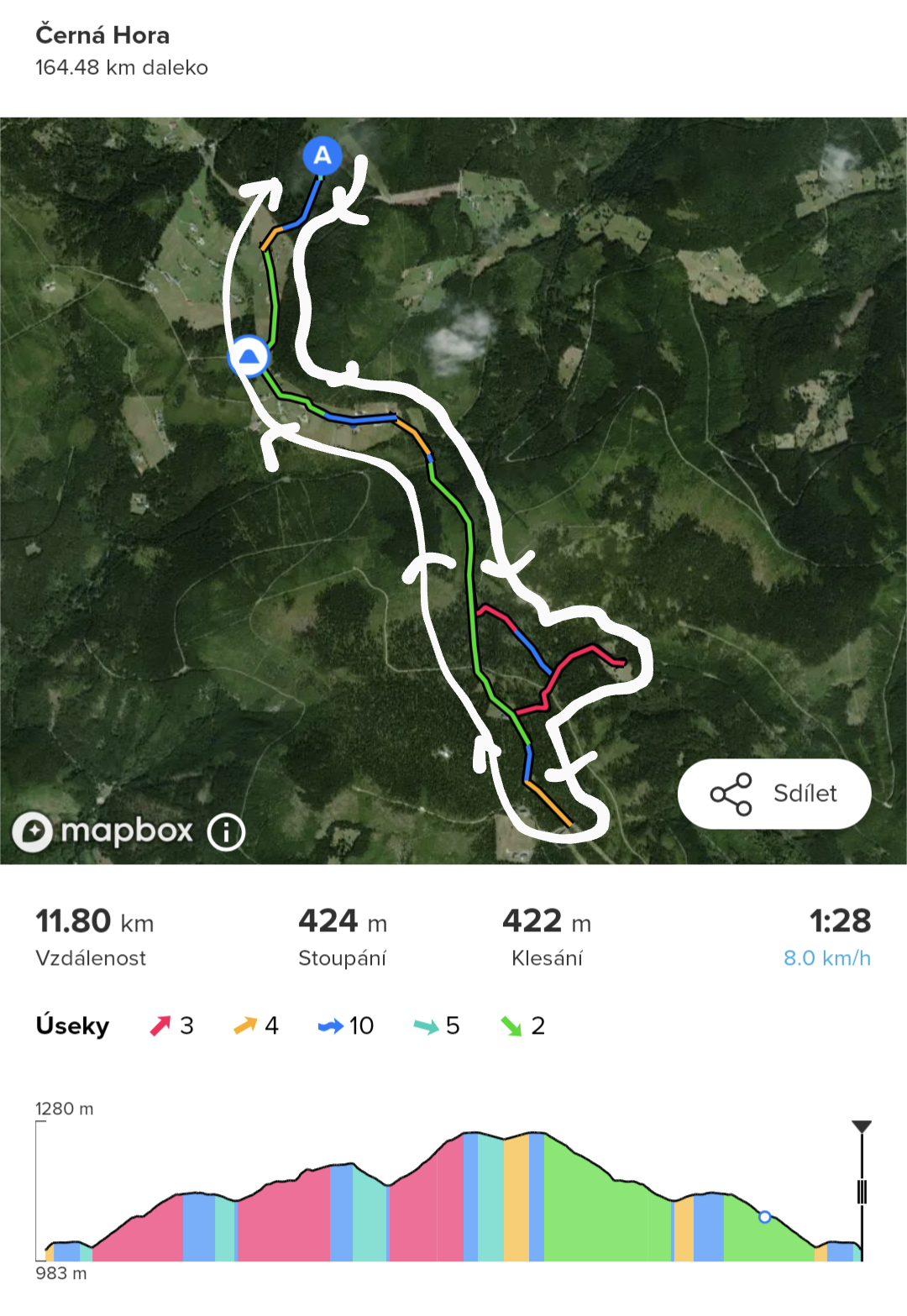

                I had exactly same problem few weeks ago. It’s annoying. My route was same for there and back with loop between. I started the activity and after few meters I got “you’re in finish” alert. Whyyyy? So stupid bug, if the watch know already walked distance… The map was OK, but the line on elevation profile was showing from the end to the start 😁. Everything else seems fine, ETA, ETE… I returned Fenix 7Pro because of bugs, but the Race starts to surprise me a lot with these bugs.
                Suunto Vertical 2

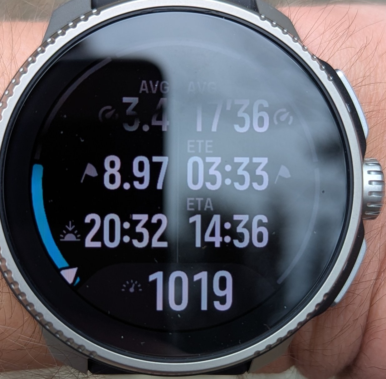

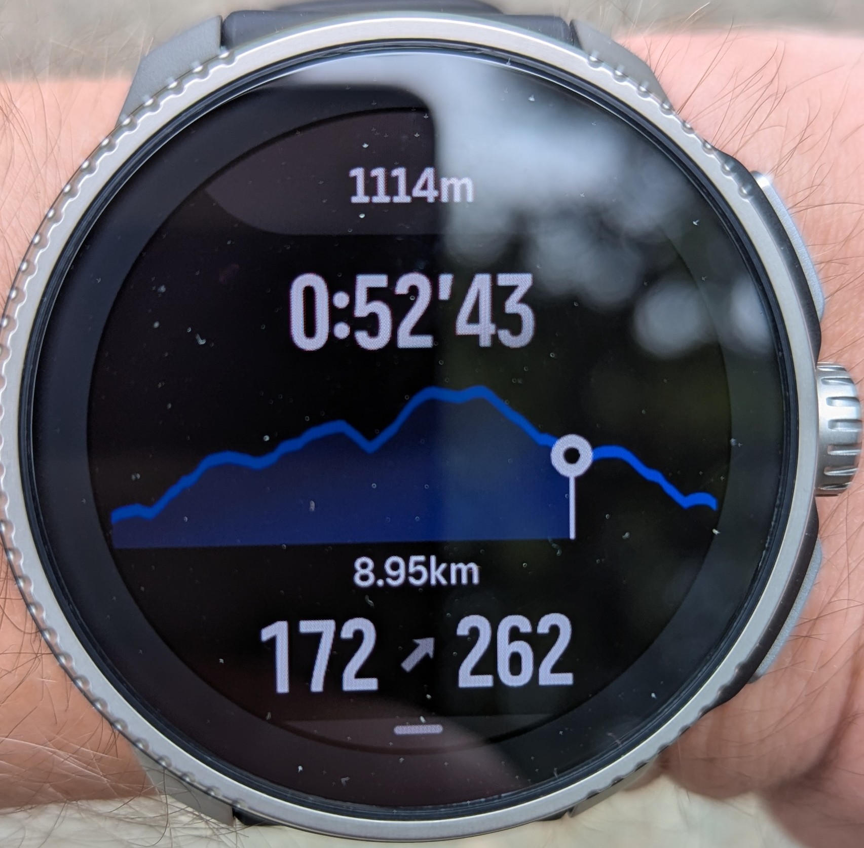

                  I’ve hit this issue of auto-reversing the route on today’s run right from the beginning. I started with a slightly different parking slot than planned and merged into the route about 0.2 mile from the beginning. Somehow the watch decided to reverse the route, so it basically started from the end of the out-and-back route and went through it backwards. That would be OK, except the elevation profile started like this (see below) and was moving backwards (right to left) the entire run.
                  In my opinion, this is not working as it should. I never run on this route in the opposite direction during this run. We’ll technically I did - you can say that because it was an out-and-back route, but what this watch did was just unreasonably stupid! Just because I was off-route for a very brief moment at the start before merging into the route, that isn’t a good reason to reverse the route and have a very confusing elevation profile.
                  A similar issue happened a week ago too. In that case the route was slightly wrong and I turned around a very short distance before reaching the turn-around point in the route, but otherwise I followed the route correctly. After I turned around, instead of skipping a short distance forward and continue on the route, the watch decided to reverse the route. As in this week’s case, the elevation profile started to move backwards. This has to be fixed!
                  Has this issue been reported to Suunto development team?

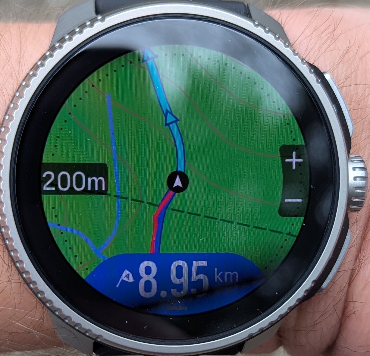

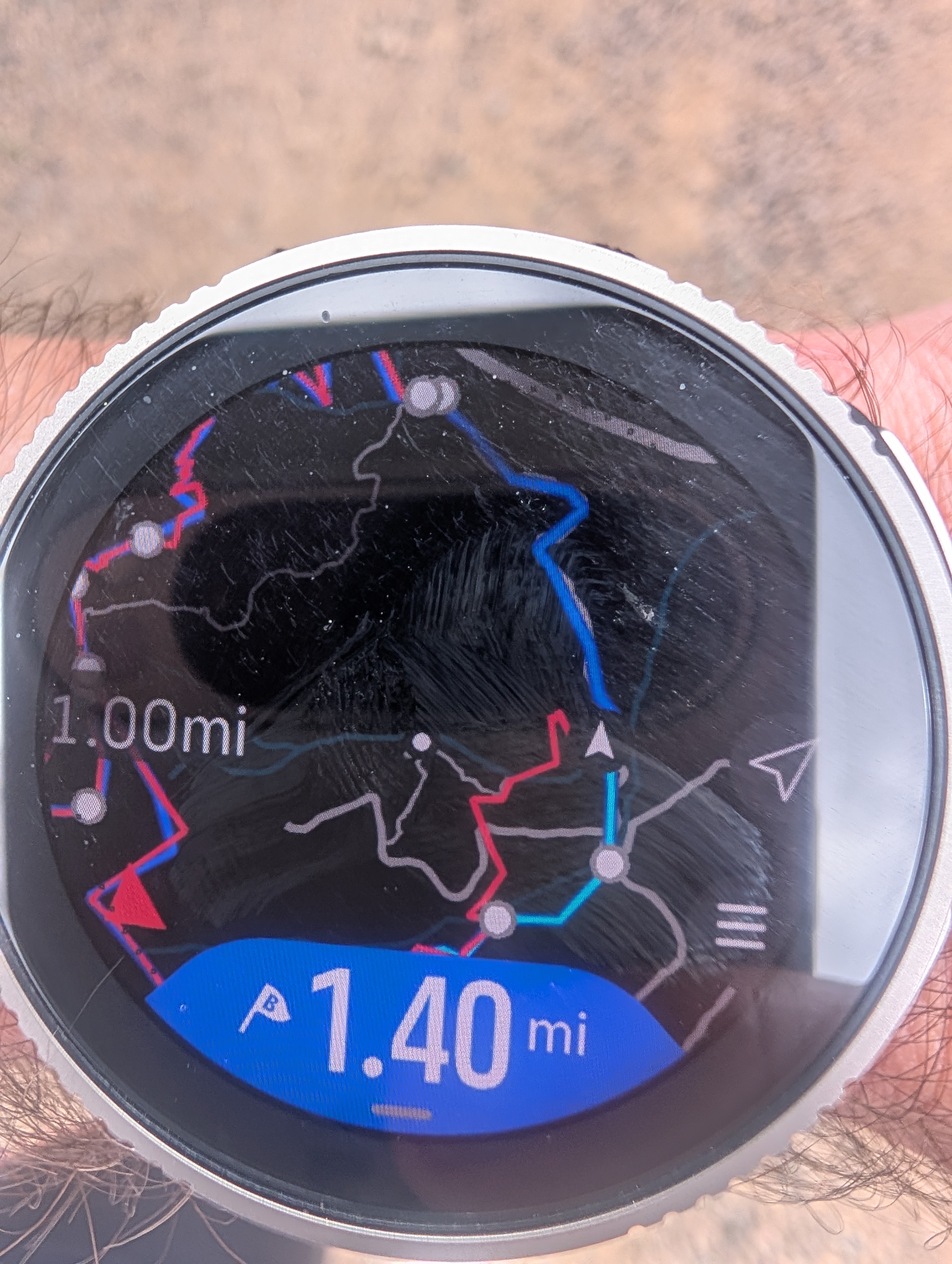

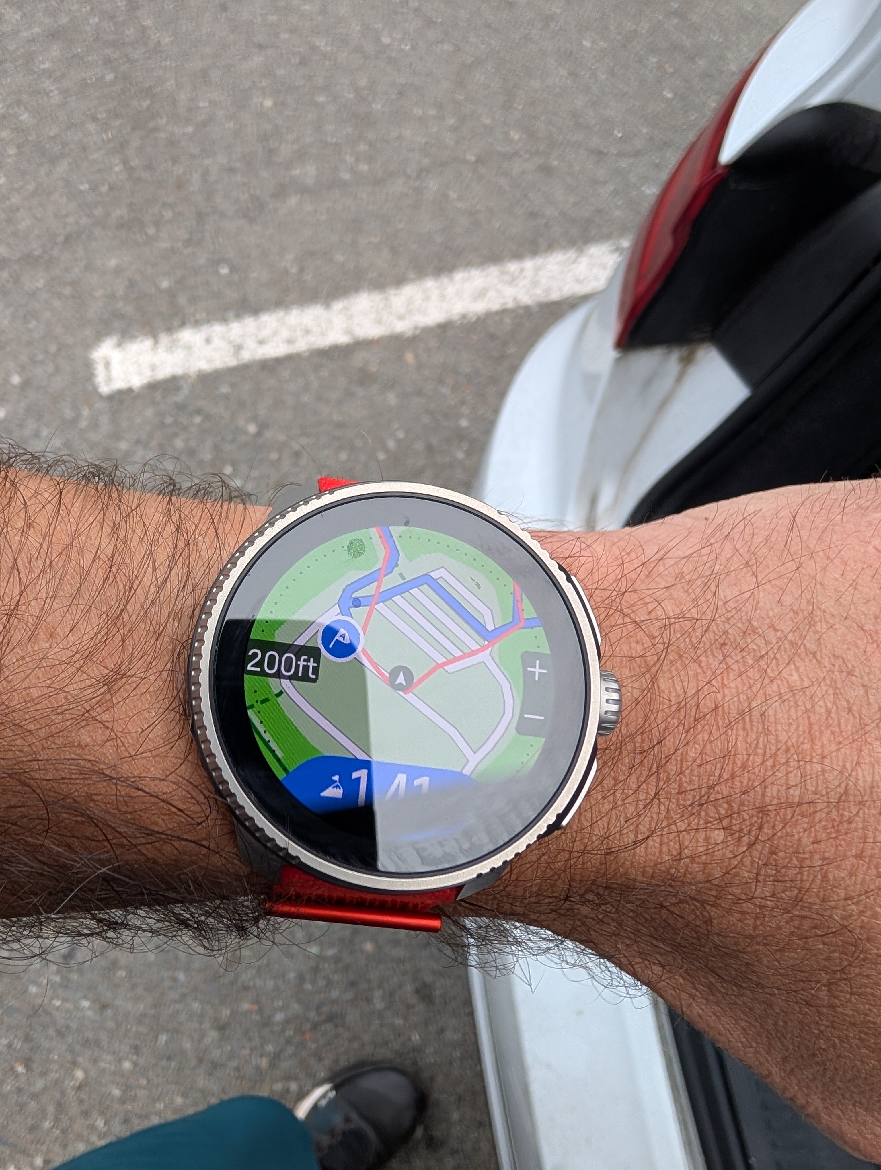

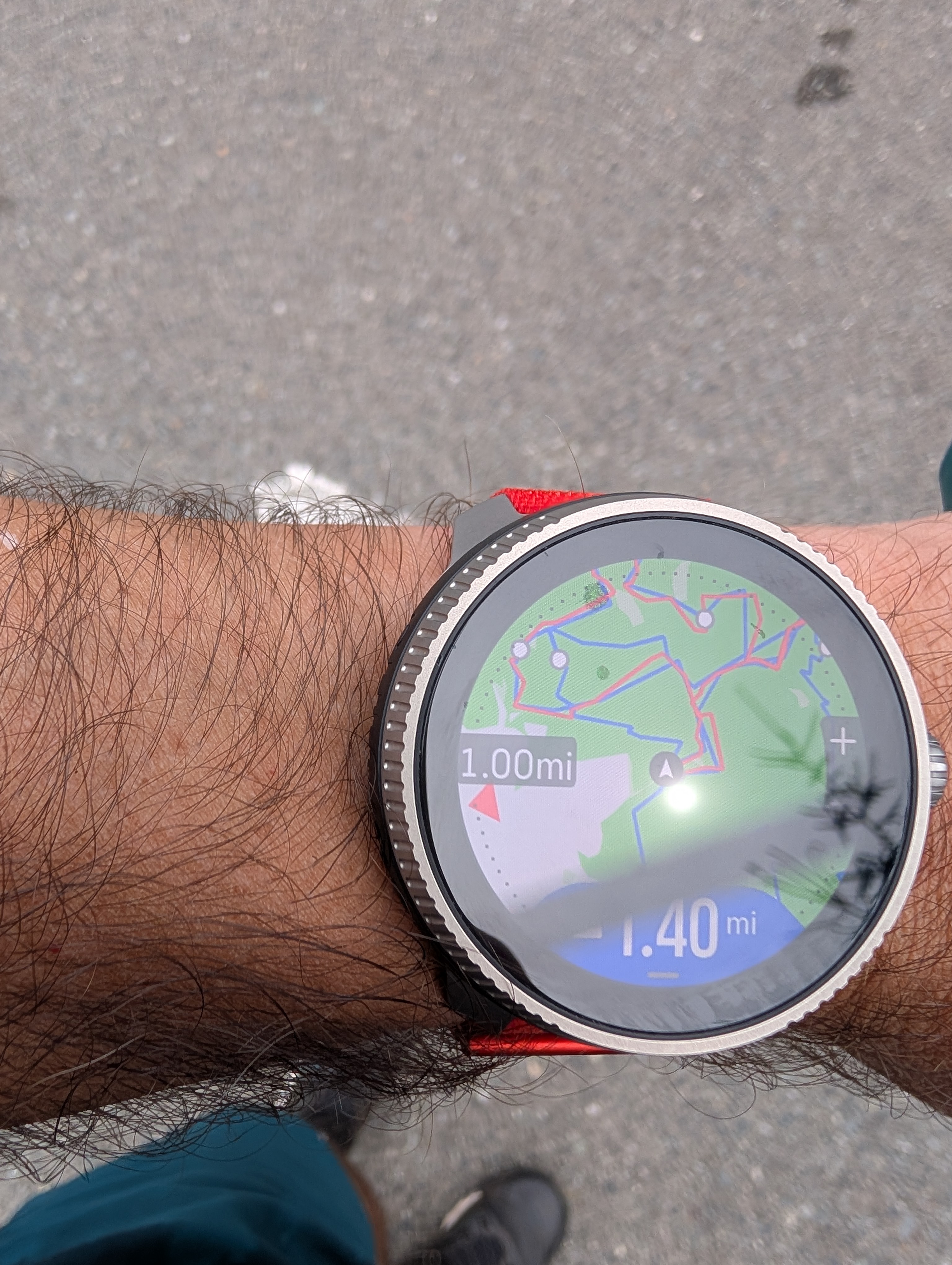

                                      I’ve run into this (or similar) issue again on my most recent run.
                                      The run was planned as two different 10 mile loops with resupply at the parked car in the middle of the route. You can see the route here: https://www.strava.com/routes/3323592908981584098
                                      When I arrived at the car at the end of the first loop, I noticed that the light blue directional arrow was no longer showing, so I wasn’t sure exactly where to go next.
                                      Here is what the map showed at 200ft zoom level:
                                      And here is the same spot on the map at 1mi zoom level:
                                      As you can see I was just slightly off the route because of how my car was parked - perhaps the furthest I went off the route was about 40 meters, which I think is well within the tolerance of the “OFF ROUTE” condition. In fact, the “OFF ROUTE” warning had never come up and you can see that it still correctly shows distance to the next waypoint. However, there was no directional arrow when I needed it the most.
                                      Shortly after this, as I was leaving that spot, the route had reversed, and it started to show the direction arrow pointing away from where I originally planned to go. I think that happened when I was exactly on the route.
                                      From other discussion, @Joaquin said that the route reversal should only happen when we already go in the opposite direction for 200 meters, but that was clearly not the case here. I think this is the bug and it doesn’t work as intended. Please, if the Suunto team is not aware of this issue, let them know.

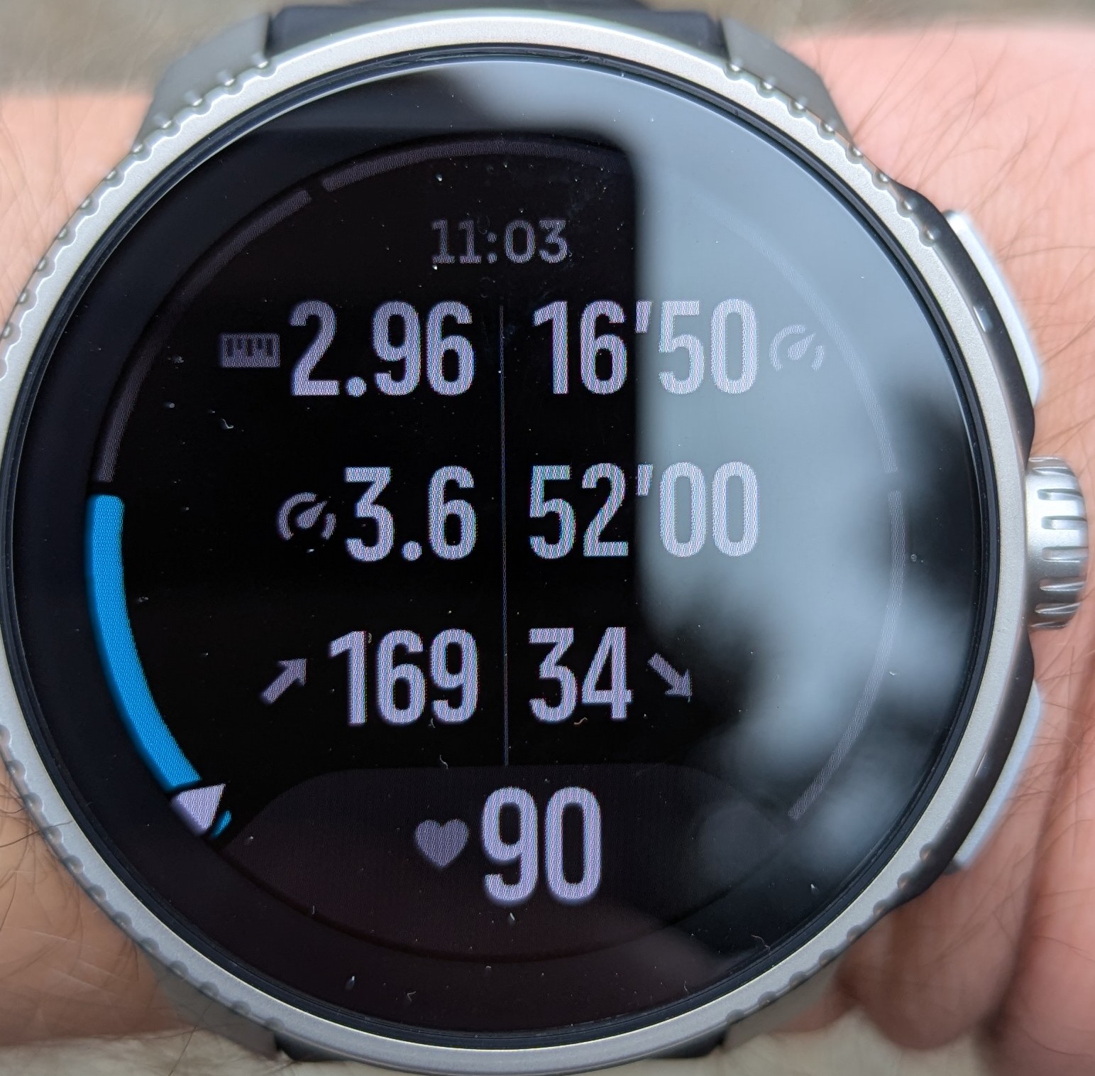

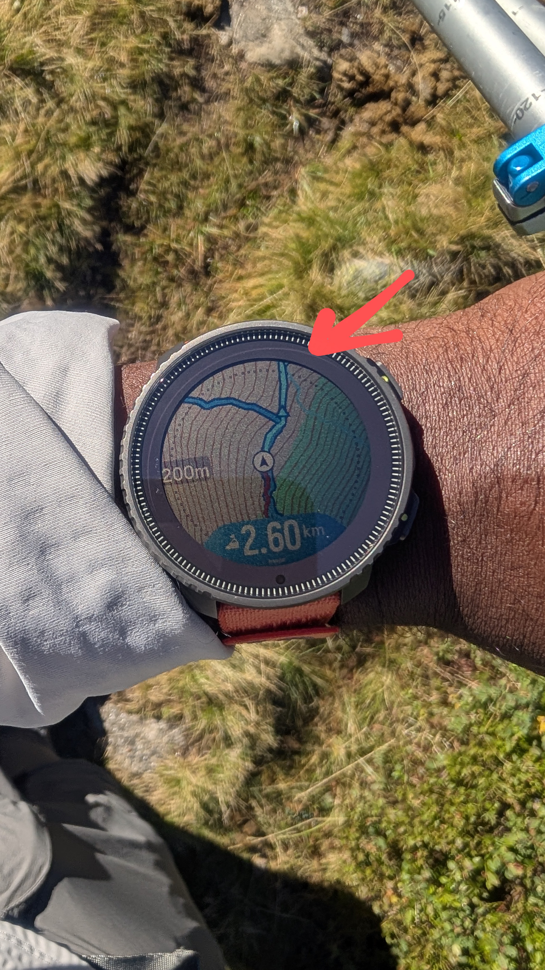

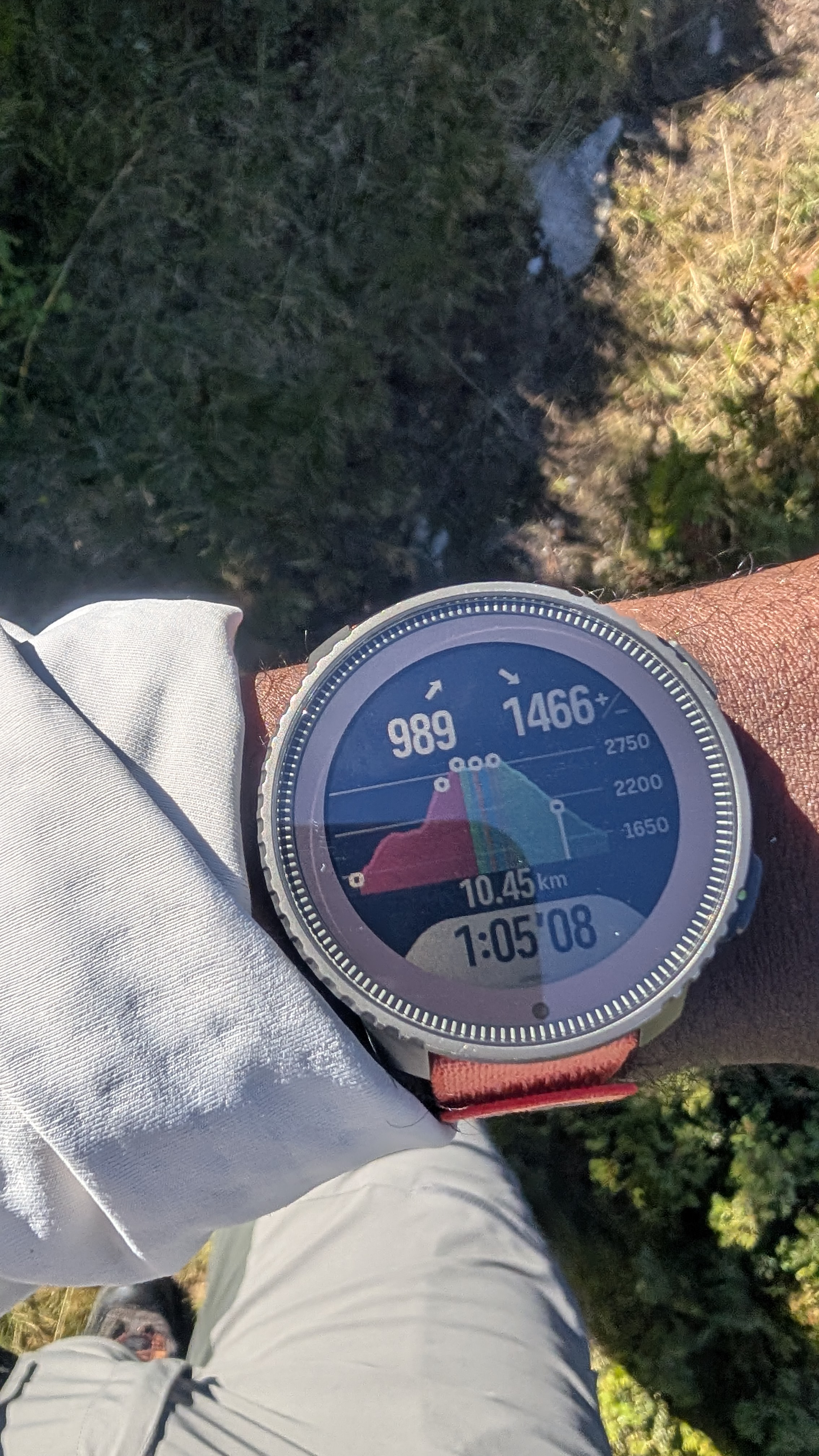

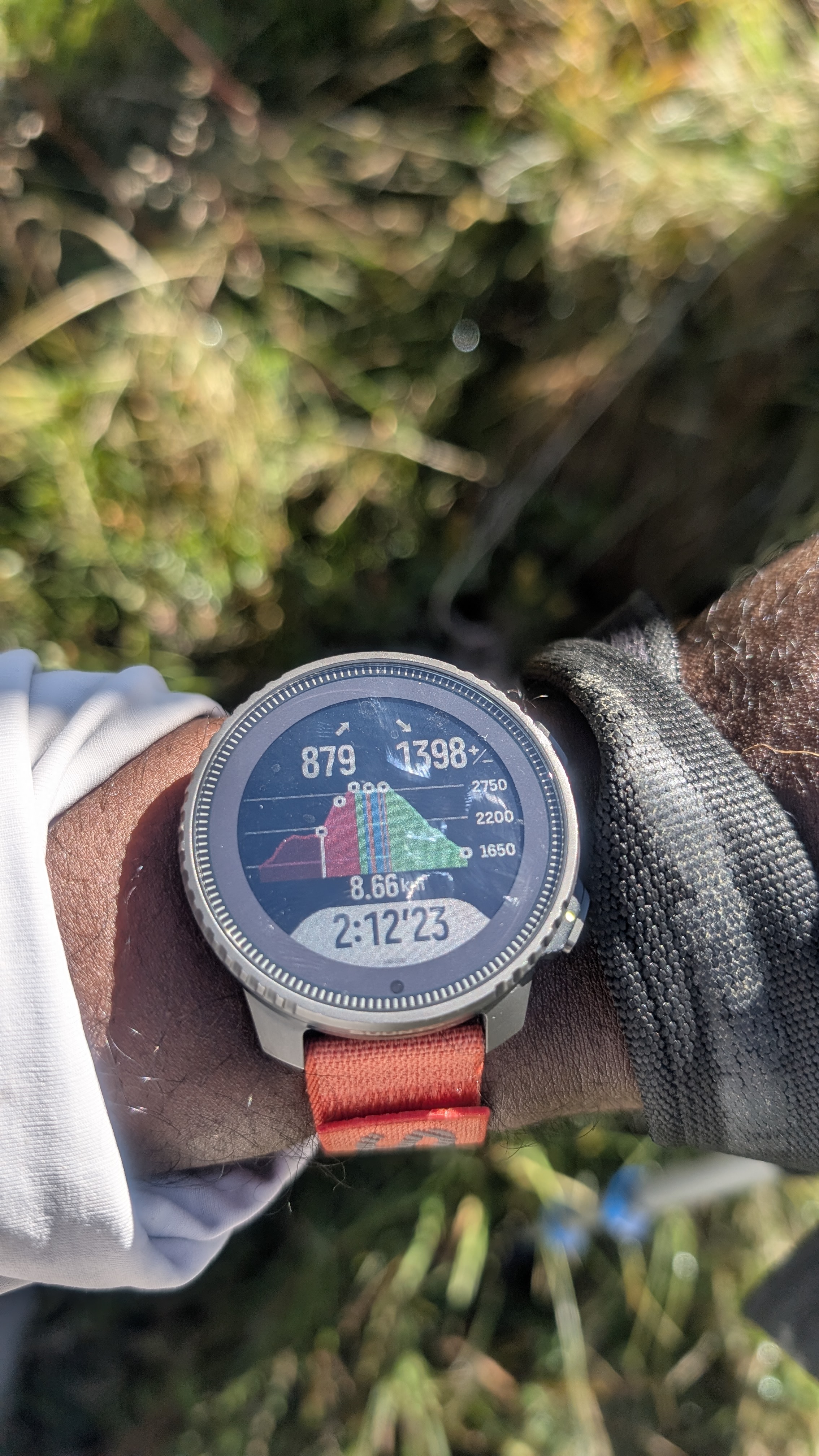

                                        @sky-runner I had the similar issue this weekend.
                                        I was at the beginning of the route but on Climb guidance view I was at the end of the route. Impossible between way point.
                                        This issue happened at the begging only when my route back was the similar.
                                        Few minutes after it was fixed once i use a single route (right route.
