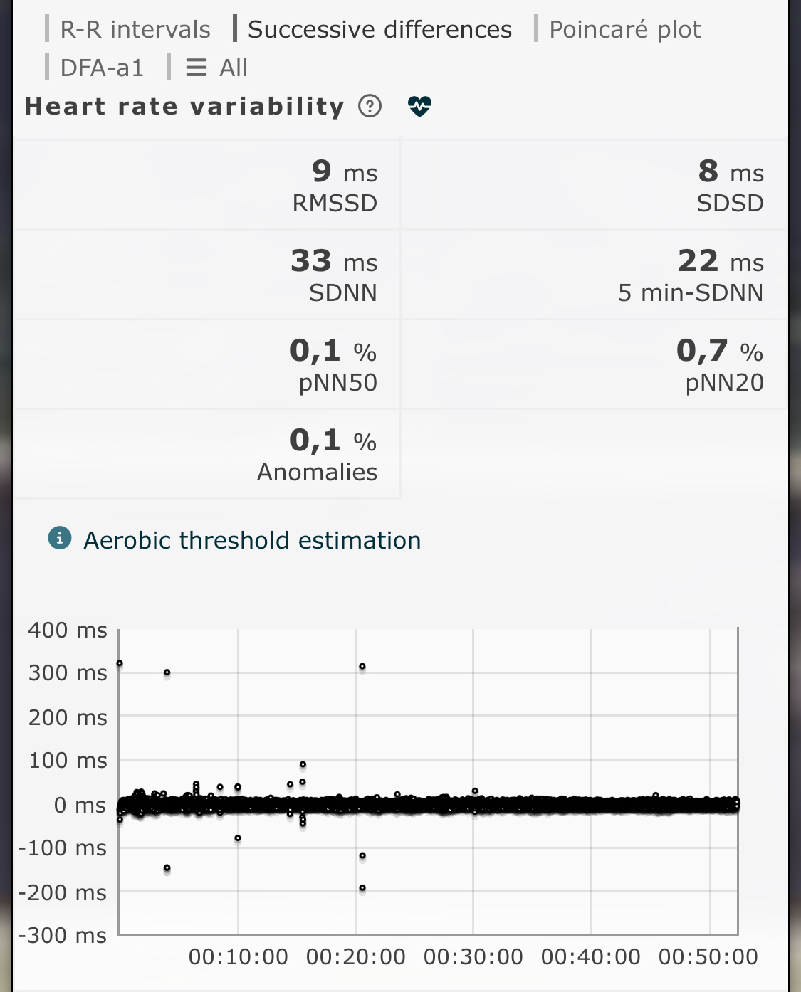

                                  You need to look at the r-r data in Runalyze, not the HR graph. It will show you plots (and tabulated statistics) of the data. Like this in the “successive differences” plot:
                                  The r-r values should cluster together and the anomalies % in the table should be very low. The most likely cause of your bad data is a belt problem and this will show with widely scattered r-r data and a high % anomalies. As @soisan has explained apps (Suunto, Strava, Runalyze etc etc) will apply filters to the r-r data to try to remove anomalies and derive realistic HR values when processing the fit file.
                                  I suggest only considering a problem with your watch after you’ve verified the quality of data from your belt (by reviewing the r-r data).

                                        @Ian-Beveridge Post the R-R data graph from Runalyze as @MKPotts did. I would bet yours is very bad. If poor, this is why your ZS data is not parsed to the app. From the HR traces on your watch something looks off. Just saw your last post, if no R-R data is in Runalyze then there is clearly something wrong with the belt and not the watch. Are you using the Suunto Run. Here is an image from my last exercise using the Suunto Smartsensor belt with Suunto Run. I was doing an interval workout 4x3 min hard so I expected my AT to be off, LT was good.
