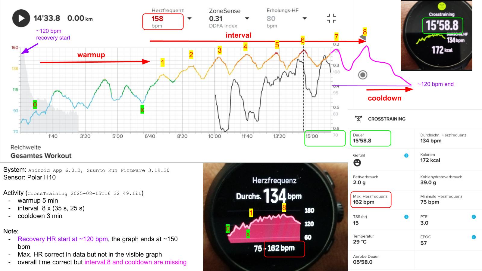

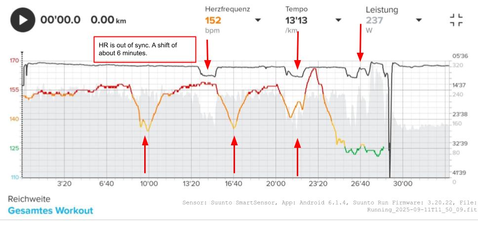

      Today I recorded a short interval workout with the Polar H10 on the Suunto Run. The HR graph on the watch seems to be correct, but the app shows something different. The last interval and the 3-minute cooldown are missing. But the time is correct😕
      Note: Android App 6.0.2, Suunto Run Firmware 3.19.20

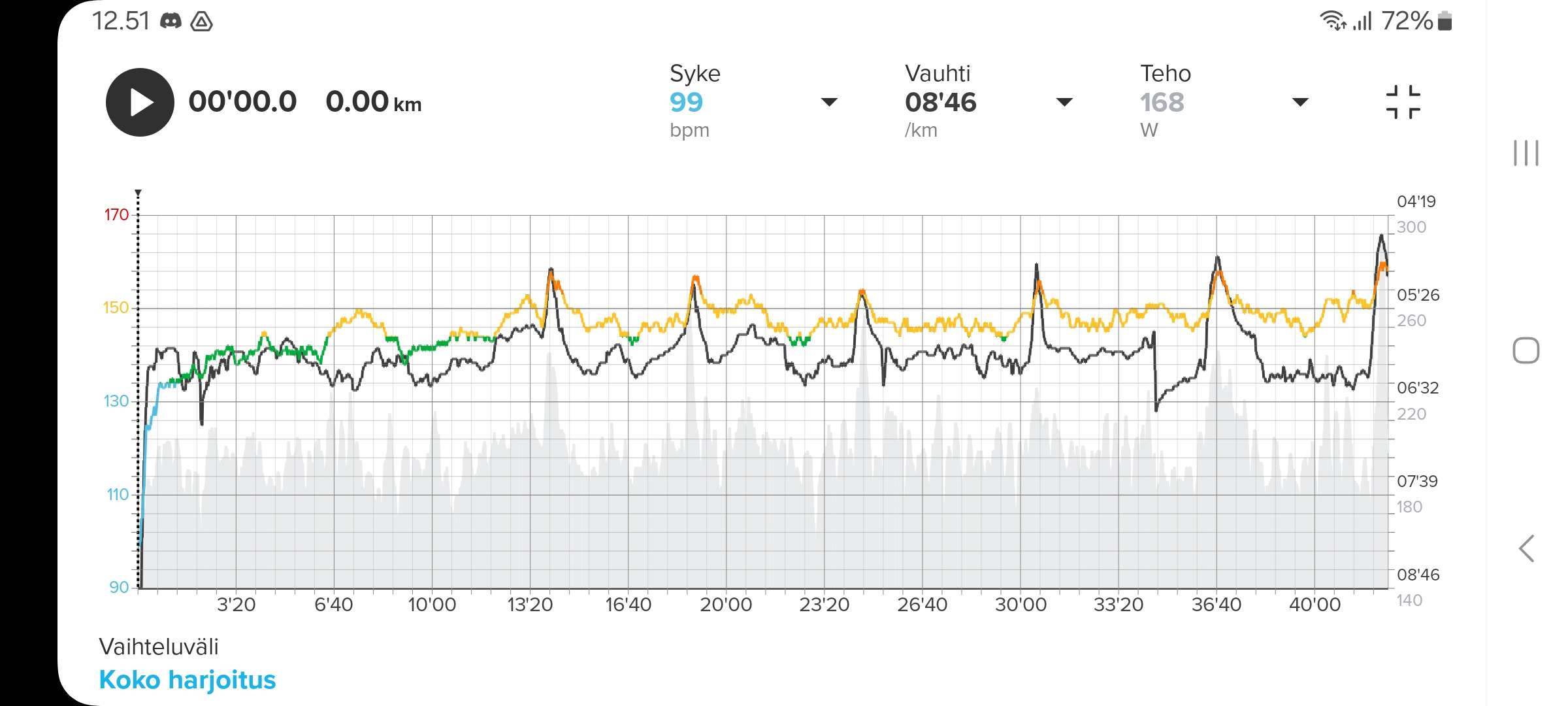

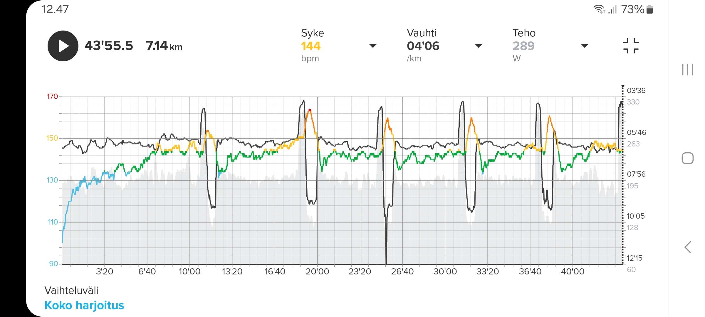

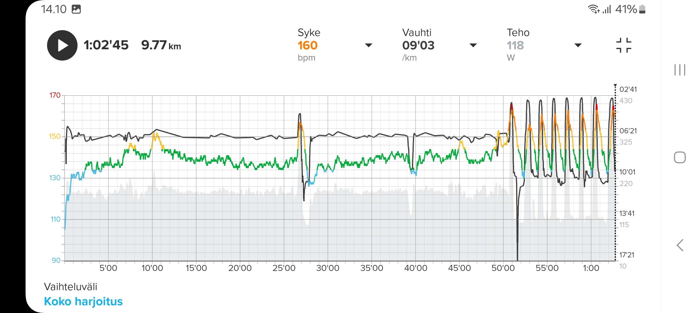

              Patch 3.20.22 massively improved the situation, but there’s still a gap between pace and HR that widens over time.
              A run with strides with H10:
              A run without the strap:
              Yves_Y 1 Reply Last reply Reply Quote 1

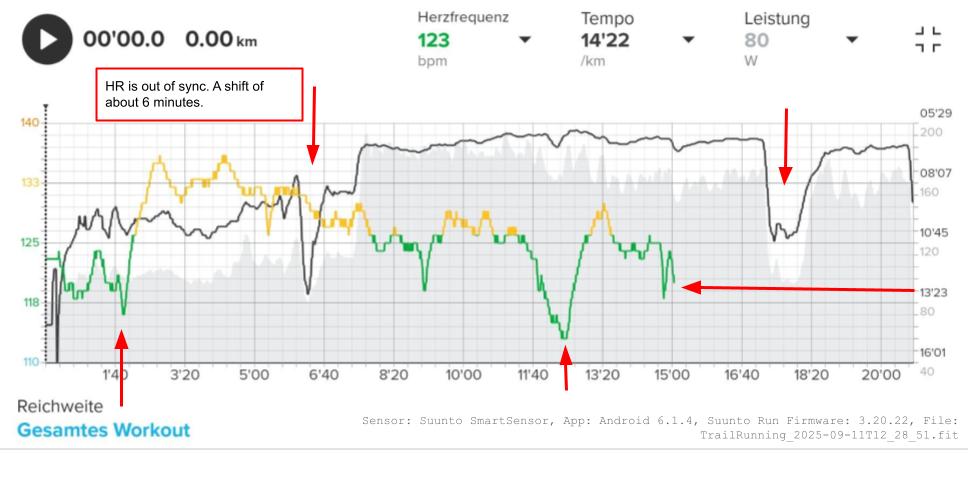

                    Again today, during two short training sessions. This time with the Suunto SmartSensor:
                    Running_2025-09-11T11_50_09.fit
                    and immediately afterward, another activity
                    TrailRunning_2025-09-11T12_28_51.fit
                    Something is definitely out of sync here. I’ll try the Polar Verity Sense next time, but I think it happens with any sensor. It’s happening more frequently now. Before last update, I had the discrepancies in maybe one out of every four training sessions; now, it’s happening in about two out of three.

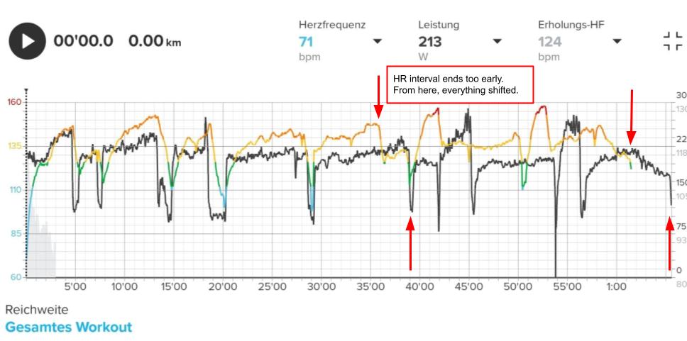

                              Another day with multiple workouts (Polar H10):
                              • Walking (correct)
                              • Trailrunning (0:51 - deviation ~5 min)
                              • Hiking (1:40 - deviation ~15 min)
                              • Walking (correct)
                              Yesterday with the Polar Verity Sense:
                              • Walking (correct)
                              • Running (1:15 correct)
                              • Trailrunning (0:45 correct)
                              ℹ With the Polar Verity Sense it always seems to work. Whether the ZoneSense calculation has anything to do with it🤔

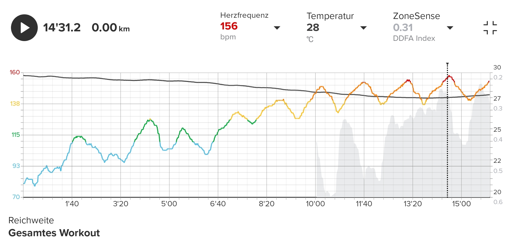

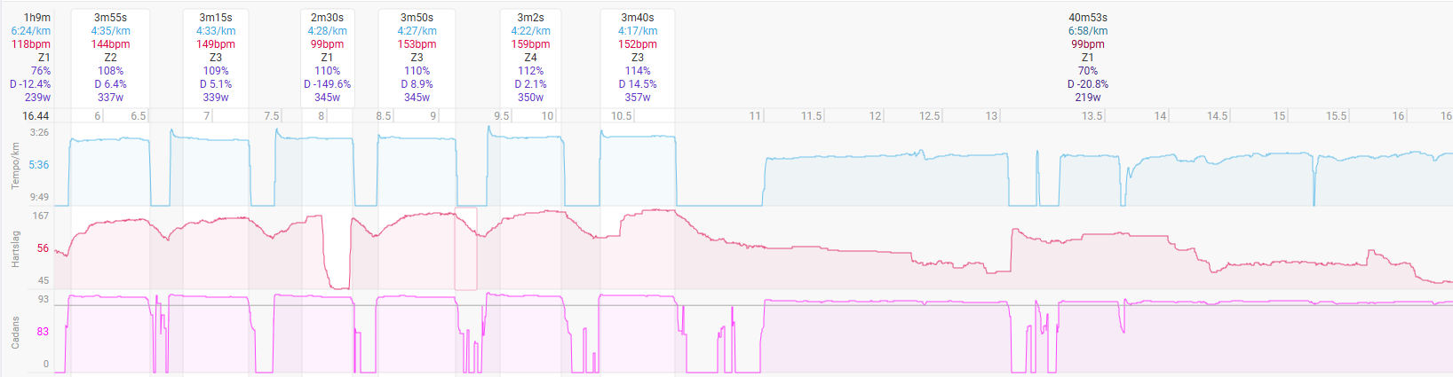

                                After the latest update, I’ve also regularly noticed a strange discrepancy in the heart rate display on my watch.
                                Sometimes it freezes and only shows a much too high or low heart rate.
                                The graphs also show a delay or a completely unrealistic heart rate.
                                I’ve turned off zonence, but that doesn’t make any difference.
                                I have a Polar H10.
                                Yves_Y 1 Reply Last reply Reply Quote 0

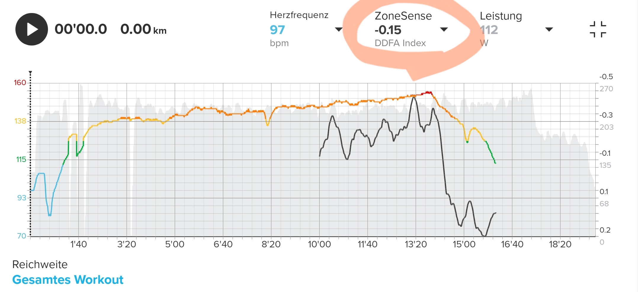

                                  How do I turn off ZoneSense?
                                  That also looks strange. What software are you using to display the data?
                                  JacobusJ 1 Reply Last reply Reply Quote 0

                                    @Yves_ A bit unclear on my part, I turned off the zonesense app.
                                    This is a screenshot of Intervals.icu, by the way.
                                    • Yves_Y Offline
                                      Yves_ @Jacobus
                                      @Jacobus ah, okay😊
                                      I meant this because of the ZoneSense calculation. This is the only obvious difference between the results from the Suunto SmartSensor or the Polar H10 to the Polar Verity Sense. The optical Sensor doesn’t have that.
                                      Although I still don’t understand what is depicted with it🤔

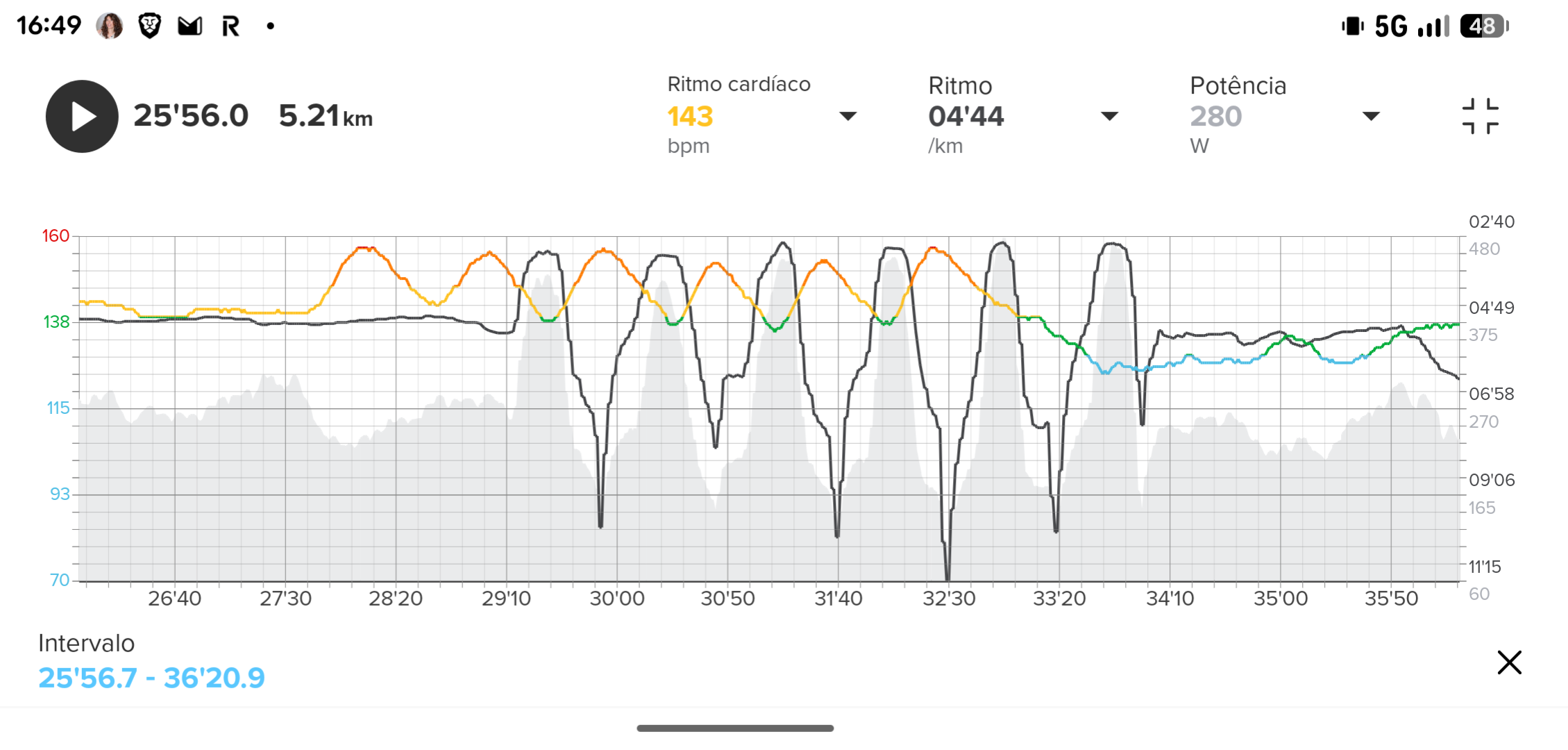

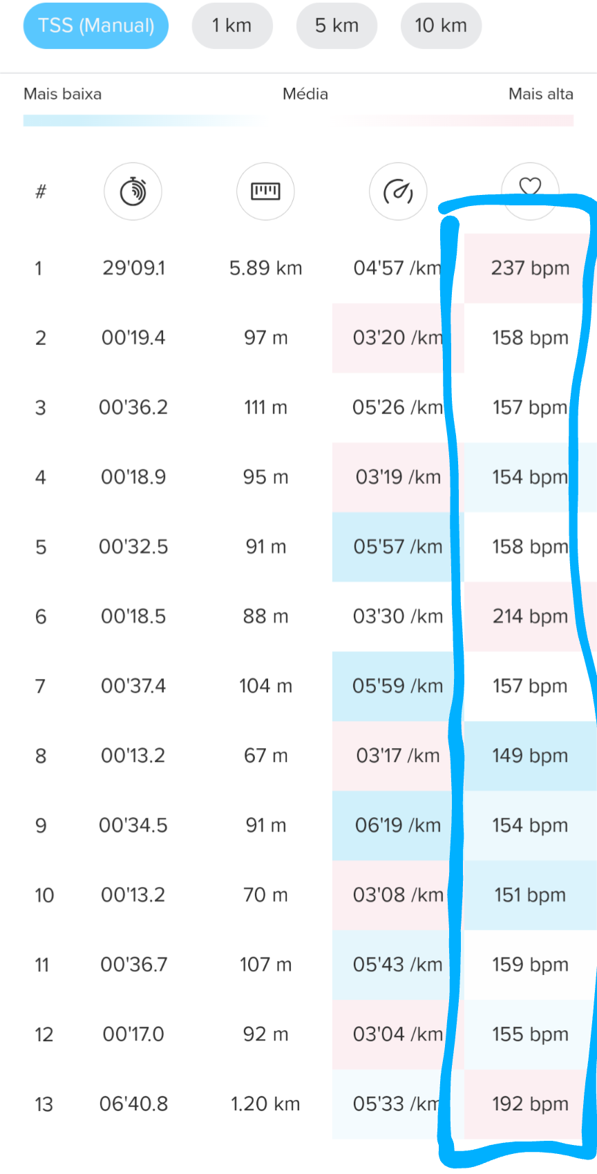

                                            Come in Suunto! How does this issue still remains?
                                            Suunto Run + Suunto Chest Strap is unusable… Constant Bluetooth connection drops, last minutes of HR missing and now out of sync HR.
                                            Also there’s constant peaks of very high HR values that are not seen in the graph but are registered and seen if you choose HR Max in the laps. These are from today’s workout
