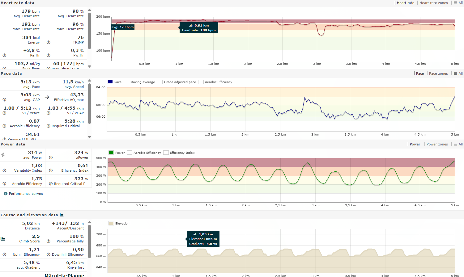

                                Runalyze
                                Thanks for directing me to Runalyze! I uploaded the recorded data for my run today and it actually verifies that the belt is working fine - which I’d expect because it’s only a couple of months old and it’s been behaving extremely well.

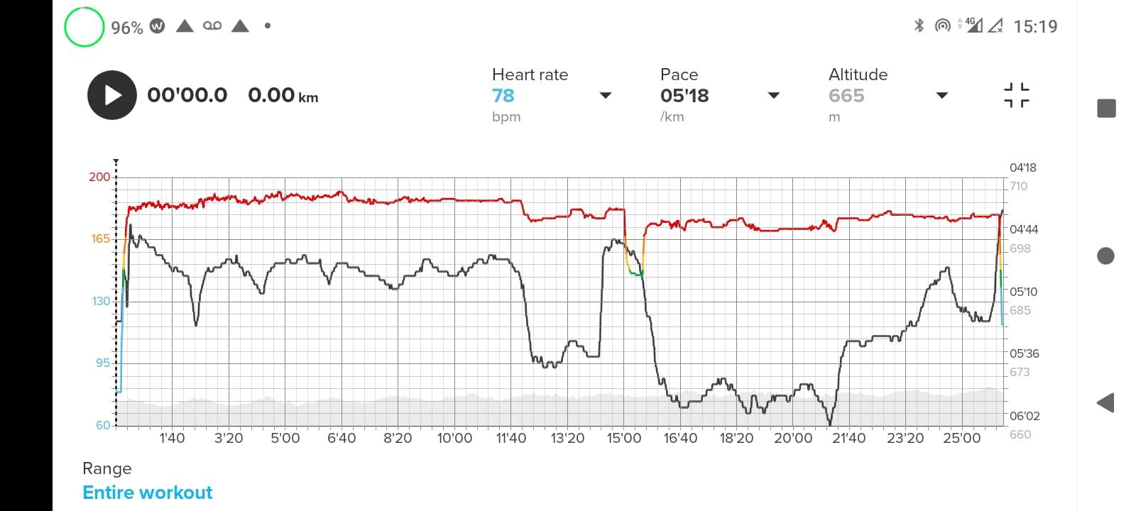

                                From today’s workout -

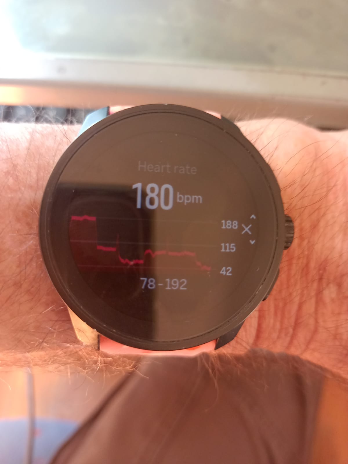

                                1 photo of my Suunto App graph
                                2 screen grab of the Runalyze graph
                                3 photo of the watch graph
                                Despite deselecting ZoneSense the watch graph is completely wrong! It appears to be a clear and obvious bug.
                                The watch give the correct average HR at 180 bpm and the correct min 78 and max 192 - but only the very start of the data shown on the graph is correct - the rest is wildly wrong.
                                D M 2 Replies Last reply Reply Quote 0

                                    You need to look at the r-r data in Runalyze, not the HR graph. It will show you plots (and tabulated statistics) of the data. Like this in the “successive differences” plot:
                                    The r-r values should cluster together and the anomalies % in the table should be very low. The most likely cause of your bad data is a belt problem and this will show with widely scattered r-r data and a high % anomalies. As @soisan has explained apps (Suunto, Strava, Runalyze etc etc) will apply filters to the r-r data to try to remove anomalies and derive realistic HR values when processing the fit file.
                                    I suggest only considering a problem with your watch after you’ve verified the quality of data from your belt (by reviewing the r-r data).
                                    Ian BeveridgeI 1 Reply Last reply Reply Quote 1

                                        @MKPotts I’m not getting “bad data” - it plots correctly in the phone app. There’s a problem with the watch logbook graph display.
                                        As for checking the HRV in Runalyze I’m assuming it would need to be taking it from ZS data - but the watch practically never uploads the ZS data - that’s one of the other problems. I uploaded a fit file from the phone app to look at on Runalyze but it had no HRV data. If the HRV data is just extracted from the raw H10+ belt input then I’m just not seeing how to access it.
                                        Brad_OlwinB M 2 Replies Last reply Reply Quote 0
                                        • Brad_OlwinB Online
                                          Brad_Olwin Moderator @Ian Beveridge
                                          @Ian-Beveridge Post the R-R data graph from Runalyze as @MKPotts did. I would bet yours is very bad. If poor, this is why your ZS data is not parsed to the app. From the HR traces on your watch something looks off. Just saw your last post, if no R-R data is in Runalyze then there is clearly something wrong with the belt and not the watch. Are you using the Suunto Run. Here is an image from my last exercise using the Suunto Smartsensor belt with Suunto Run. I was doing an interval workout 4x3 min hard so I expected my AT to be off, LT was good.
