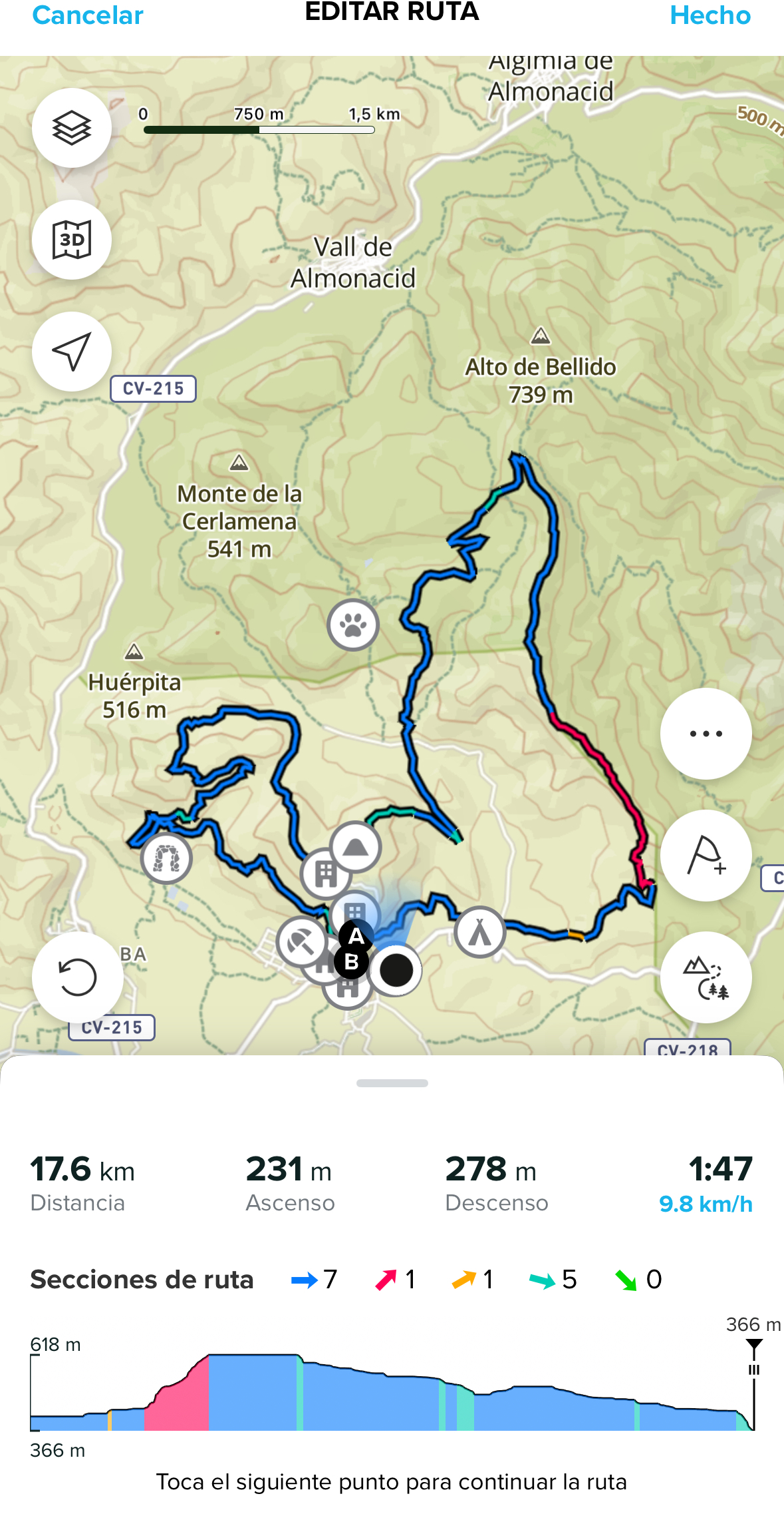

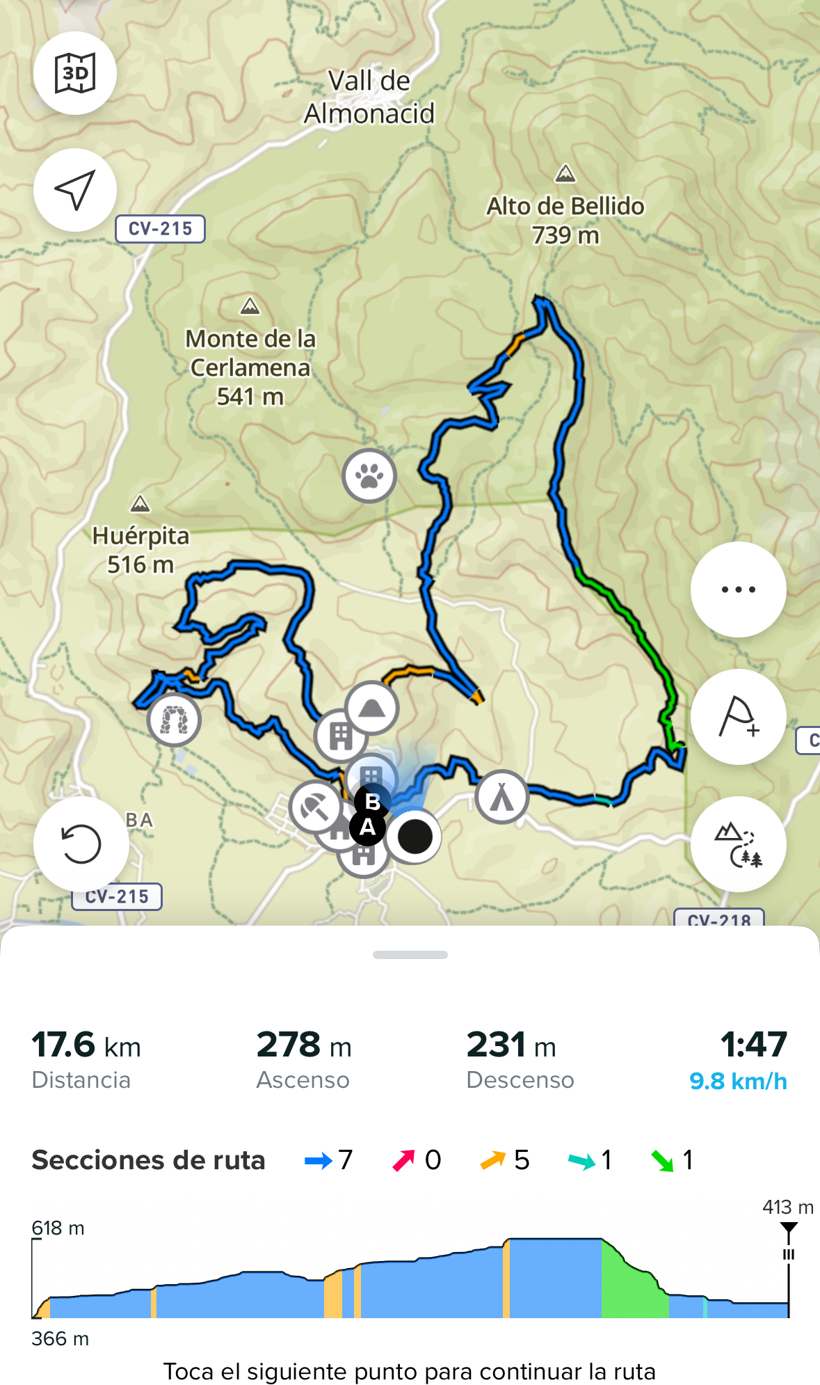

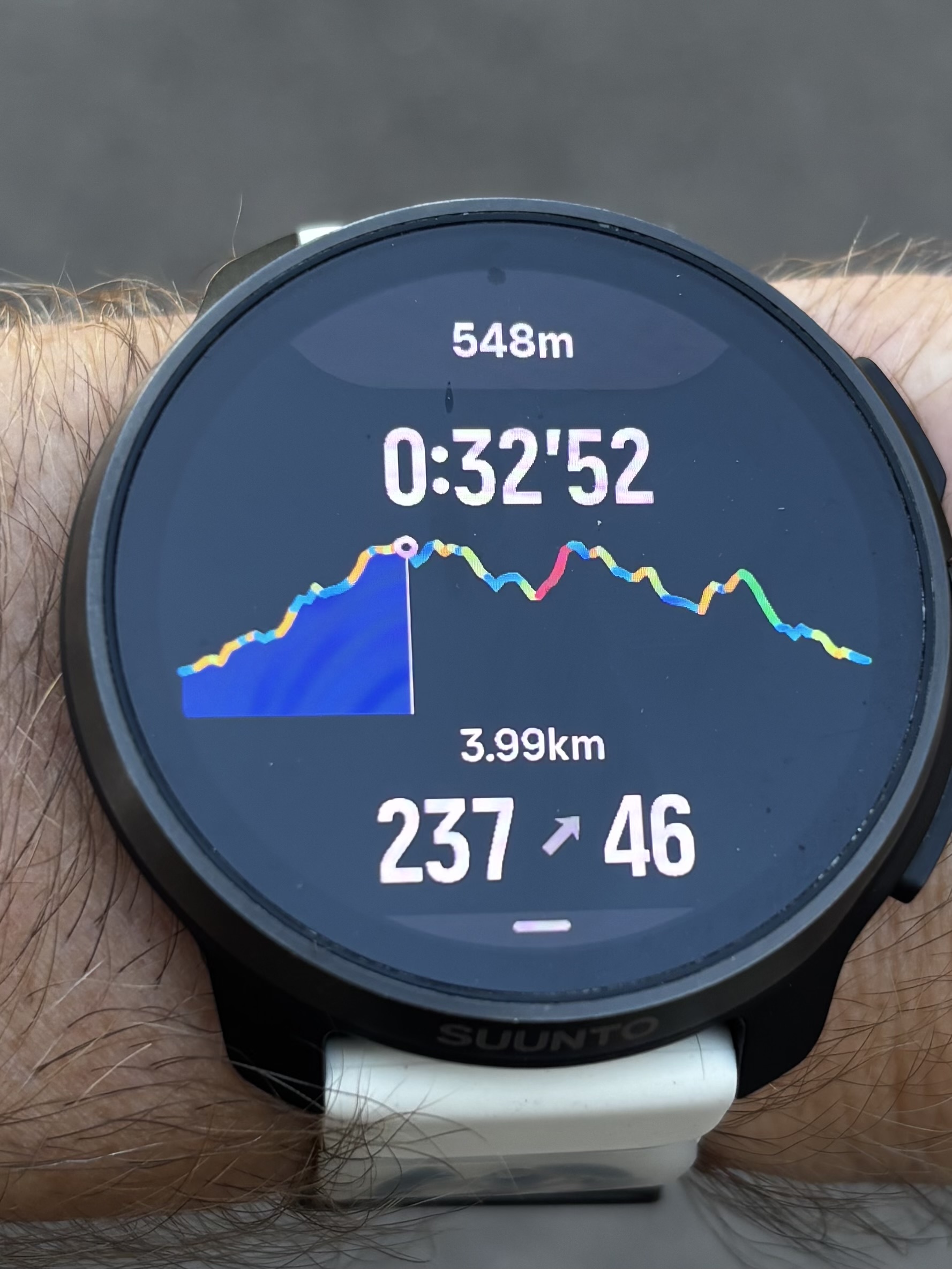

                                This is true with turn by turn notifications, but not for Climb Guidance V1. (I didn’t have the chance yet to test Climb Guidance V2)
                                If you turn back, Climb Guidance V1 do not reverse on the main altitude profile, only in the zoomed segment. This results in having a data screen that shows you being eg in a red segment uphill, and then you zoom and find yourself in a green downhill.
                                Suunto Race 1 and SuuntoApp on Android 13.
                                JoaquinJ 2 Replies Last reply Reply Quote 1
                                • JoaquinJ Offline
                                  Joaquin Moderator @SergioB
                                  @SergioB Yes, it does, but maybe not exactly as you expect. When you reverse direction, the altitude profile also flips, so the profile shifts to the left, starting again from the beginning (as you can see in the picture).
                                  The colors on the main altitude profile do not change, but you can clearly see if you are going up or down just by looking at the profile itself. At the same time, the sections adapt and show the correct color according to the new direction.
                                  Climb Guidance v2 is different, because the purpose there was to personalize sections based on the direction and user-created waypoints. That’s why in this case the profile only changes direction, not the colors.
                                  For case 1, we are aware of this, and hopefully in the future we can make the main altitude profile colors also change when reversing direction, since that would be more intuitive.
                                  Technical & Product Specialist – Suunto Iberia

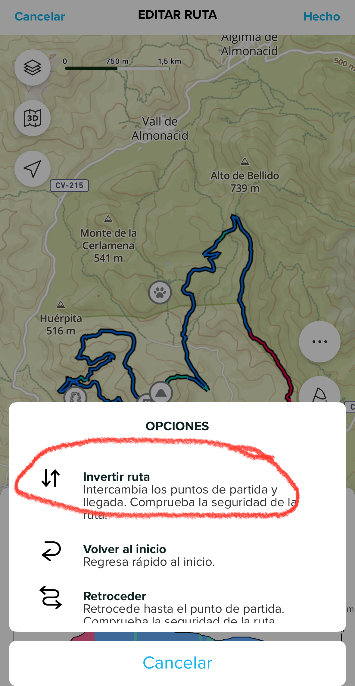

                                      @SergioB other option, if you carry your phone with you, is to simply edit the route in the app and invert its direction. In just a few seconds the route will automatically update on your watch without the need to stop the activity.
