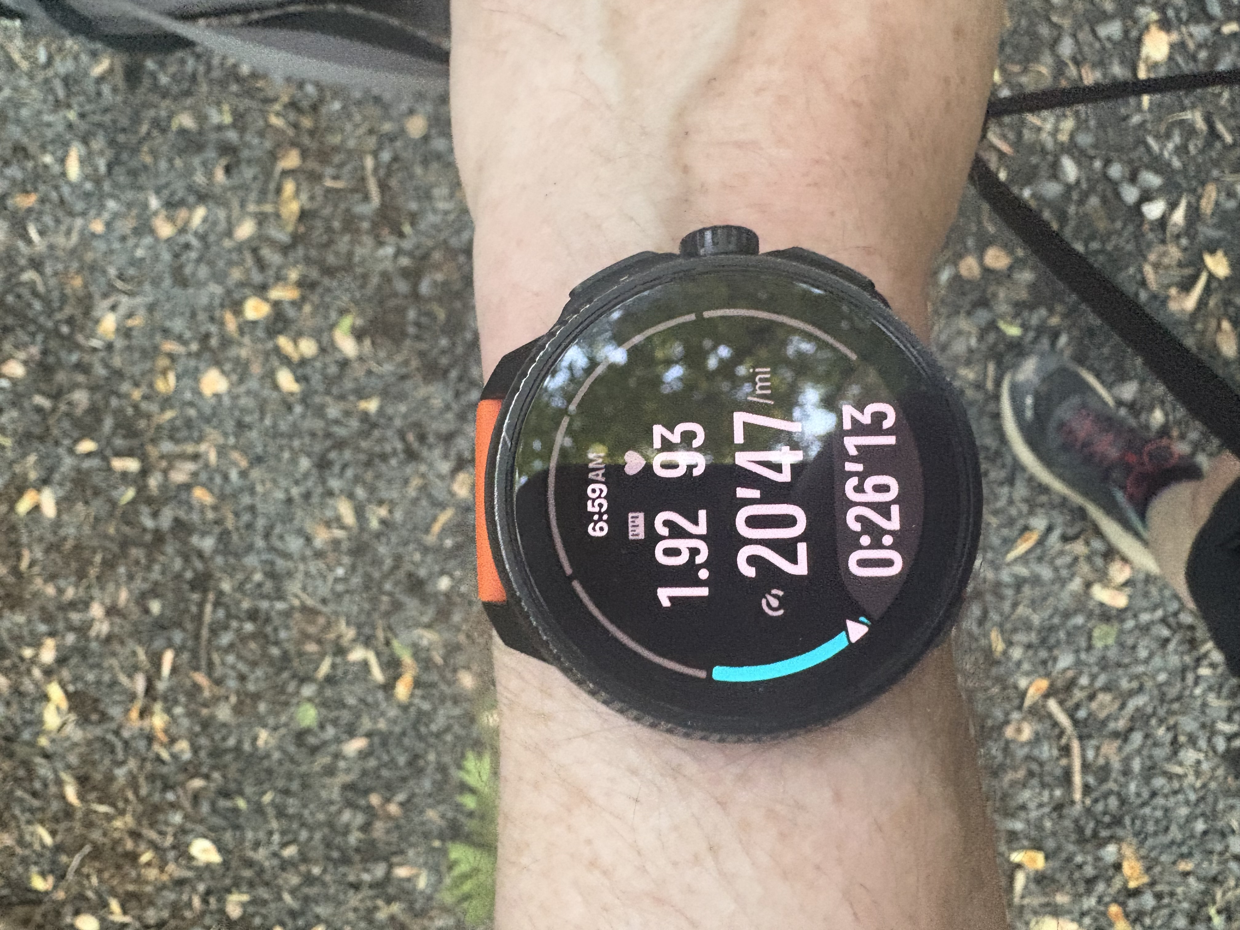

                      OK so I ran this morning Issue persists.
                      I did wet the heart rate belt actually soaked it. I also reinstalled the ZoneSense app. I actually noticed the zonesense summary does not show in my app on my phone either. It’s very odd.
                      I will now go to the next step and replace the battery and try it again. If that doesn’t work I’ll try with my vertical and see if that gives any other result.

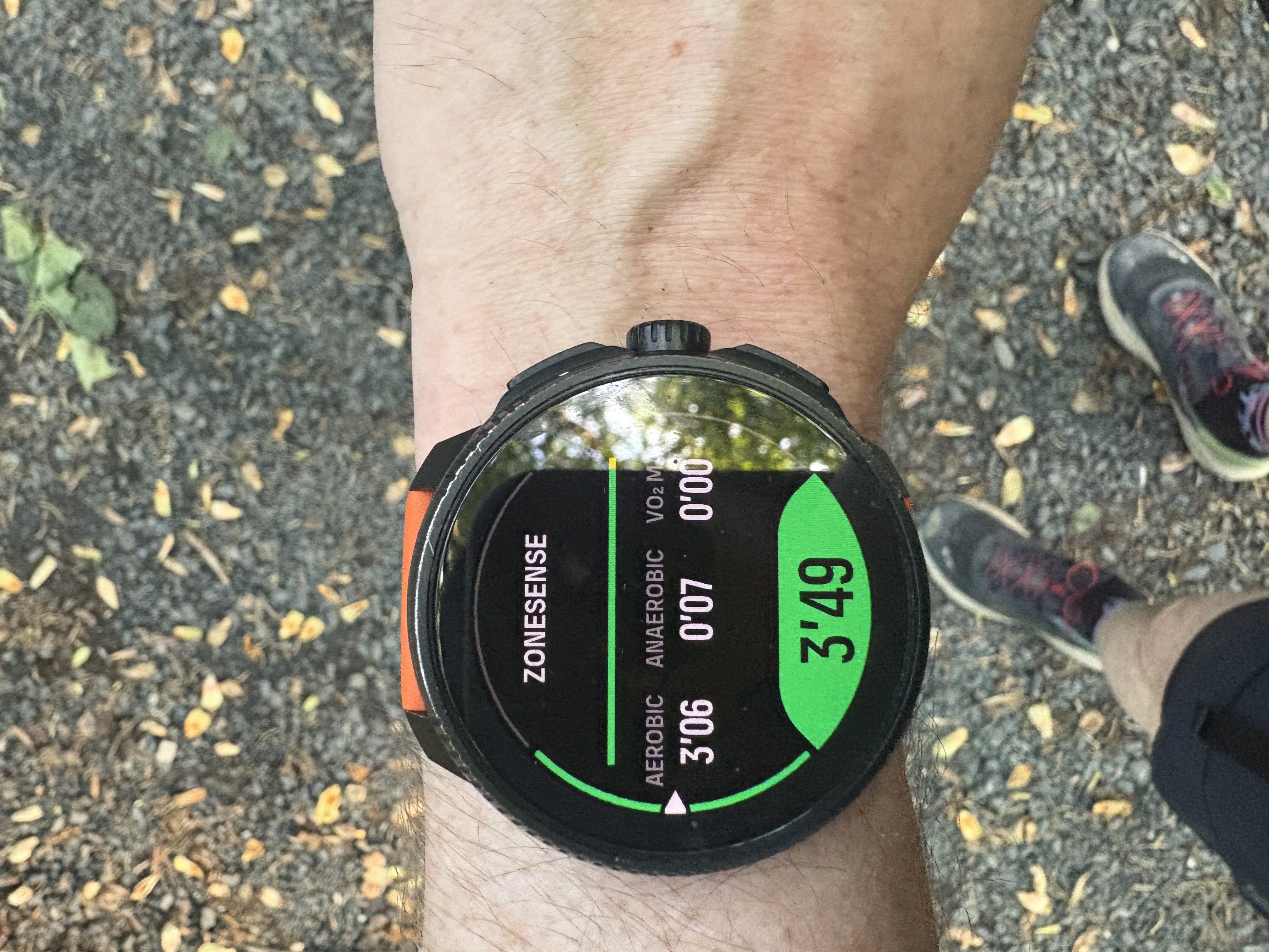

                          @BastMaSVSRS9PP
                          This is how it looks like middle of my run. ZoneSense stopped accumulating time in each zone

                            @BastMaSVSRS9PP I assume you tried a watch soft reset? And you are running the latest firmware? If you examine the R-R data in Runalyze it will show whether the data are poor or not. I assume you get HR the entire time?

                              Yes soft reset , uninstalled and reinstalled the zonesense app. Heart rate looks good otherwise. Continuous , no breaks
