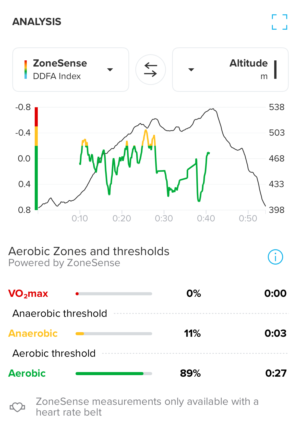

        @panadero As stated many times here and in the information on ZS put out by Suunto. Short intervals will not work! This is clear in you DDFA index plot where the DDFA is trending up on the last set of intervals continuously and then remains higher than most of the rest of the run because you are fatigued.

          @Brad_Olwin while I understand this statement I find it hard to get why while running at maximal HR (180+) and still be on the green or early yelllw zone while my RPE is different . Eg
          I think I need to understand this better . Also ther discrepancy between the watch and the app is significant with the app being more pragmatic , but I lose the real Benefit from the real time part .
          Anyway
          Brad_OlwinB 1 Reply Last reply Reply Quote 0
          • Brad_OlwinB Offline
            Brad_Olwin Moderator @thanasis
            @thanasis Your AT was at 154, a good 14-20 bpm higher than mine. My LT is somewhere around 163. If your range is similar to mine your LT is much higher. The graph you show is near AT for a few minutes and ramps up, not constant. For the first one you began getting into Anaerobic. The second enters anaerobic quickly and starts into VO2M, you just were not long enough in VO2M
            Assuming we have the same range you should not hit LT until the high 170s to 180 bpm so you were barely at LT.
            Vector/T6c/Vertical 2 Ti
            thanasisT 1 Reply Last reply Reply Quote 2

                @thanasis it looks like you were going too fast in first 10 mins of ZS calibration, by judging on the HR in this 10 mins and also that it shows right at minute 10 you were on yellow and moved to green. In general going too fast or too slow during ZS calibration will influence threshold measurements, doing a regular aerobic warmup is best.

                    Today I did 6x hill repeats - around 3 mins running uphill at threshold pace with 3 mins recovery. ZoneSense was consistent with capturing the increased effort after each hill. Most importantly it detected my AeT at 160 bpm 😁 This post is not meant to add any useful information but just to show off a bit 😛
                    EDIT: the change from green to yellow doesn’t happen at the end of each hill, but exactly at the point when my effort increased, when the hill turned into stairs. Amazing!

                        I extracted a stream CSV file from intervals.icu for that activity above, and asked ChatGPT to detect my AeT using methods such as DFA-⍺1 or DDFA, and here’s the response:
                        “Based on the DFA-⍺1 analysis of this new file, the estimated aerobic threshold heart rate is approximately 146 bpm. The detailed analysis is available in the displayed data table.”
                        That looks like an accurate value for me and for my fitness state on that day 😄

                            @VoiGAS As you can see from my previous post, SA shows a detected threshold at 160 bpm. I wish this was true!
                            I know that DFA-alfa1 method has limitations, but it’s fun to explore, and if you repeat the same exercise for multiple activities you get similar results. For today, for instance, chatGPT returned 142 bpm which I find accurate considering I’m a bit sick.

                                @Elipsus For that specific run I think so. 160 bpm is too high for me. When the estimation is displayed on my activities, ZS usually gives me between 140 - 148 bpm, sometimes less.

                                        Today I got strange drop of ZS value while speeding up for two minutes. I’ll expect opposite direction even with delay…

                                          @Jan-Suchánek you started running downhill. It’s not surprising that your pace increases and the effort decreases. I always like going downhill, somehow it feels like going South.
