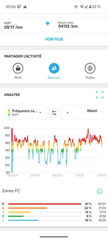

                                        • LisztoL Offline
                                          Liszto @Brad_Olwin
                                          @Brad_Olwin for example this is my session of the day, and I still have the message “do 1 outdoor activity” after this one.
                                          cardio graph
                                          Brad_OlwinB 1 Reply Last reply Reply Quote 2
                                          • Brad_OlwinB Offline
                                            Brad_Olwin Moderator @Liszto
                                            @Liszto one issue I see are your zones! Zone 5 for 40 min is not possible. I don’t know how you set them but they are too low. This may contribute to your issues with race prediction.
                                            Vector/T6c/Vertical 2 Ti
                                            LisztoL 1 Reply Last reply Reply Quote 2
