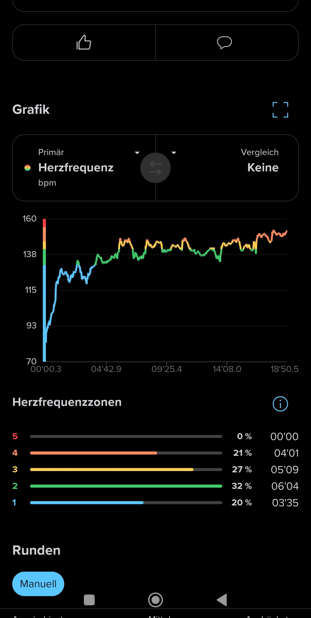

                    I want to share my recent experiences regarding the Optical Heart Rate (OHR) sensor on the Suunto Race 2, as it has become a major dealbreaker for my daily training.
                    The Core Problem: Initial Lock Failure
                    During the first 10–15 minutes of dynamic or high-intensity workouts, the OHR sensor repeatedly fails to track my actual heart rate:
                    Example (36-Minute HIIT Circuit): For the first 17-minute attempt, the watch froze at ~100 bpm (Zone 1), completely missing the intense physical load. I had to stop, save, and restart the activity. Immediately after the restart—without any change in positioning or effort—the sensor picked up perfectly, averaging 138 bpm with accurate peaks in Zone 4.
                    IMG_20260910_103528.jpg Screenshot_2026-09-09-16-30-54-147_com.stt.android.suunto-edit.jpg Screenshot_2026-09-09-16-31-11-582_com.stt.android.suunto-edit.jpg
