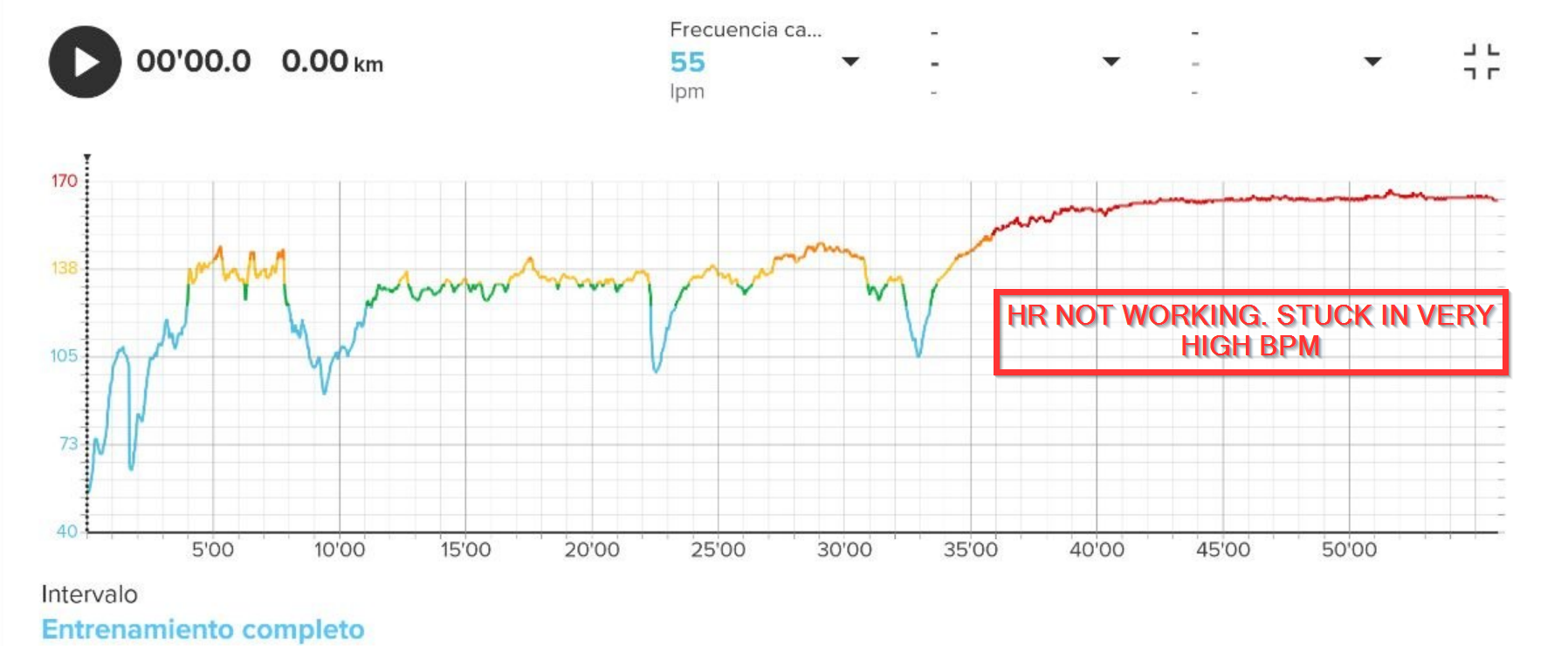

                        My HR with the Race 2 and the latest firmware is not working either for me. This is a very new device. It worked 35 minutes but then, there’s a moment that the sensor is stuck in very high bpm readings (completely off).
                        I didn’t expect this at all. In fact, I remember I had a similar issue with the Race 1, and despite having a diferent sensor.
