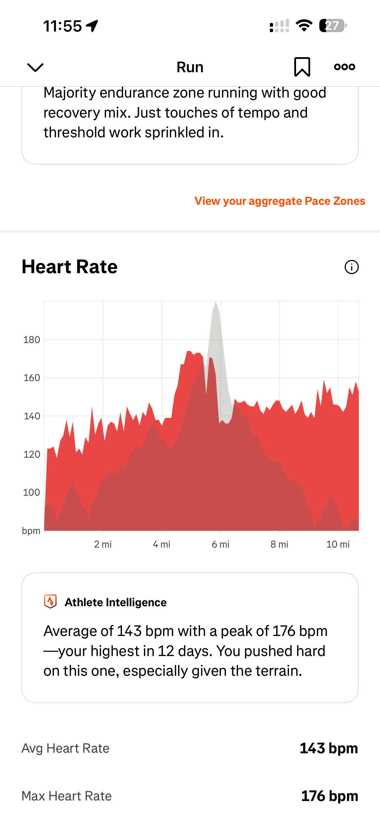

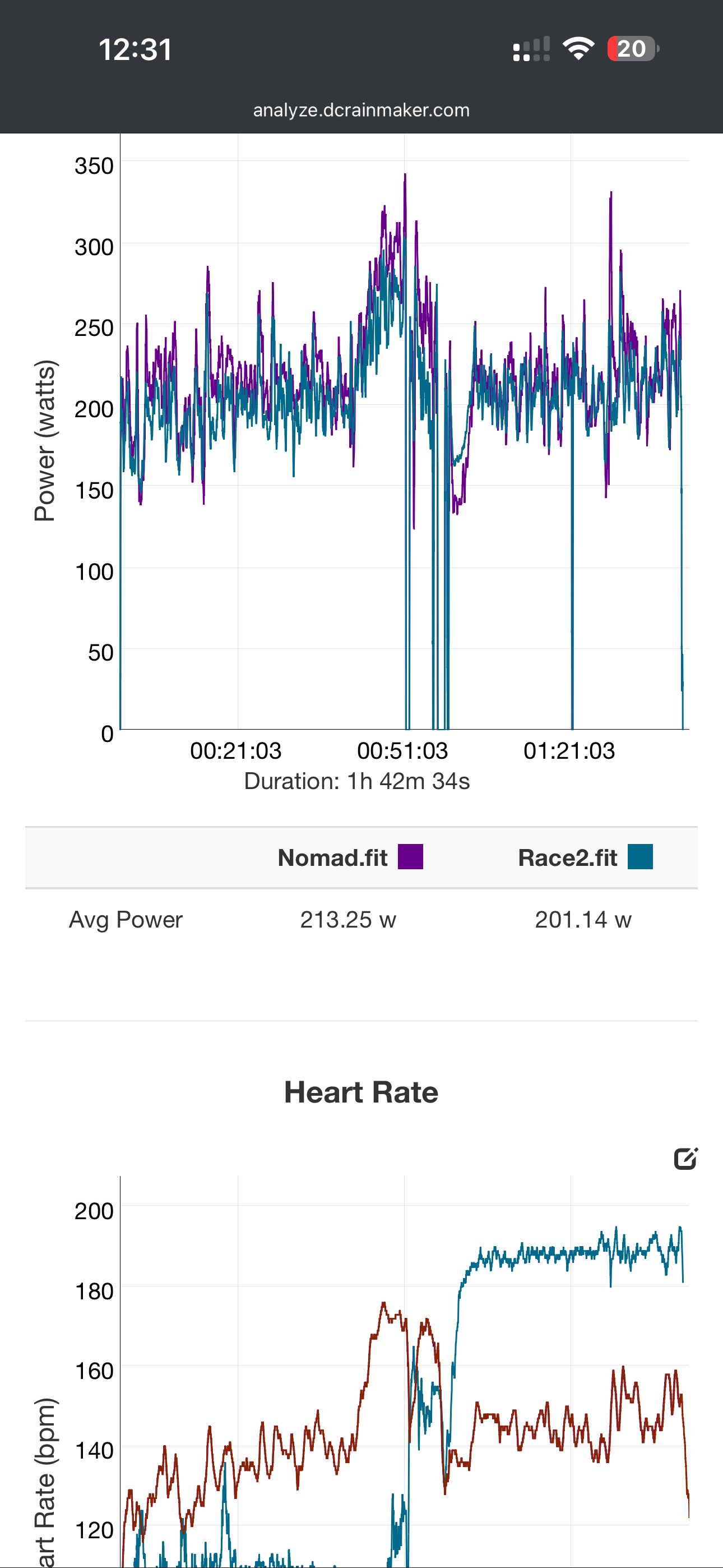

      My understanding was that Suunto had finally resolved their heart rate issues with the Race 2. My watch is updated to the most recent firmware but heart rate accuracy is possibly the worst I ever ever seen. Over a 1 hour 40 minute run, at most only 3 or 4 minutes was within 25 bpm of an external sensir.
      I did a 10 mile run, first 5 miles were climbing, then a 300 foot hill effort then the final 4 miles were downhill.

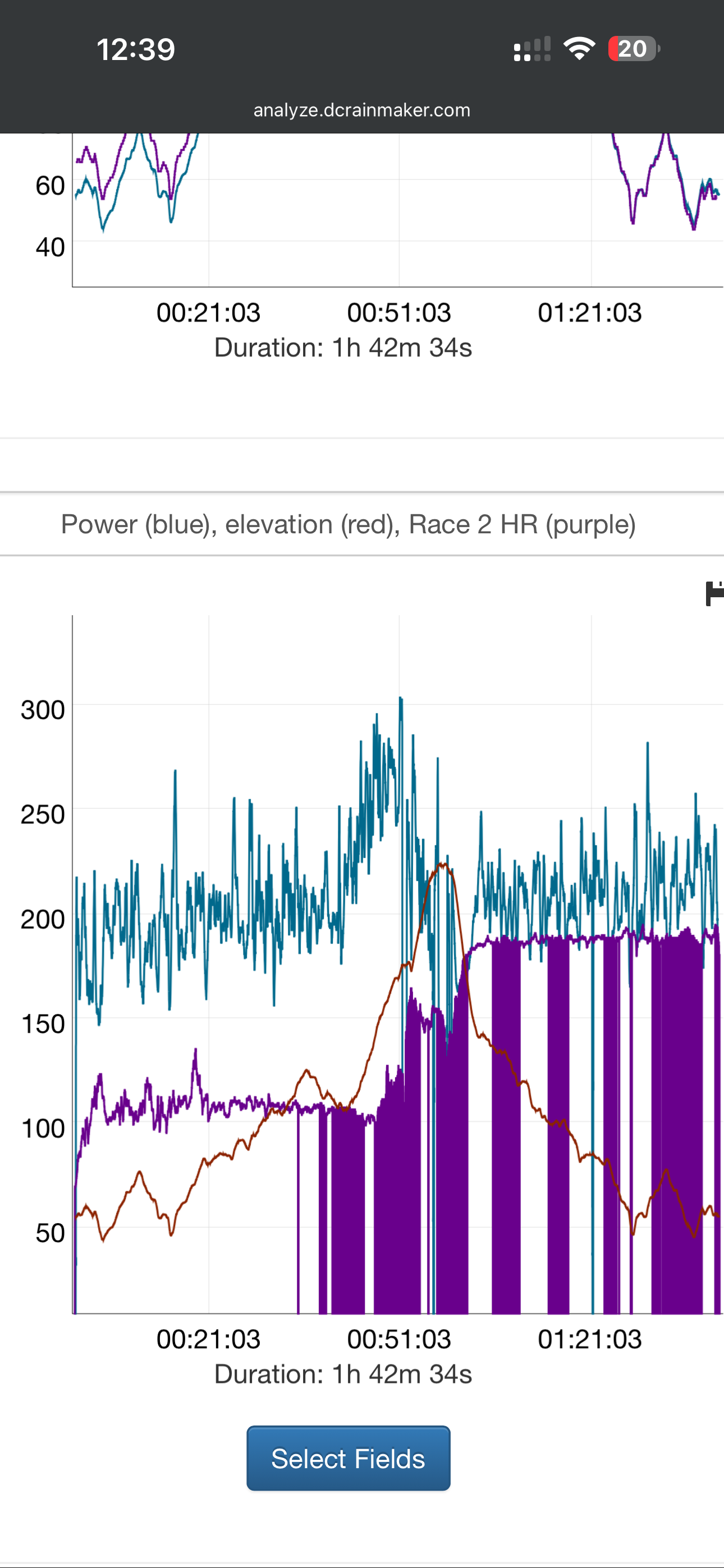

      Throughout the ascent, the Race 2 heart rate ‘stuck very low’, hiverng around 100-110 bpm. Actual HR was my usual easy / high range (measured with an external HRM on another watch. After the hill effort the Suunto Race 2 heart rate finally began to climb but got stuck very high, around 190-195bpm (my max as a runner nearer 60 than 50 is 181).
      Honestly heart rate monitoring via wrist seems totally broken -
      alt text
      This shows the elevation profile and actual HR from the watch
      alt text
      I have also uploaded a running power / elevation plot whicb shows very clearly Suunto heart rate is just not reflecting effort correctly.

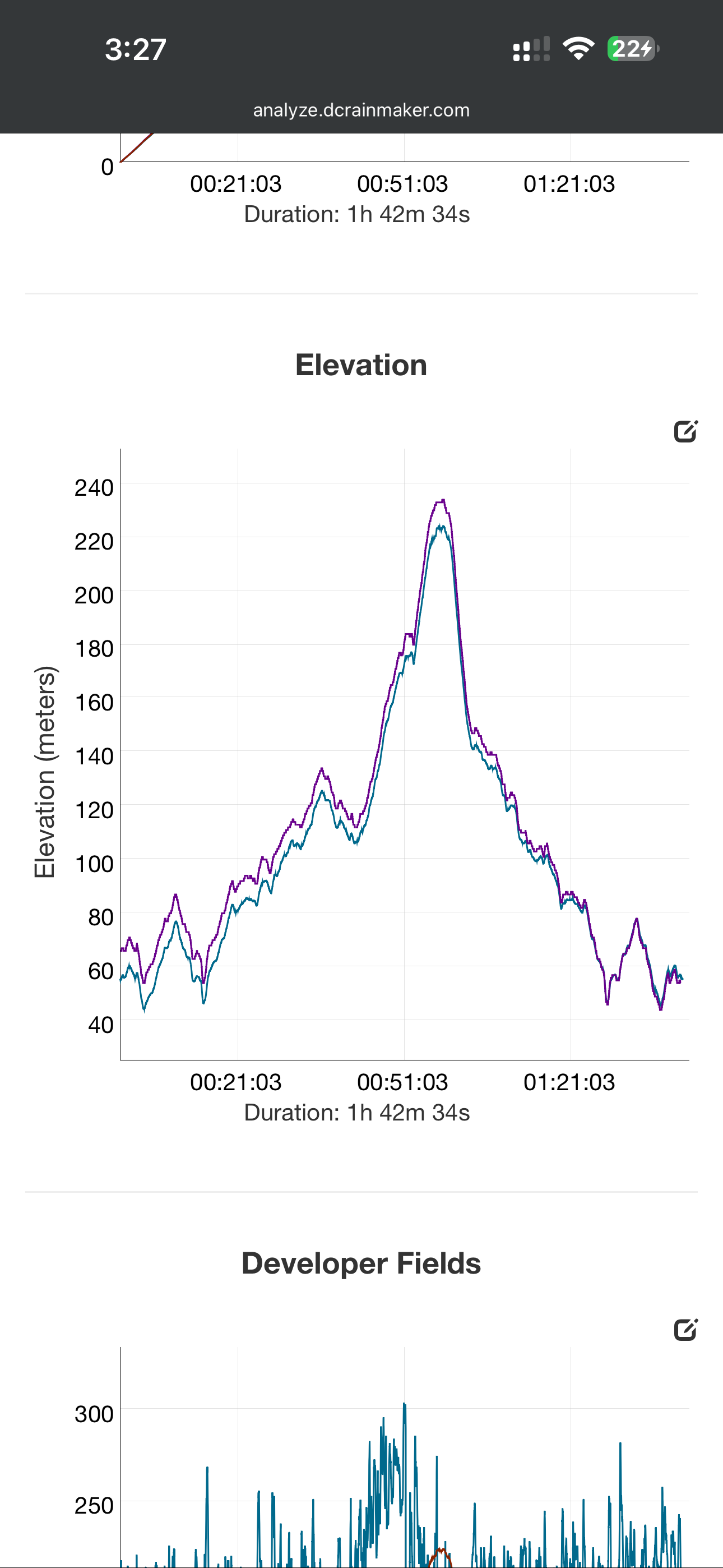

      On another note, the Race 2 is clearly ‘shorting’ distance compared to prior runs with other watches including Suunto, Coros and Garmin and caliberated Stryd. Over just under 11 miles distance came up 0.20 miles short.
