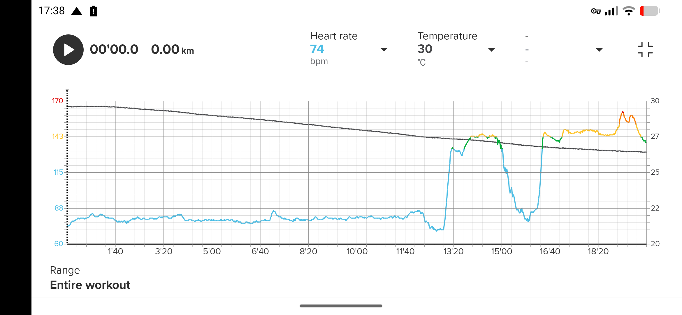

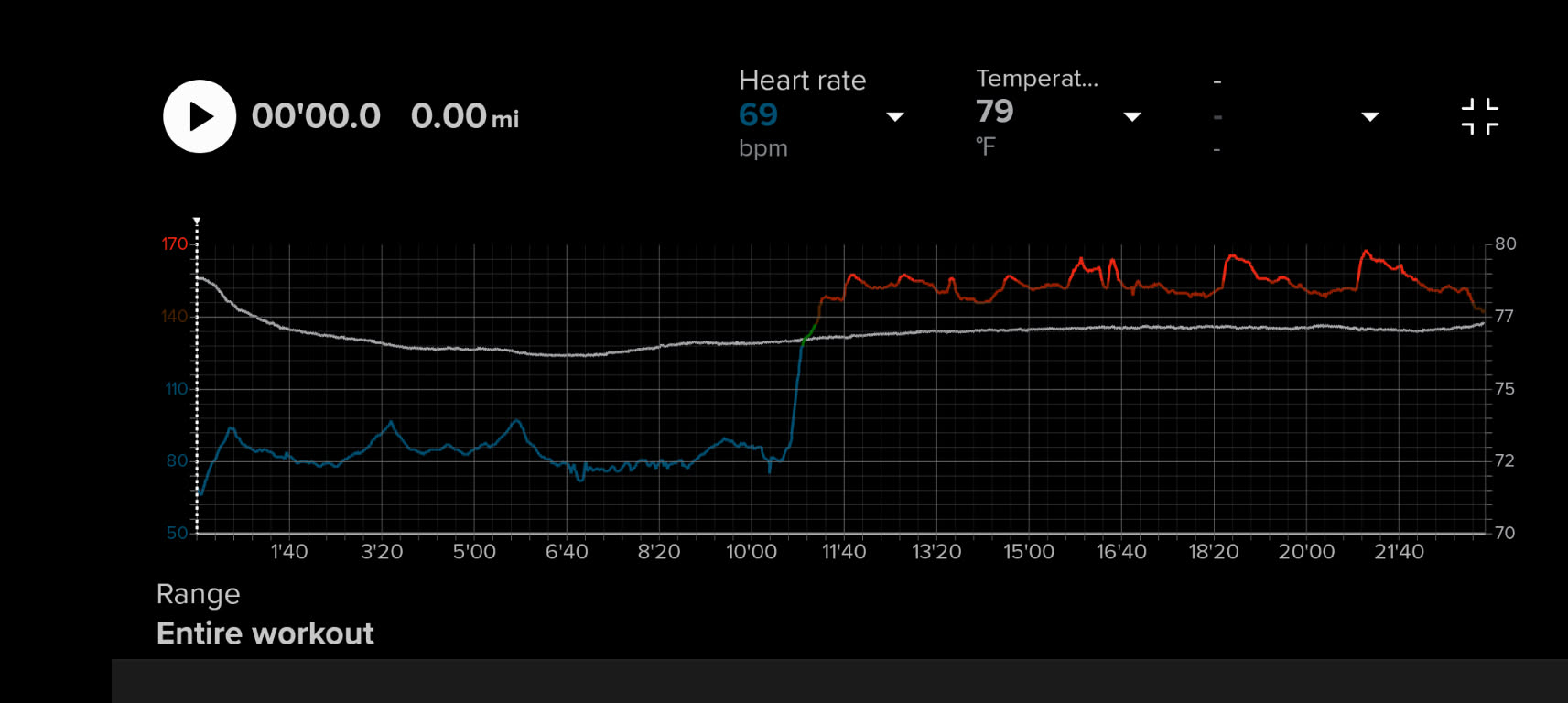

      Hi everyone

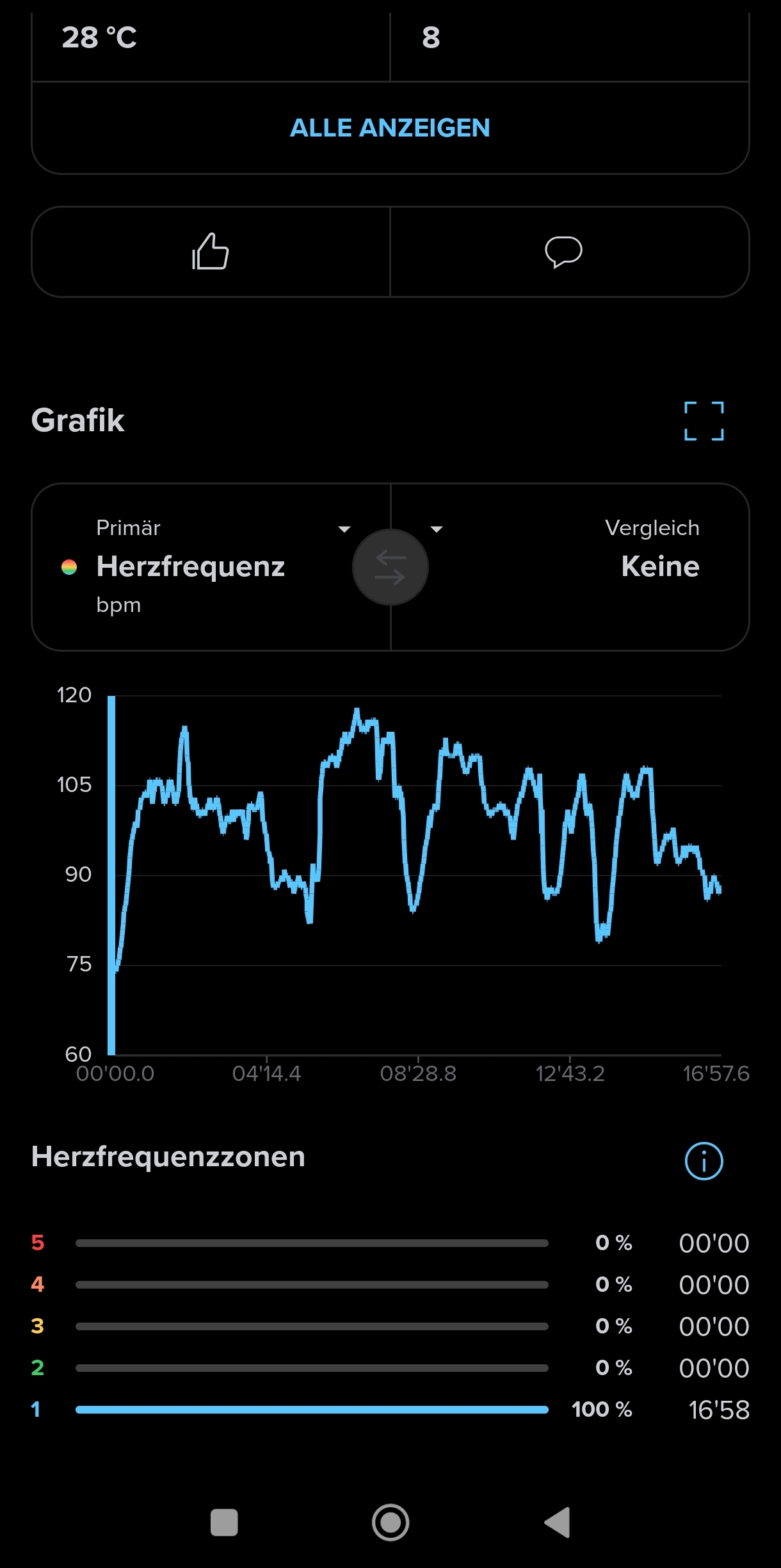

      Since the new firmware update the heart rate monitoring has been a bit broken.
      Yesterday the heart rate was stuck between 70 - 80 bpm for 10min then suddenly snapped back to expected ranges:
      heart rate
      Has anyone experienced this?

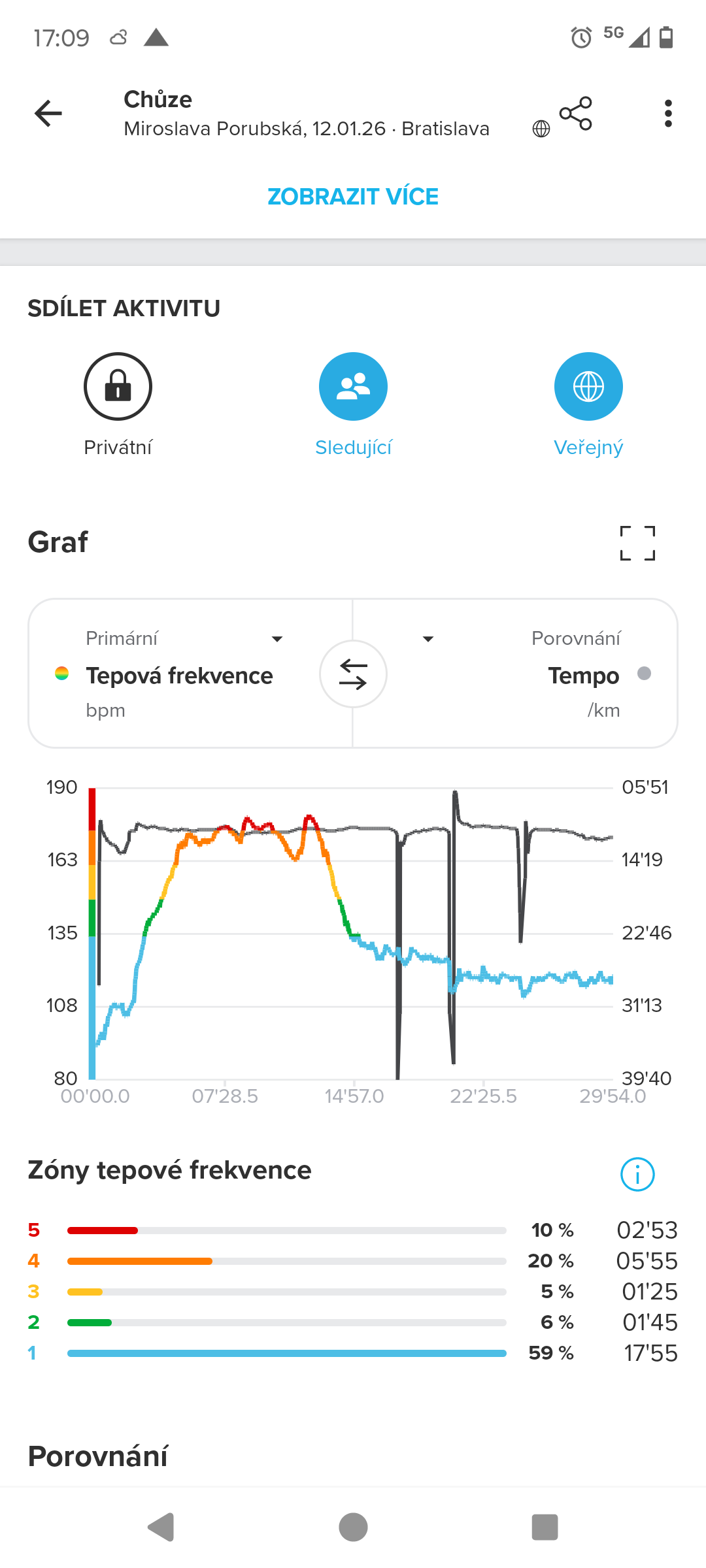

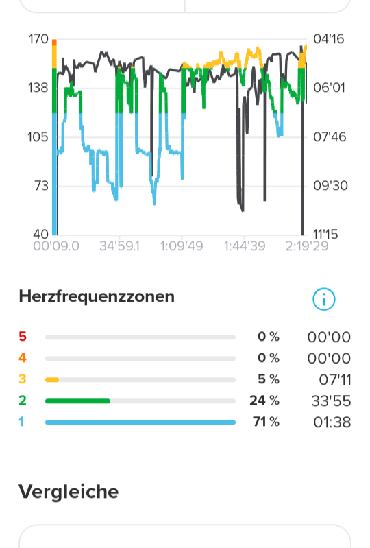

        @Anrich-Potgieter yes i uploud my post few minute ago but i have Race 1. This is screen from my walk1000021777.png
        GraysarG 1 Reply Last reply Reply Quote 1

            @Anrich-Potgieter Same here.
            I use an HRMstrap when running, but not on the Rowingmachine.
            Race 2 v2.50.26
            Best, Sven

              Same here, first activity with new firmware. First 11 minutes of OHR reading is incorrect. I had same pace from begining on closed lap. My HR was higher from beggining. Between 30-40min lower HR is fine as i went slower in that part.
              But i experienced something like that rarely with old firmware too.

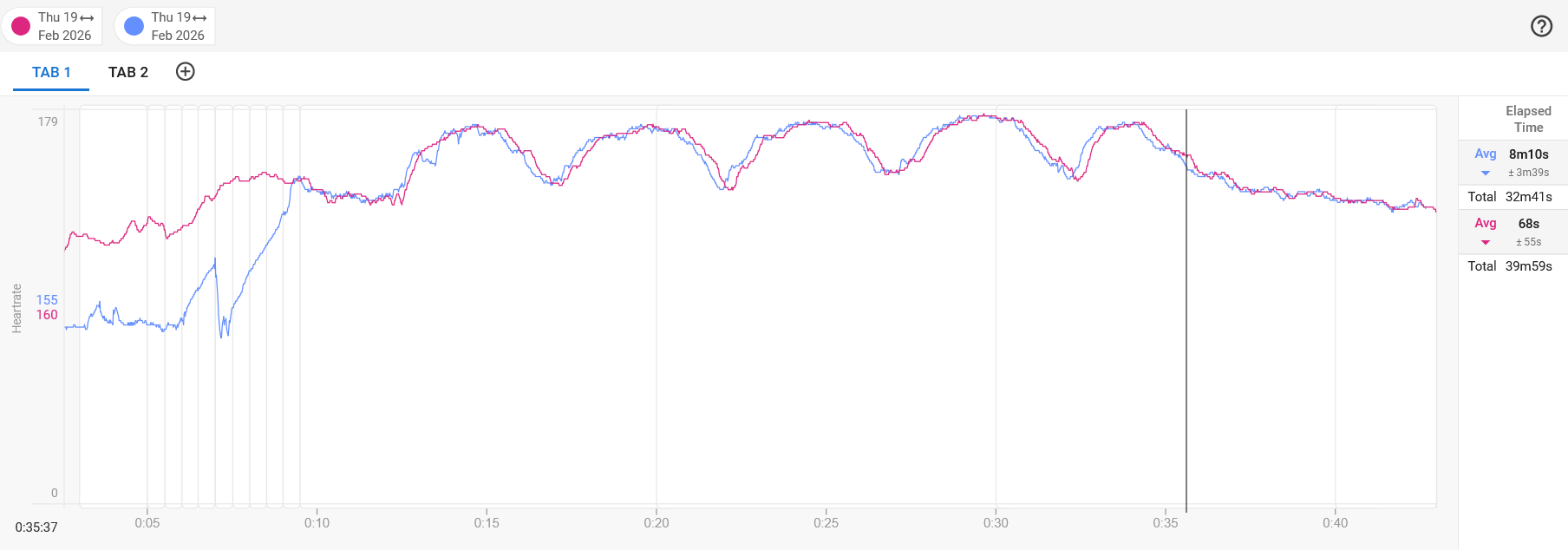

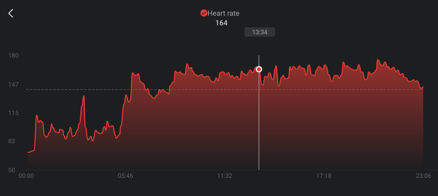

                Came here to see if anyone else was seeing this. Had a few workouts and suspected this but on a new programming and 2nd guessing. Today, I wore this and bicep strap with AmazFit app sync. WILDLY different results for the first 10 mins or so.
                First 3 mins or so is a warmup and expected the lower rates there, but after an initial spike, you see the strap lock on at least 5 mins sooner to my cadence.

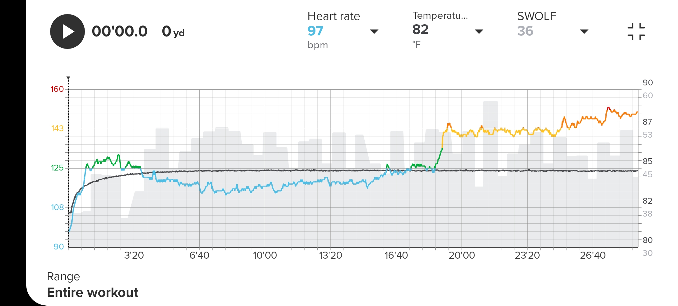

                  I have a similarly suspicious HR output from a pool swim yesterday.

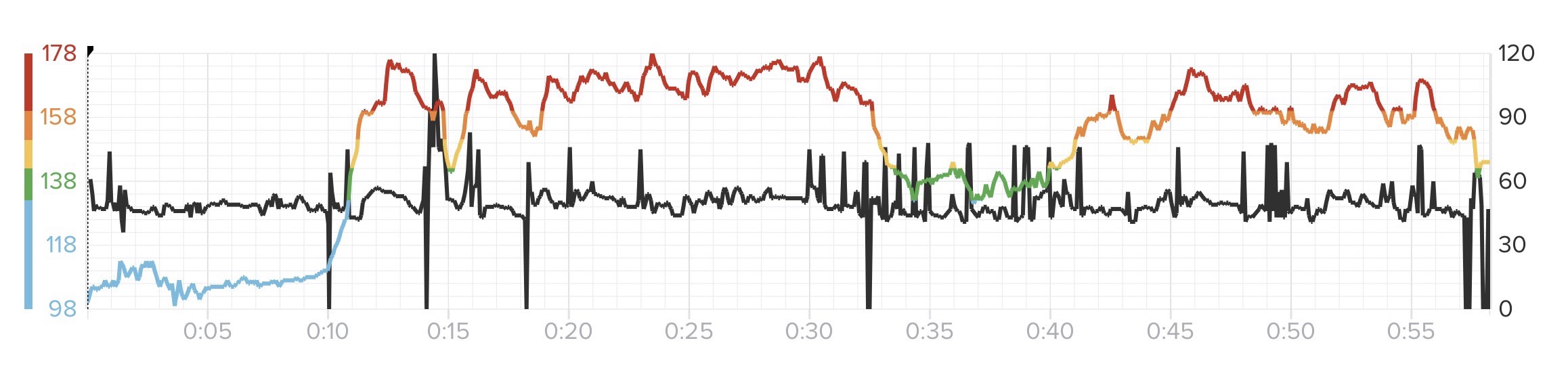

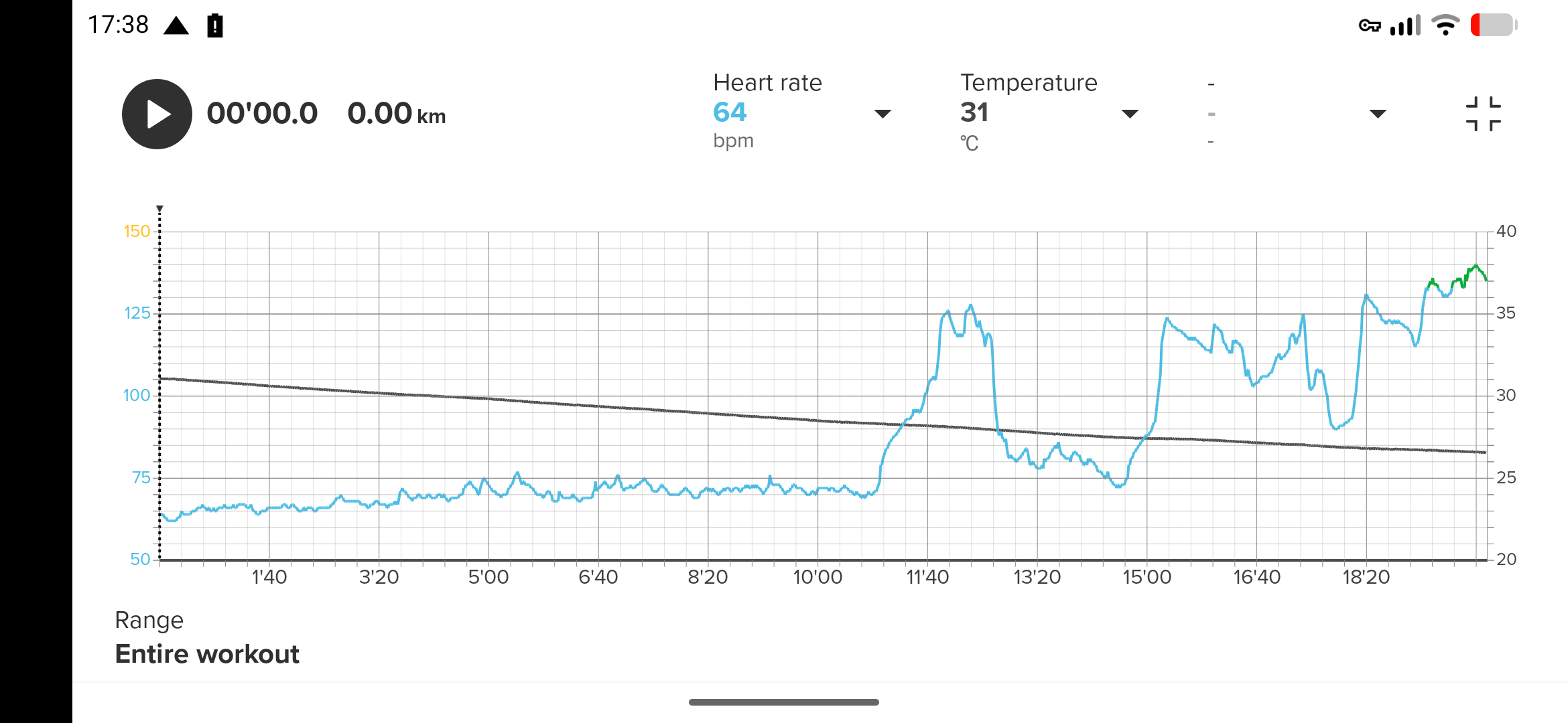

                    Another two workouts with very broken HR, the HR is locked until my first rest, then begins to climb.
                    T 1 Reply Last reply Reply Quote 0

                          I have a similar problem with my Race and Polar H10, where it gets stuck at 70-80bpm sometimes.

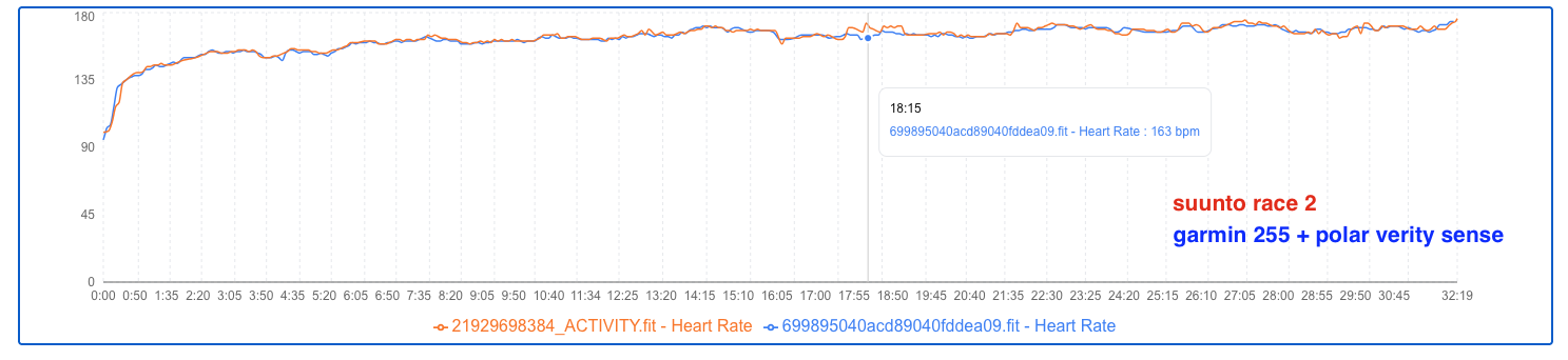

                                      I did a hard reset and did a 5km test run, and compared the activity with my old garmin forerunner 255 + polar verity sense arm band.
                                      Looks much better now, there are some wobbles here and there (like showing up 10bpm higher in around 18minutes), but overall it is pretty good (162 to 163 bpm average).

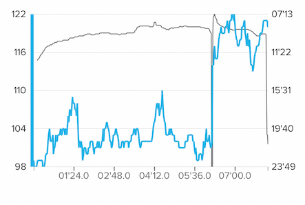

                                      Climbing the stairs still not quite good, the HR is updated to proper values only after i stop for a while, and yes I had the watch pretty tight on my wrist and a bit above the bone.
                                      And to indicate what was going on before hard reset, one of my walks:

                                          Have the same problem, HR stuck at 110 BPM during the first 20 minutes of running, then suddenly goes up to 165 bpm which is the correct reading. It was working better before the last firmware.
