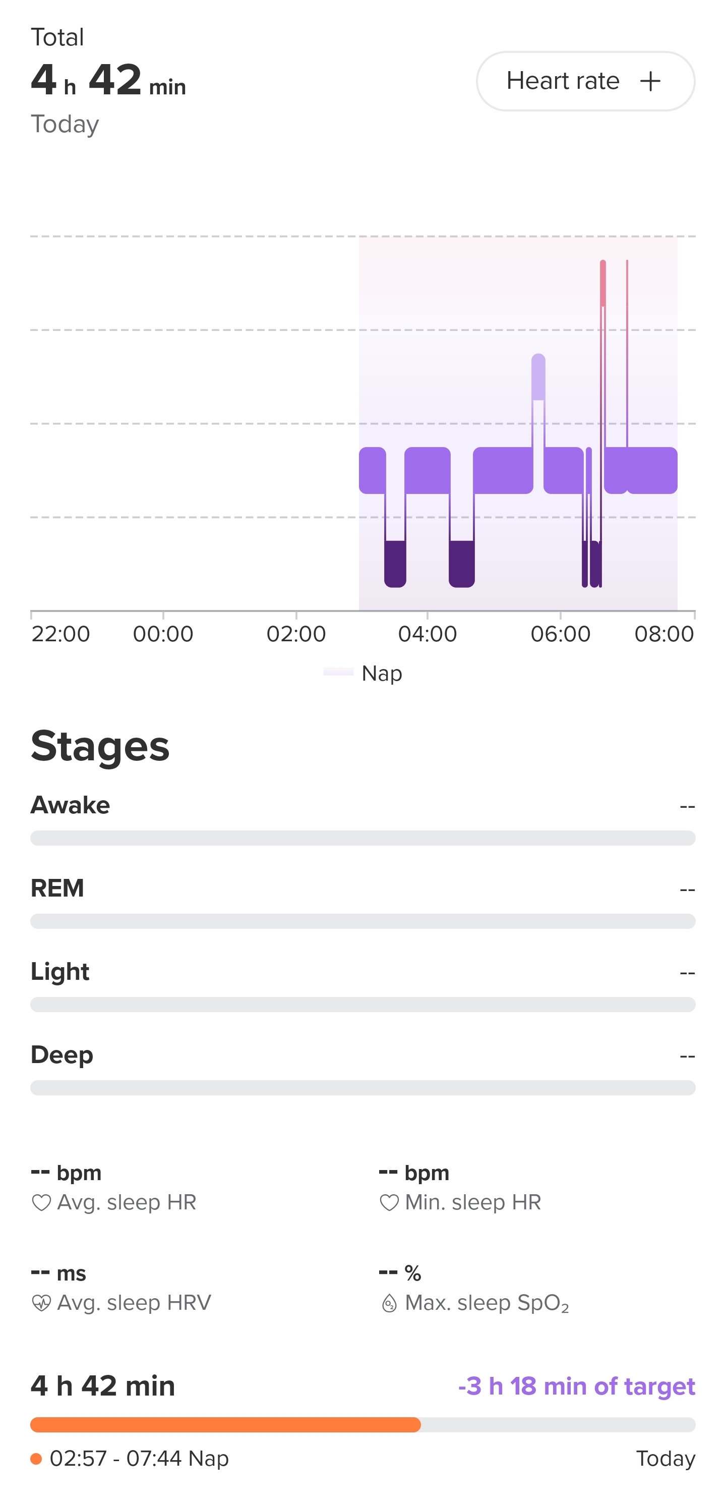

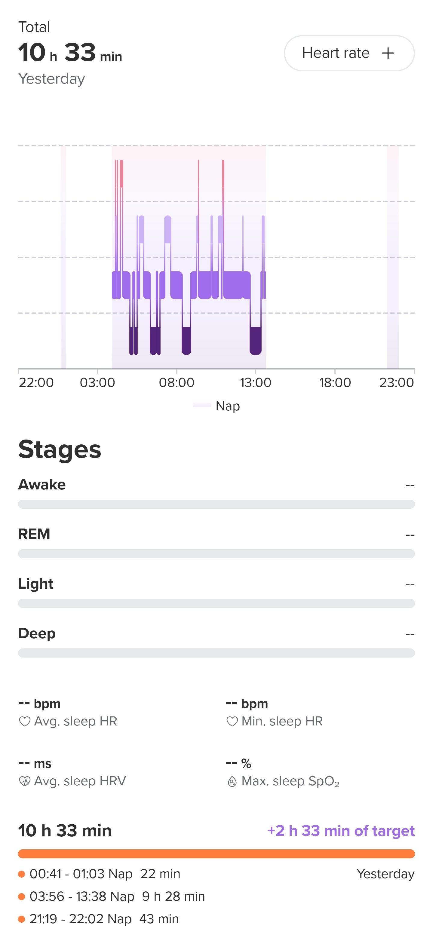

                                          I dont know what happened, but last 2 nights watches detect my sleep as a nap only:
                                          Also, not all the times, when I had a “nap” are correct on the watch - this happened before pretty often.
                                          Suunto Race S
                                          Manuel ExtremeM 1 Reply Last reply Reply Quote 0
                                          • Manuel ExtremeM Offline
                                            Manuel Extreme Silver Members @Александр Даниленко
                                            @Александр-Даниленко
                                            Check the heart rate monitoring. If you find gaps in the graph, it also affects sleep tracking.
                                            The interrupted monitoring is likely due to a sensor “sensitivity” issue that I have reported several times.
                                            Vertical 2 v2.53.42
                                            Александр ДаниленкоА 1 Reply Last reply Reply Quote 1
