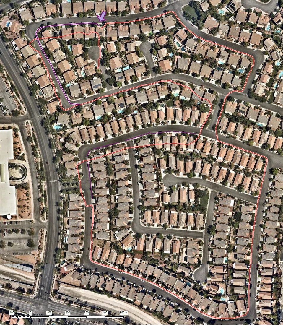

                @isazi Today I tried with a test route deviated with it, and did fine, so I am issuing another “Mea Culpa.” I got the message I was off-route, ignored it, and it kept issuing a breadcrumb trail. When I recircled back, it rejoined navigation.
                The odd things I noticed are the lapses where it gave a position that was inaccurate to about 30-40’. I let the watch sit outside for a minute to find my location, before I began. It had me starting somewhere else, got an exact track for a while, then had another inexplicable deviation from the track. This area has mainly 1-floor homes. Even odder, in a comparison in a mountainous area with tall trees, my Garmin 65s and Suunto V had better agreement.
                Red is Suunto; purple is where track should be; purple arrow is true starting point:
                https://hwstock.org/test2.jpg
                I’d guess the garmin 65s has a more sensitive antenna (it also does dual-frequency). When I start up on the bottom floor of my 2-floor house, the handheld always finds my position, eventually. The suunto V has found its position while on the bottom floor, perhaps 10% of the time; usually I have to go outside.
                sartoricS 1 Reply Last reply Reply Quote 0
