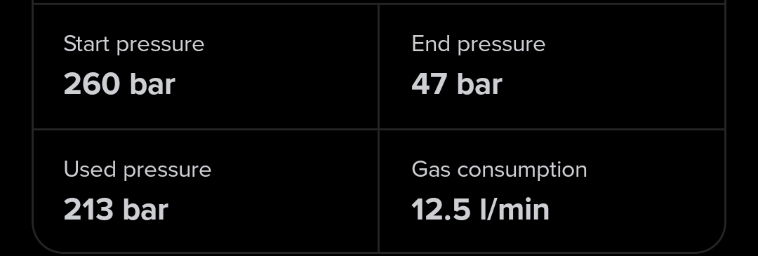

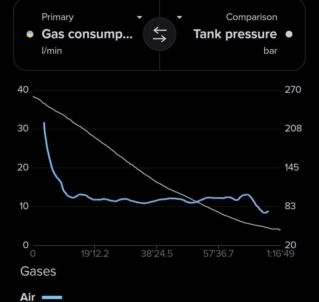

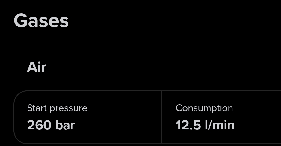

          @Migsey If you see the pressure, the problem sits in you app. As the SAC is derived from the pressure during the dive. In the beginning of the dive the SAC is - - <null>, thats normal. But later in the dive the SAC should set on an average number and should never show - -. I checked this morning with the Nautic and EON Core… they are identical…

              @Migsey wrll, my dive this morning was with the new firmware and I noticed that after a minute the SAC value started high and graduately leveled around 12 / 13.
