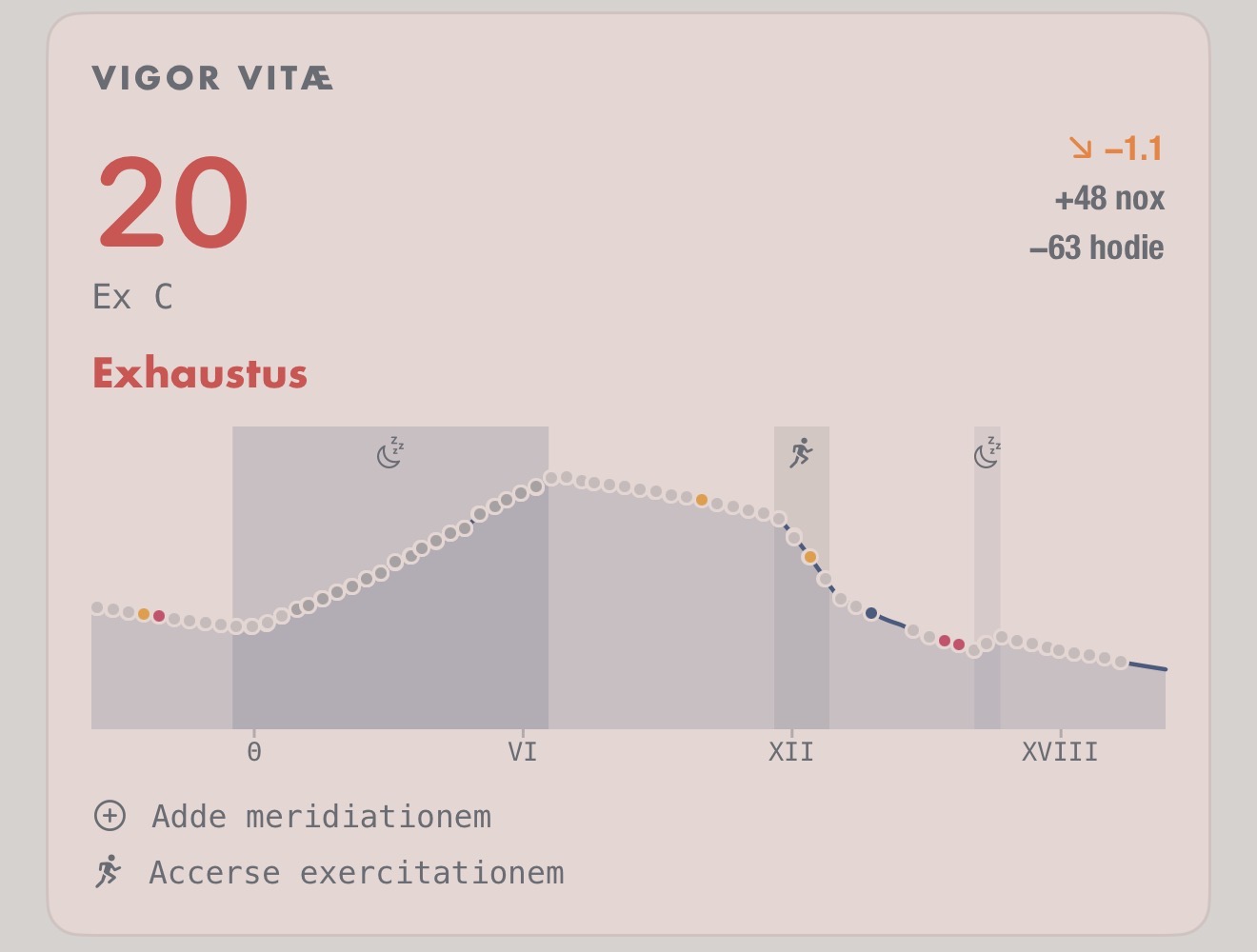

            @GiPFELKiND I did comparative testing of my own algo mimicking Garmin’s Body Battery (analogous to Resources), and found that HRV wasn’t as impactful as I thought.
            Loose concept is a four-way charge/drain mechanism:
            1. Sleep - charge
            2. Wake - not moving - low drain
            3. Wake - not moving but slightly increase HR - higher drain
            4. Exercise - higher drain
            The functionality is dependant on having an accurate max HR, which can be a challenge (and where Garmin’s constant max HR estimation can be helpful).
            @elad-solomon here’s a peak at a nap with mine: it goes up, but not by a lot. Basically, and not to dismiss your needs, but worry about the baby and not a very fragile fictional estimation of your resources. 🙂

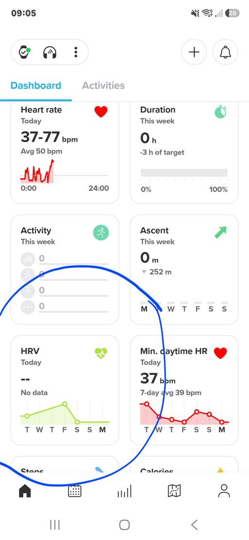

                    @Ze-Stuart yes I have used elite HRV for some time and then stopped.
                    Unfortunately currently that’s how my nights looks like and the watch does not recognize those as sleeps.
                    Hence why enabling HRV during long naps could be beneficial. – ms
                    Avg. sleep HRV
                    4 h 57 min
                    23:24 - 01:18 Nap 1 h 54 min
                    03:13 - 04:40 Nap 1 h 27 min
                    05:36 - 06:34 Nap 58 min
                    07:44 - 08:22 Nap 38 min
