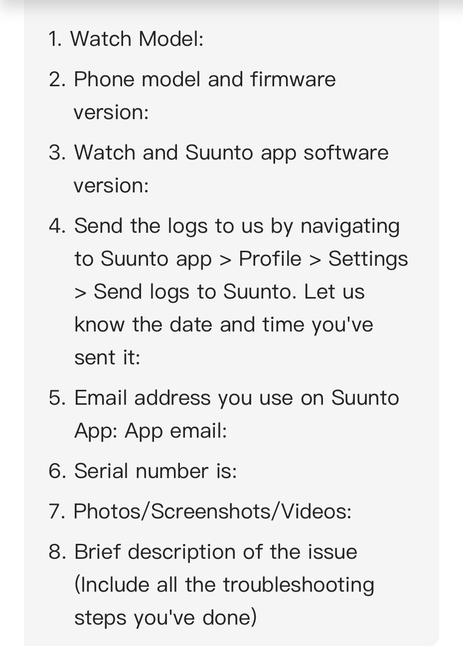

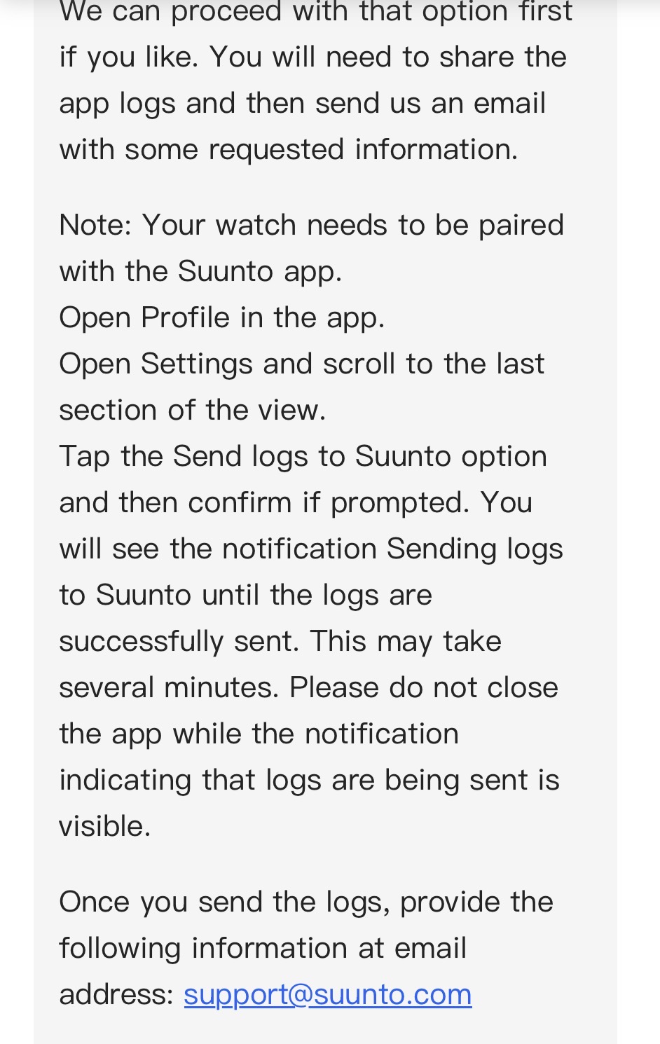

                        Same reboot has happened to me now 3 times in the last 16 days. Just got on the support chat and was given instructions on how to submit the logs and follow-up email (I’ll attach the screenshots from the chat to make it easier for anyone else rather than having to do the chat first).
