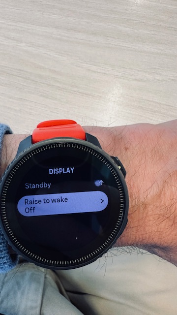

                • K Offline
                  Kristof @Kristof
                  Hello
                  Yes i tried everything. Soft/hard reset. Nothing seems to work. Very embarrassing.

                    • D Offline
                      duffman19 @Kristof
                      @Kristof @sartoric I did my best to describe the issue on a thread here - https://forum.suunto.com/topic/14502/backlight-bug-2.50.26
                      The problem starts after entering an activity start menu (don’t have to actually start the activity). This activates the raise-to-wake feature even if the setting is turned off. The odd part is that it doesn’t happen every time (maybe 2 out of 3?), but, at some point during an activity, it is almost guaranteed to activate.
                      A dangerous side effect is that if you go into an activity start menu, but then back out to the watch face without starting, the backlight will remain permanently on. @kristof this may be what is causing your unexpected battery drain. The only way to turn it off is to toggle the backlight setting either in the control panel or display settings.
                      This issue has been mentioned multiple times since the latest update and affects both MIP and AMOLED watches (in slightly different ways), but has yet to be acknowledged by anyone from Suunto. I’m hoping this is a bug resulting from an upcoming feature allowing for per-activity display settings. 🤞

                      • K Offline
                        Kristof @Kristof
                        Thanks @duffman19
                        I checked the settings several times and they are both disabled. I think it’s a software issue. I already contacted Suunto bud it always takes sooooo long to get an answer.
                        So the problem still exists.
