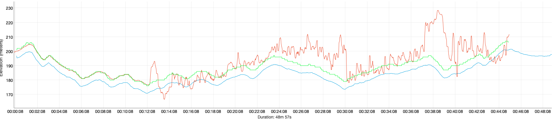

                    • S Offline
                      Stavrogin @MarkusG
                      @MarkusG I am only saying this because I had massive issues with my Garmin Fenix 7x. There is a major issue with the altimeter and it can read wild numbers. Mine would jump wildly. Not saying that is the issue, but it is a known issue with gen 7 Fenix/epix devices. That is why the new ones have the ugly guard on the side of them.
                      TBH that is one of the reasons I was motivated to try Suunto back then
                      Red is the Fenix 7x
                      Green is Stryd Pod on the Fenix
                      Blue is a Coros Vertix
                      Suunto Vertical, Race, Race 2, Race S and Run. Rocking the Vertical 2 Titanium at the moment.
                      Garmin: Fenix 7X, Epix Pro 51mm, Forerunner 265.
                      Coros: Pace Pro, Apex 4
