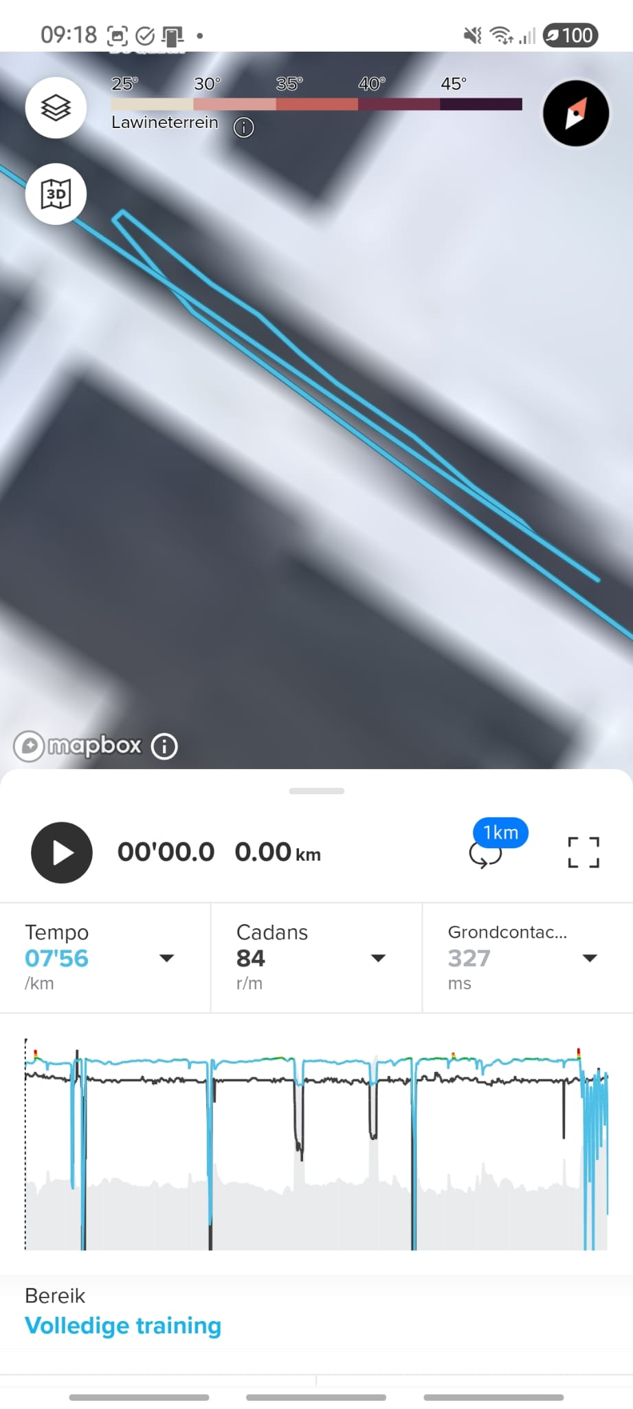

      Yesterday I had this weird bug on my Vertical 2. I was doing a 16 km run. And everything was fine. I had installed a route with no overlapping points. On the run I decided to make an extra lap in the forest. The consequence was that I had to ran the first km again. That’s never a problem.
      On my watch I saw a few times that I ran – min/km. So I was scared there was some GPS-connection loss. I also saw the km was a bit too high. I know that last km, but it measured 1,5 km. Something was off.
      It’s a very weird bug. According to the GPX it looses connection. After 150 m it gets connection again but it measures me going backwards. That’s really odd to me. I don’t know when GPS could measure you going backwards. It’s hard to show since I tracked back part of my run, so there are overlapping lines. Only the one on the end didn’t have overlap, so I have attached screenshots. On strava I could show the direction and on Suunto I could zoom in better. Keep in mind that the Suunto-screenshot is a bit tilted. It happened 7 times. It stopped because I was home.
      Question: Has someone encountered the same problem? Could it be triggered by going backward on a route? Because the problem started immediately when I got back on route. Maybe my watch thought I would go in the opposite direction.
      I do not hope it’ll happen again. It’s quite a severe bug. This time it didn’t affect me much, but another time it might be different. It’s the first time in 27 activities and I haven’t done an activity since. I already did do a soft reset yesterday 😜

                @Horizontal_2, I agree. Normally, recorded GPS track should be completely independent from the followed route. Did you use “snap to route” option by any chance? Also, what battery mode did you use?

                  @sky-runner Thank you for your response. I couldn’t react since I can’t log in on my phone. I was away a few days.
                  I didn’t use snap to route. I was just following my route and decided to go different. I just ignored my watch and didn’t change a thing. Battery mode was performance mode.
