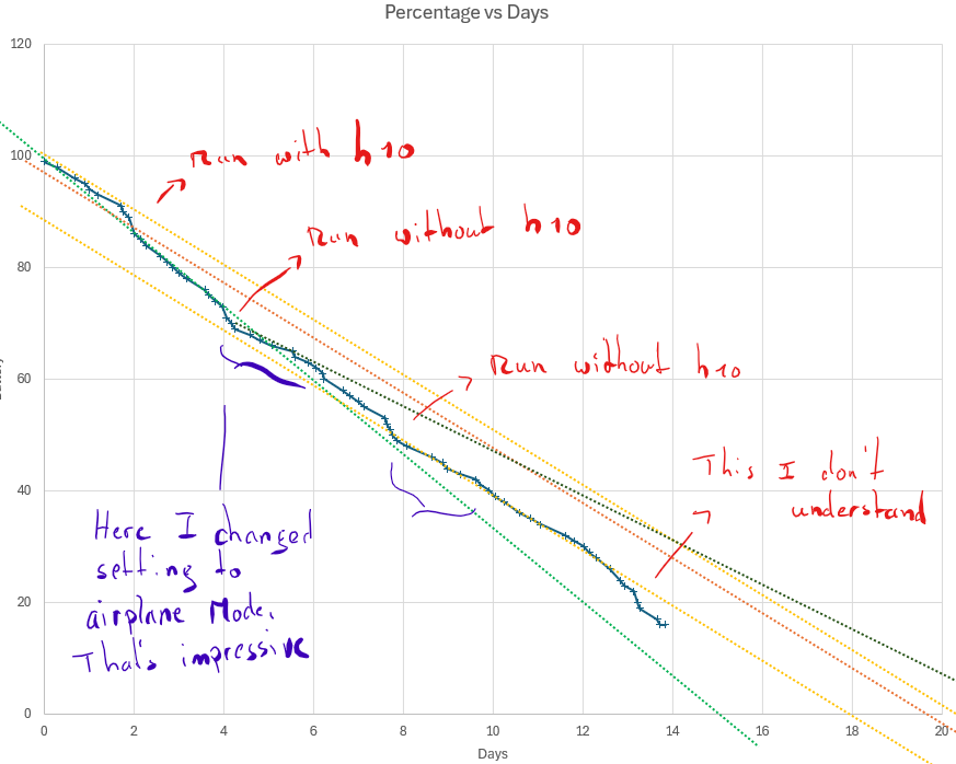

      I logged on of my cycles (14th - 28th of november).
      I haven’t got much time to analyse.
      Vertical 2 - Titanium
      Settings:
      • Raise to wake - display only
      • Brightness - low
      • notifications off
      • Airplane mode on and off
      A few observations:
      • Most of the times my vertical 2 gets it’s 5% per day
      • Soft reset doens’t help always. Tried it many times when after my first run the battery kept draining. That’s why I tried the Airplane Mode.
      • Airplane Mode does always help, and it’s amazing. I get 3,7% per day. But you should think about the next things: turn it on for a longer period (I used at least 6 hours), toggeling doesn’t work. And turn it on and off in the settings, not via control panel). So here is a feature request: update only a few times per day.
      • No use of a HR-belt helps! But I think it’s a big miss. It doesn’t work always. It seems like there could be a drain after a run without HR-belt (H10)

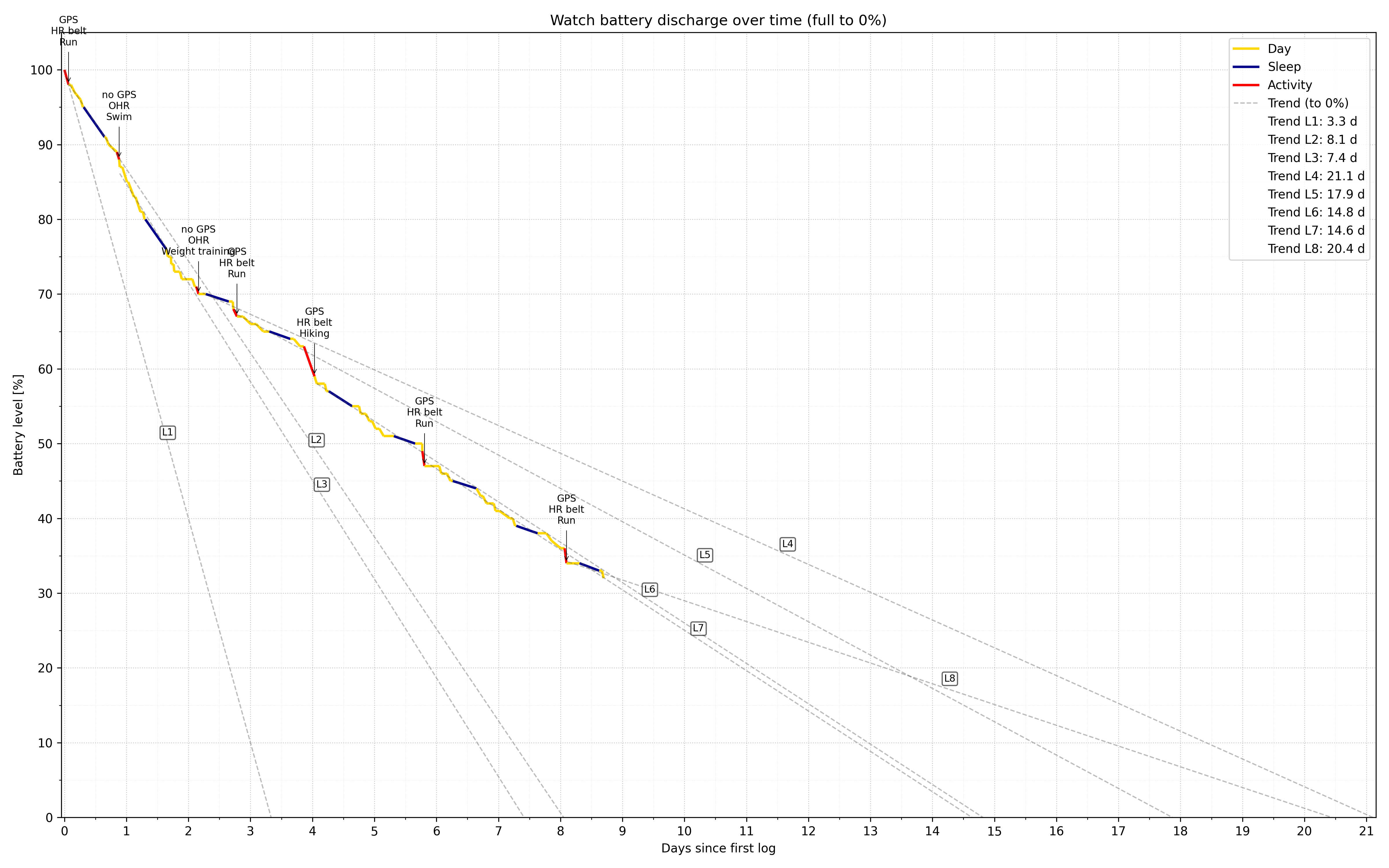

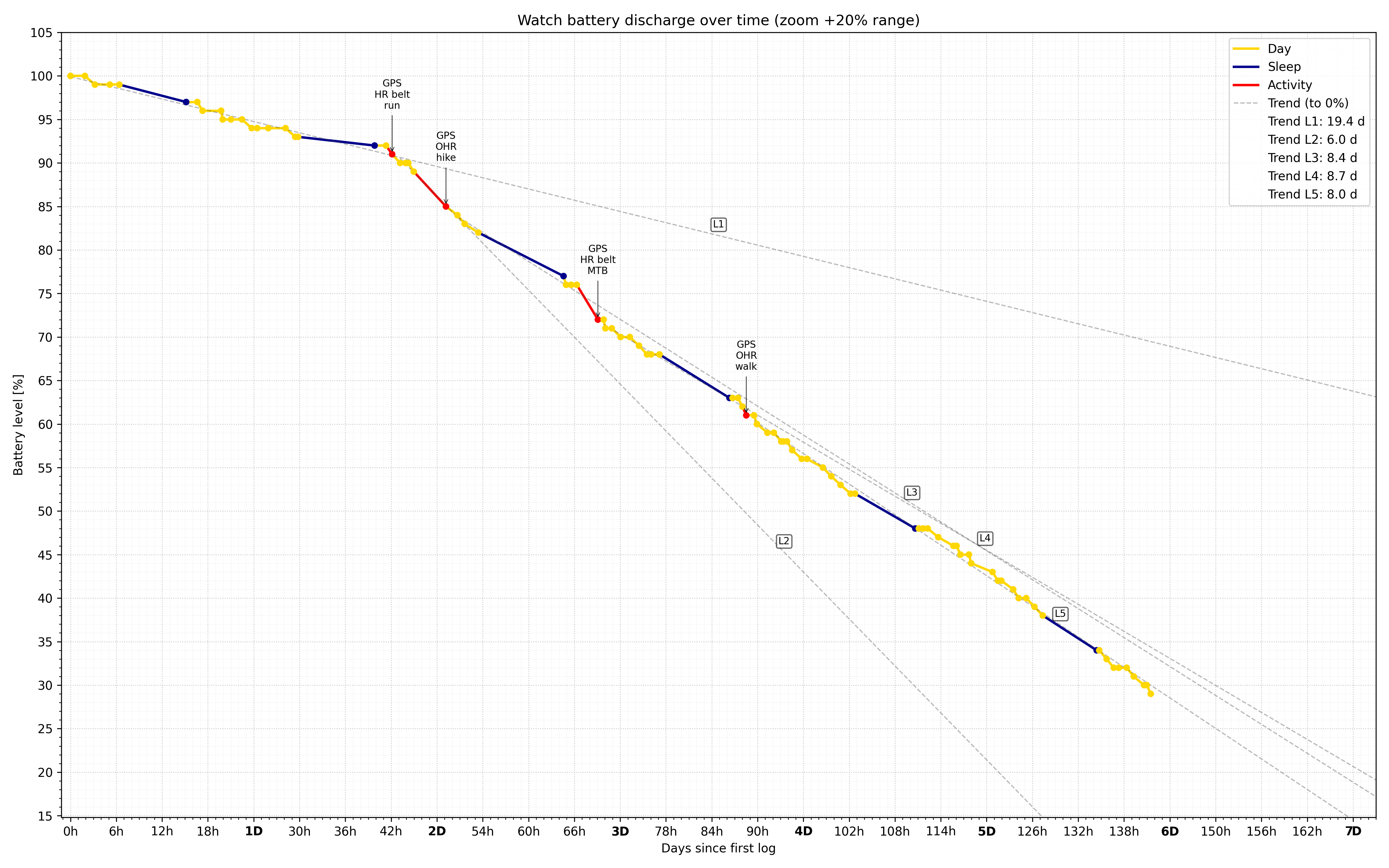

        I am attaching my observations and measurements.
        I have already completed two cycles from 100% charge to the next charge.
        In the first cycle, there was an interesting break in consumption after the first recording of activity with the Suunto Smart HR Belt (I later bought a new chest strap).
        In the second cycle, the exact opposite phenomenon occurred: after a sharp discharge, a change occurred and the discharge slowed down.
        In addition to the soft reset, I removed the old paired HR belt at that time, as during one activity, the connection with the new HR belt did not start up.
        I would like to add that before the last update (2.48.16), when using the watch a little more, I charged it after 10 days when the battery level was slightly above 30%.
        Otherwise, I didn’t change my usage. I had continuous heat measurement, sleep tracking, smartphone notifications, brightness = medium, and Raise to wake = Low turned on.

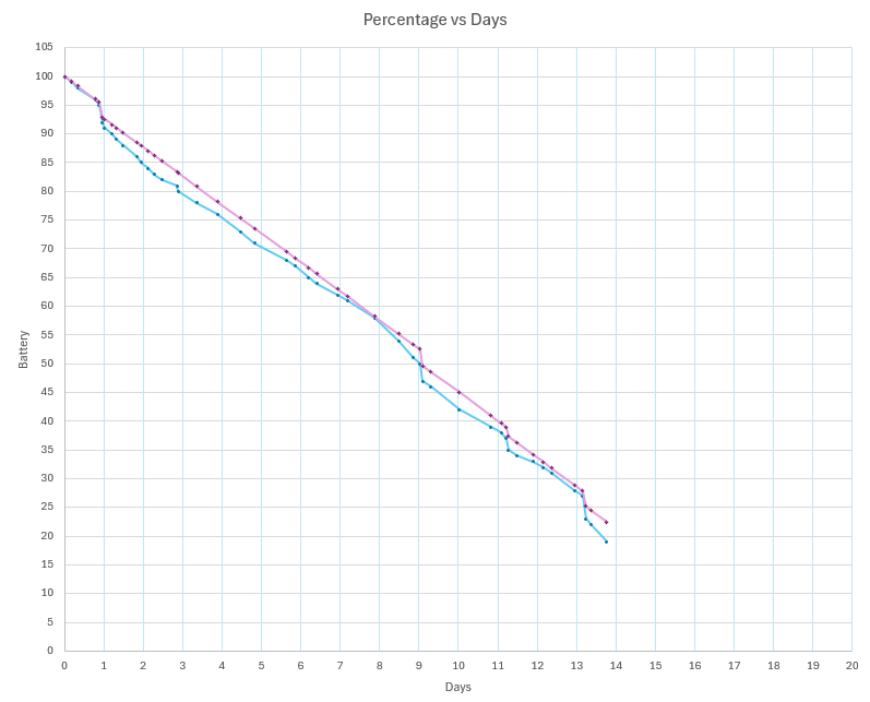

          I’m now down to a cycle without obsessive looking at the battery.
          It’s been 10 days and I’m at 22%, I’ll do a run this morning and charge it.
          Vertical 2 - titanium
          • Normal daily use: 6% per day
          • Maximum daily use: 12,5% per day
          • Running without HRM: 2+% per hour
          • Acitivity time: 6 hours (4 times of running)
          I think it’s good. The first 48 hours I used the watch intensively using the flashlight a lot. I also wanted to measure an improvised hottub (which got to 40 degrees Celsius), so the screen was a lot of time on. In those 48 hours it lost about 25%. So that’s 15% extra (keeping in mind it should drain 5% per day).
          The rest of the week I was using the ‘Simplicity Analog’ watch face and R2W - Fully activated. I do this since I like Analog watchfaces more, but I do dislike the AOD-versions of the analogs. Notifications are on, but only when I’ll be called.
          I’m loosing like 6% per day without sports and not so intensive use. I think that’s what it supposed to be like.
          In sportsmode it’s a bit different. Running 1 hour drains 2 %. The third percent mostly comes within an hour. So it drains a bit more than expected. IF I would ever do an 40h event I would bring my charger. Doesn’t really care if I use navigation or not at all. In januari/februari I’ll do a 2-day hike. That should make things more clear on this subject. I do not dare using the HR-strap again until the next update. I’m done with the whole resetting.
          So the drain is OK for me. Still not really blown away. I was hoping to get easily over 14 days. I have to fight for that. Still it’s far above my user case. Next charge after today will be just before Christmas 🙂
          sky-runnerS 1 Reply Last reply Reply Quote 0

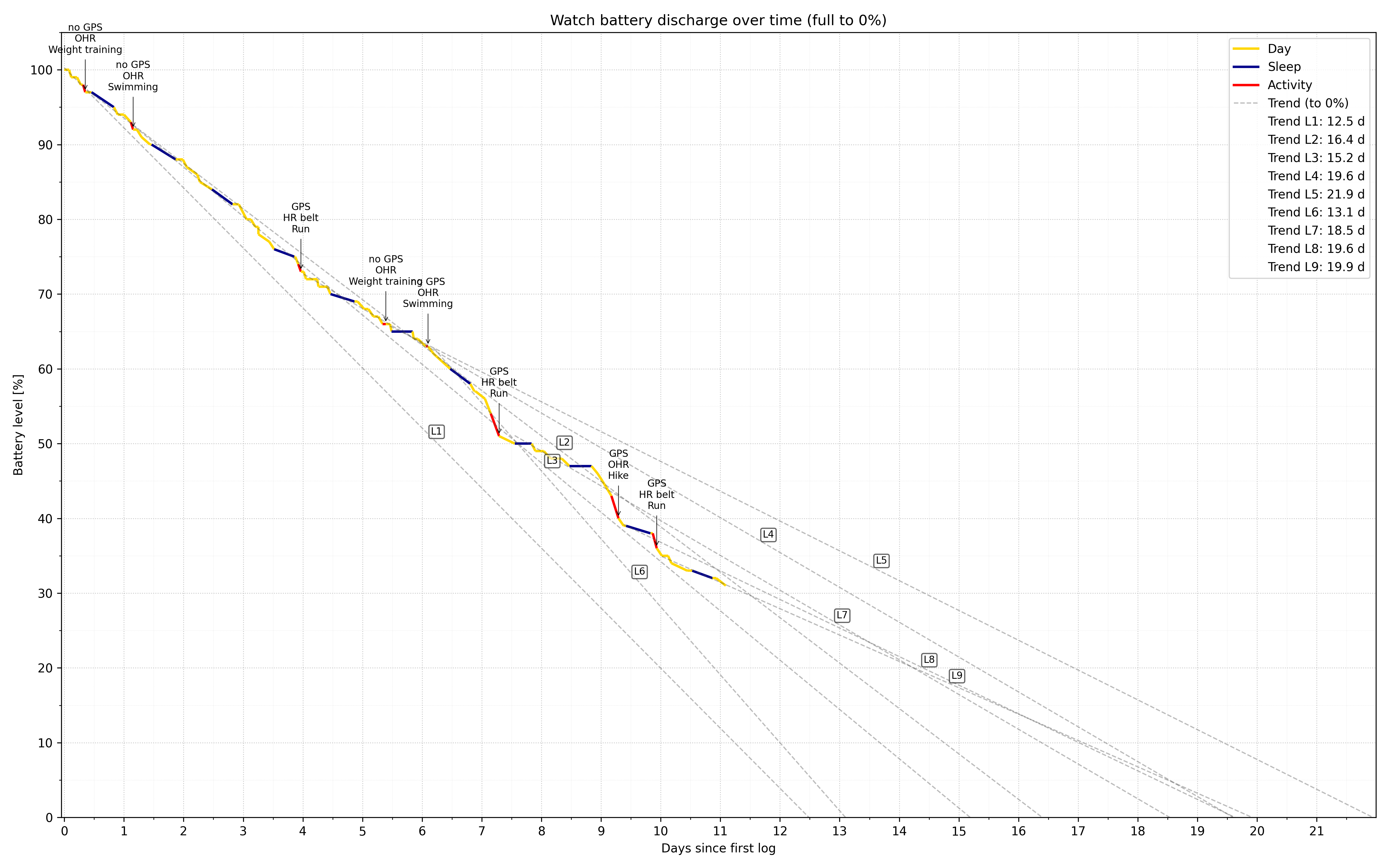

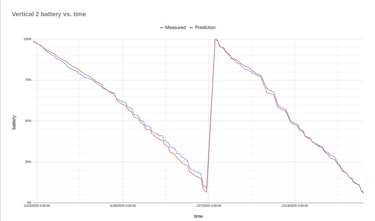

              Posting my experience here too. I continue to monitor in my next charging cycle. I have a feeling that the slight drainage increase that I experienced in the last day or so of the previous cycle continues but too early to tell for sure.
              Here is my recent battery experience with my Vertical 2.
              Over the past 14 days (and a bit) I managed to do 19.5 GPS+HR activities and drain 91% of my battery.
              I built a simple prediction model for battery drainage rate assuming that there are three different drainage rates: During GPS+HR activity (running and cycling in my case), during sleep (DND) and while idle (with notifications and raise to wake variations). Under these assumptions I tried to approximate the drainage model as close as possible to the battery levels and activity times I recorded during the day and came up with the following numbers (they imply slightly less than 5% per day without activities and more than the spec 65 GPS hours):
              Sleep tracking rate: 0.11%/h
              Non activity rate: 0.25%/h
              GPS Activity rate: 1.16%/h
              Flashlight rate: 20%/h
              The above model worked very well during most of the two weeks until the last day or so when the battery got to about 20%. From that point it seems to drain faster than my model allowed. In fact, until that point, the model showed about 1.07% drainage per GPS hour which I updated to the higher number above to compensate for the end.
              Settings:
              AOD OFF
              Raise to wake: Display only
              247 HRM
              Notifications ON
              No external BT connections except Android Suunto App (6.4.7)
              Wireless OFF
              BT discovery OFF
              Brightness LOW
              DND from 22:00-5:40
              Sleep tracking on with HRM but without SPO2
              NO USE OF FLASHLIGHT
              segi_pnS 1 Reply Last reply Reply Quote 2

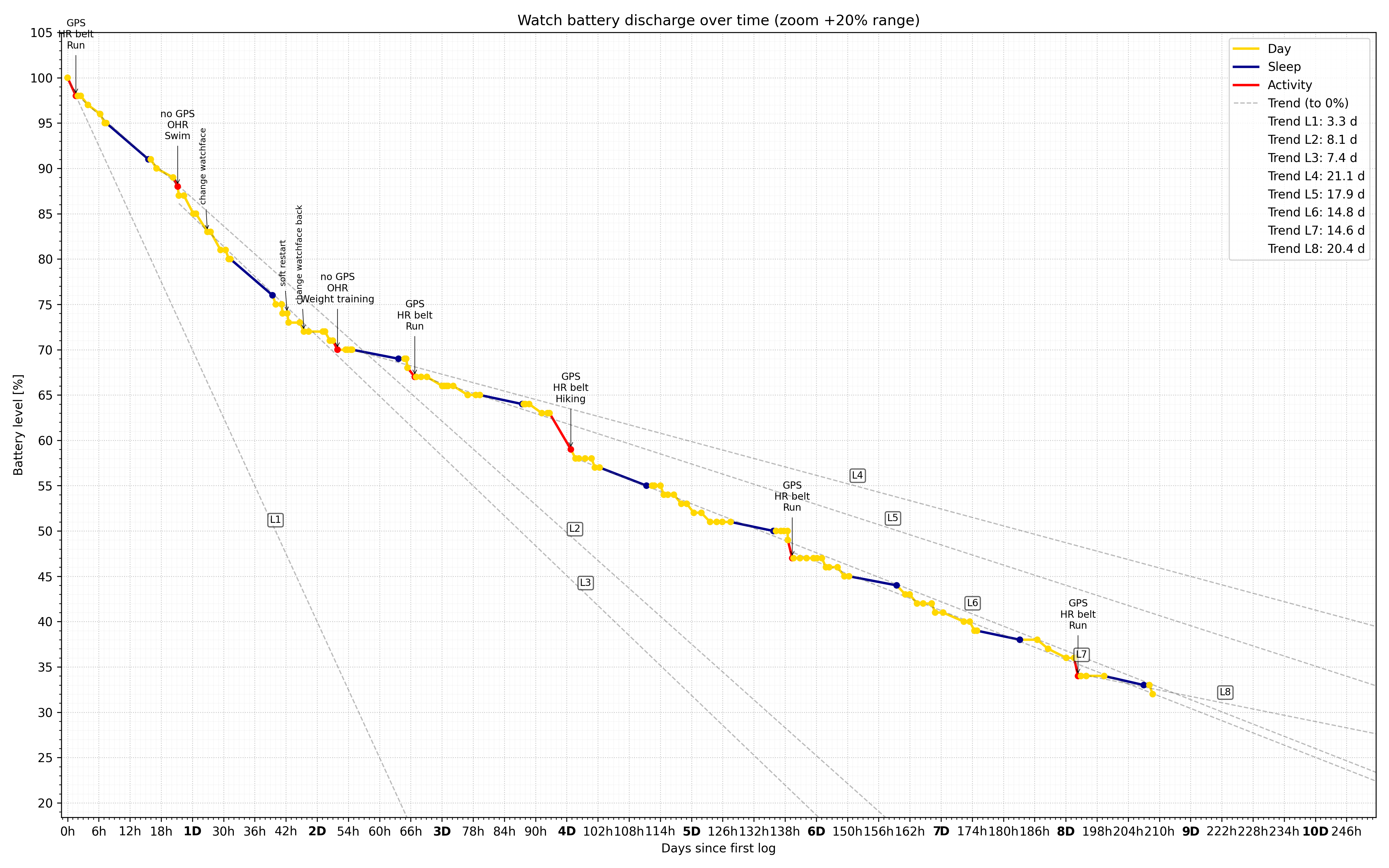

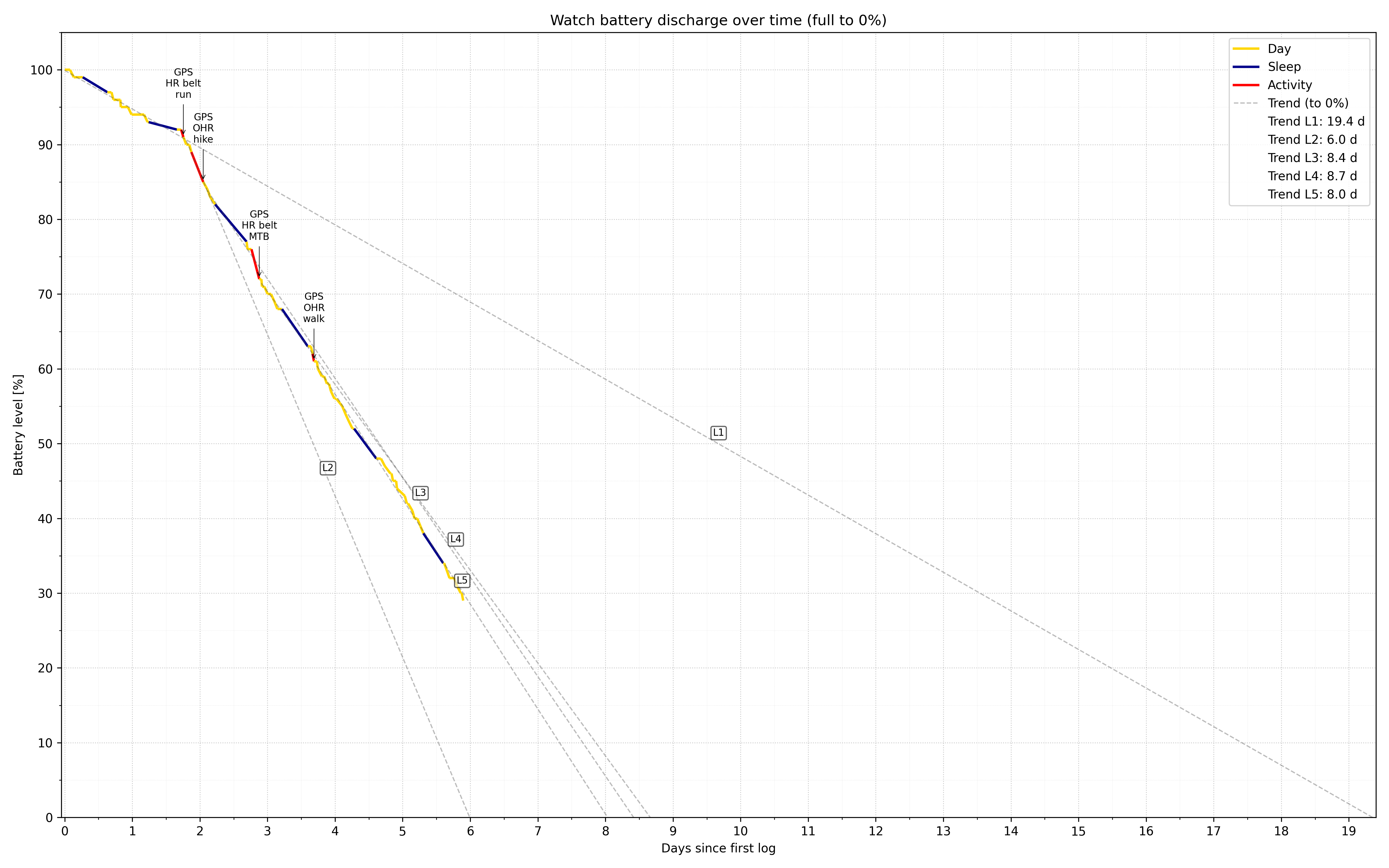

                I am attaching a graph from cycle 3.
                Since the improvement in consumption in cycle 2, it appears that this trend is continuing and battery life is the same as before.
                I conclude that this is due to the removal of the paired chest strap and then a soft reset (holding the top button for 10 seconds).

                        Update on my battery consumption model:
                        Some of my GPS activities seem to consume relatively more battery than others. In particular, it seems that Mountain biking consumes more than running or bike commuting?
                        Vertical 2, firmware 2.48.16 ran from a full charge down to 7% in 12 full days with 28:45 hours (!!) of cumulative GPS activity (biking, running, mountain biking).
                        The corresponding model that was very close to this (and my previous charge cycle):
                        Sleep tracking with DND rate: 0.11%/h
                        Non activity rate: 0.24%/h
                        GPS Activity rate: 1.50%/h
                        Settings:
                        AOD OFF
                        247 HRM
                        Notifications ON
                        No external BT connections except Android Suunto App (6.5.9)
                        Wireless OFF
                        BT discovery OFF
                        Brightness LOW
                        DND from 22:00-5:40
                        segi_pnS Horizontal_2H 2 Replies Last reply Reply Quote 0

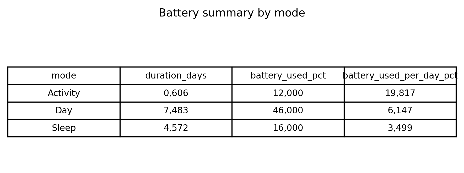

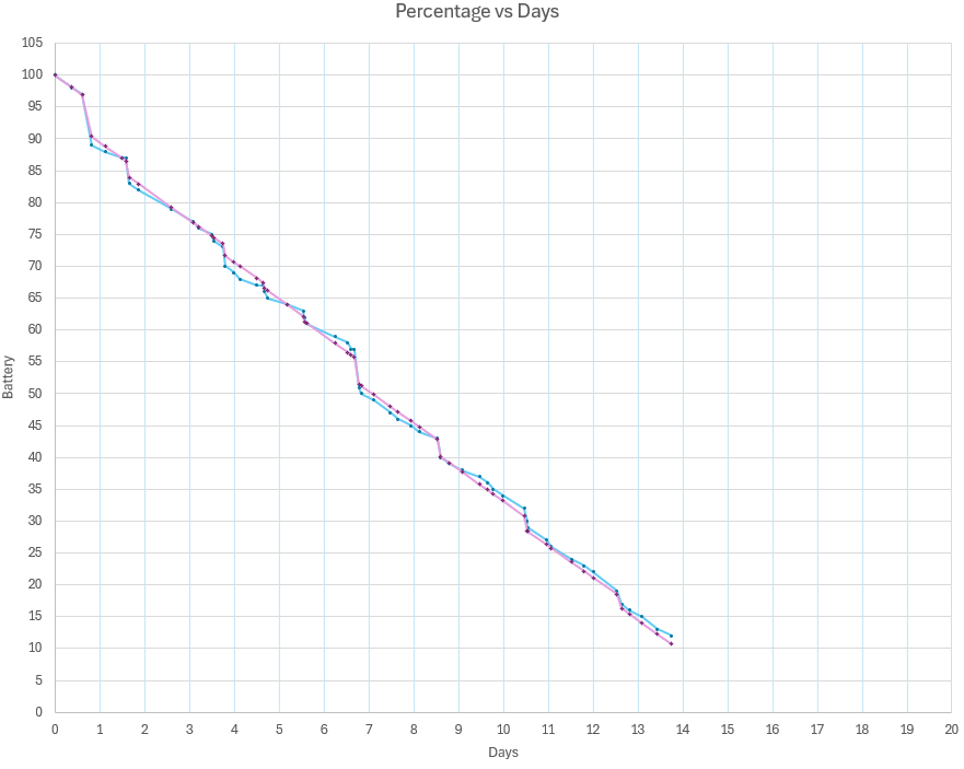

                          I can provide a summary of battery consumption on Vertical 1 from the last cycle (the third cycle).
                          Mode Consumption Notes
                          Activity 20,492 %/day (0,854 %/h) mainly GPS, HR/OHR, no maps
                          Day 6,794 %/day (0,283 %/h) notification, OHR
                          Sleep 3,959 %/day (0,165 %/h) DND, OHR
                          Suunto Core (17y)
                          Suunto Vertical Ti

                                        Last one (I think 😊). The blue line is measured. The purple one is the model! It was hard to train during these holidays. There were 6,5 hours of training this 2 week period.
                                        Okay, this is pretty alright. I think the battery isn’t draining linear with the percentage. I’m really satisfied right now! I was a bit down when the battery was so low this morning. It’s on the charger right now
                                        Sometimes it does like there is more drain that expected. After the first run and the last run. I’ve resetted the watch and for a few hours on the Airplane mode.

                                          Last one wasn’t the last one. This time it was a bit worse.
                                          Still the H10 seemed cuasing promblems. around day 10 I did a long run with the H10. That caused a lot of drain afterwards. Does anyone else still has that problem? That night I forgot the H10 on my watch. Did a soft reset and swore never use it again 🙂
                                          Also many runs drained more battery than expected. Might be due to the many SuuntoPlus Apps + maps. I’ll try running with less apps 🙂 .
                                          I used the flashlight of the Vertical as minimal as possible. In these 12 days I’ve been using GPS for running for 10,6 hours.

                                            @Horizontal_2 I just finished a two week cycle including upgrade mid cycle to the latest hotfix.
                                            I managed to get 14 days with 26.5 hours of GPS (running and cycling) on my Vertical 2.
                                            I’m very happy with that. I used some navigation in runs and almost never used the flashlight. Only OHR without external strap.
