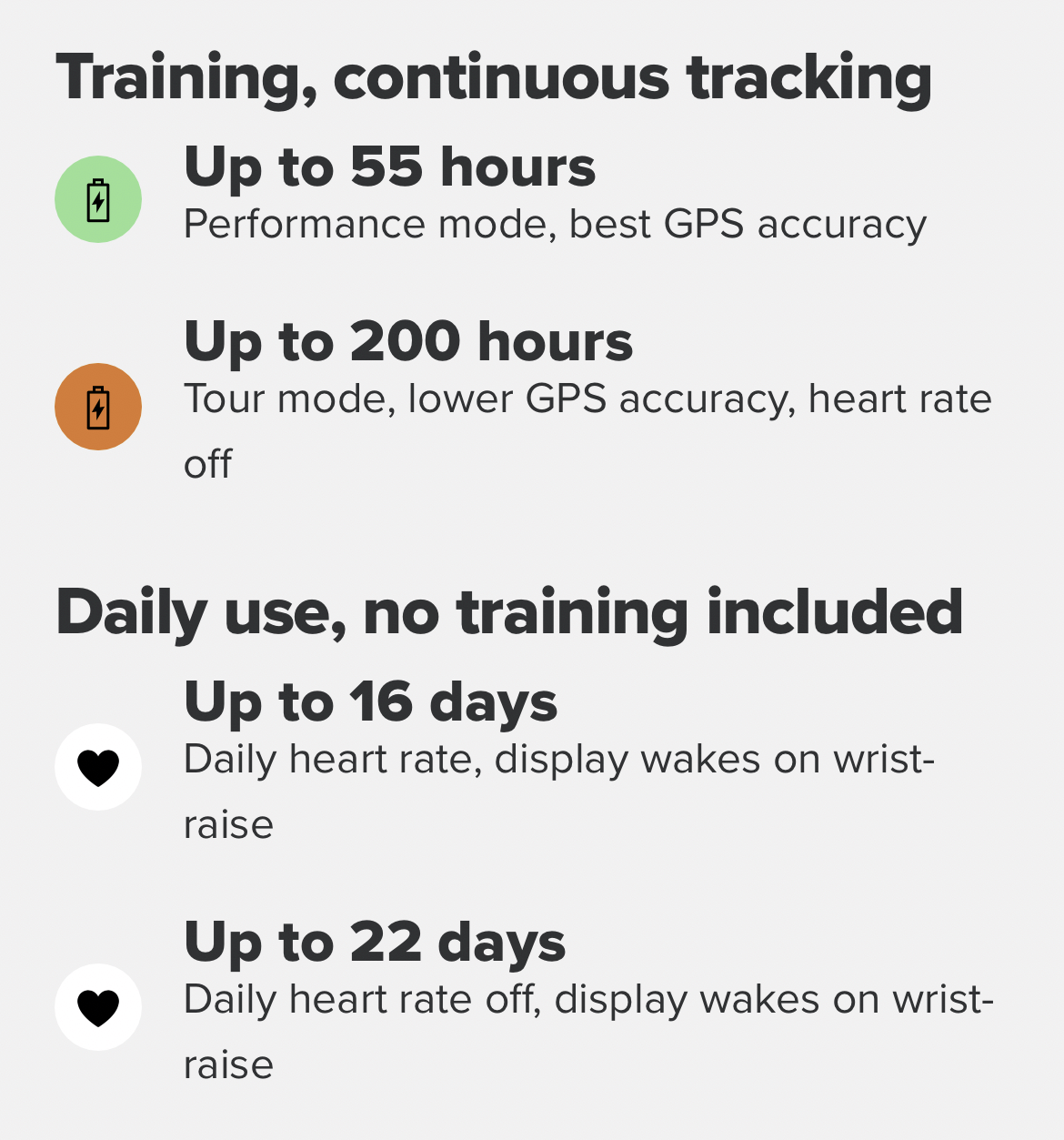

      Based on data on website
      we should expect discharge around 1.8% each hour during GPS activity. And around 0.26% per hour during smartwatch with tracking enabled. And it says “up to” so i expect this numbers to be in best case scenario. And page not specify if sleeptracking and bloodoxygen tracking is taken to 16day battery life.
