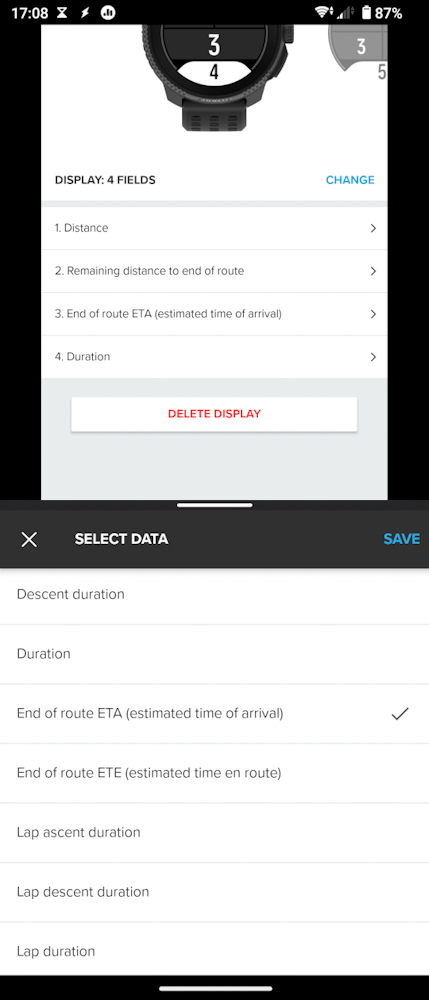

          • Stefano M64S Offline
            Stefano M64 Silver Members @Bogdan1921
            @Bogdan1921 said in Software Update 2.44.46 (2025 Q3):
            it’s annoying to make the custom sports again and again
            definitely, I made screenshots of the different displays of each customized activity, so that with the help of the splitted screen option in Android is easier to recreate
            Suunto Vector . Vector HR . Core . Race & Race S
