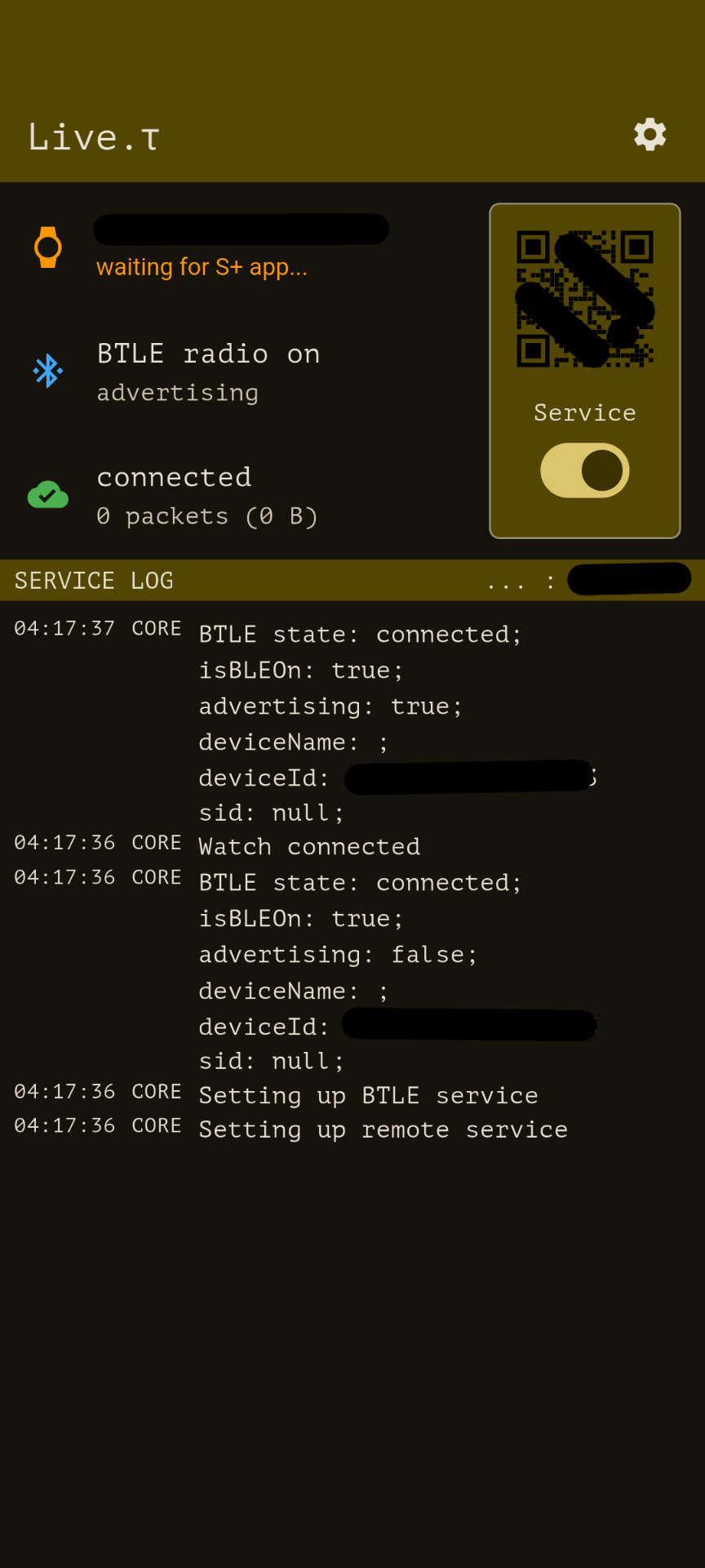

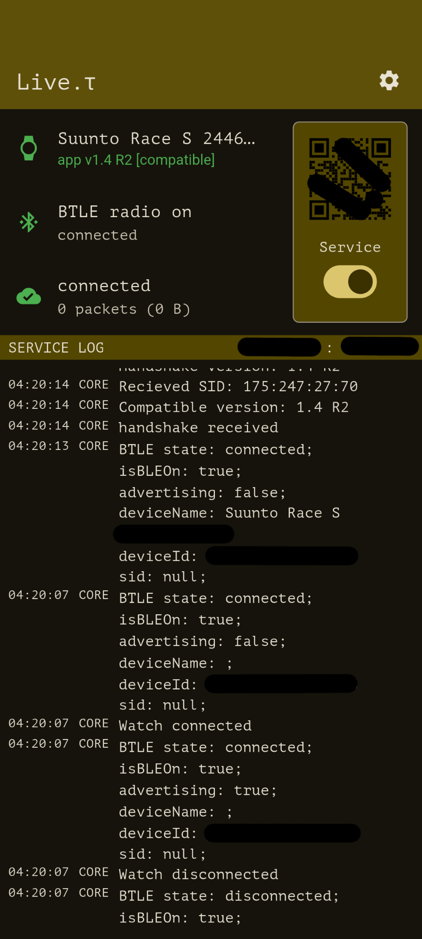

      Then fire up the mobile app first before starting the activity on your watch. Then pick your activity and enable the LiveTracking app on your watch in SuuntoPlus menu item. Once enabled, wait for all green in the mobile app before starting:
      • Watch connection
      • BTLE connection
      • Remote connection
      I wish this was a little more obvious. With the service log, there is a lot of text on the screen, so the three connection text in the upper left corner can get lost in the noise. I tried sharing the live tracker with two previous runs, but I didn’t pay sharp attention to everything on the mobile app screen, and as such didn’t share my live location with family and friends. Once I knew what to pay attention to, I was good.
      I would recommend hiding the service log unless it’s needed for troubleshooting or debugging with users. Then make the necessary connections more prominent in the app, perhaps larger square areas that change to green when connected.
      • Screenshot of LiveTracking app, service disabled

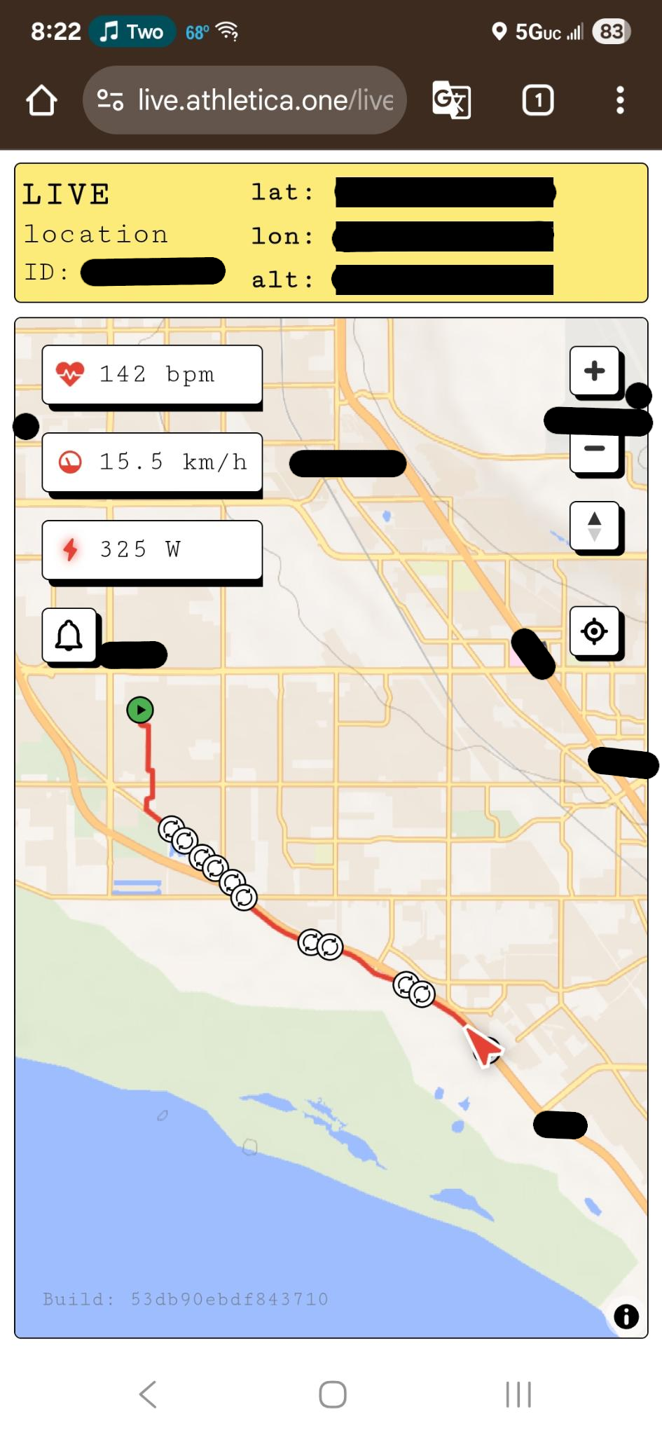

      Once you’re out in the run, ride, etc. the tracker in the web page will show your HR, speed, and power, depending on what’s paired with your watch. I had all the devices paired during my run and they displayed correctly on the web page.

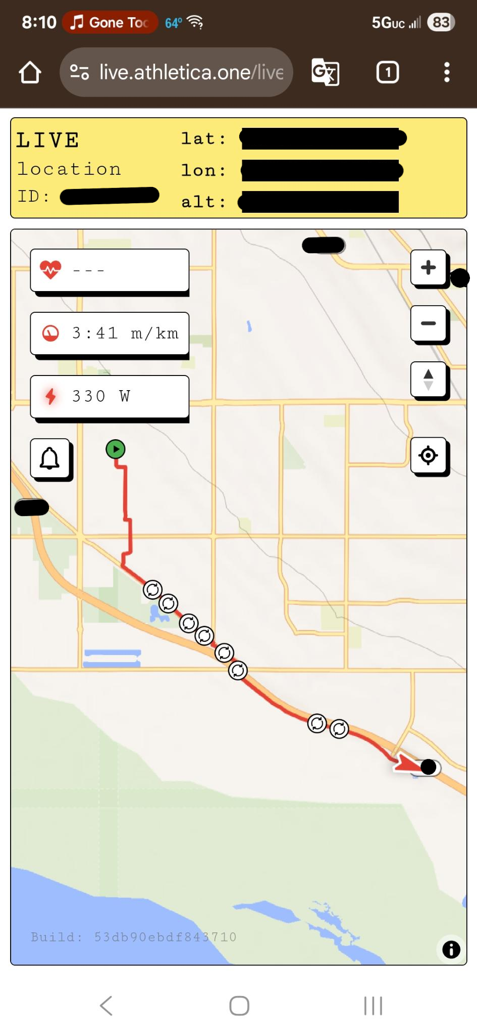

      However, my HR would blank out randomly for a second or two. I haven’t ever noticed on my watch, so I don’t know if the watch is overpowered with BTLE connections which is causing problems for the mobile app pairing, or if there is a more fundamental problem between my watch and HRM connection. I’ve just never seen it blank on my watch display.
      • Screenshot example of missing heart rate
      • Screenshot example of present heart rate
      The speed on the page would flip back and forth between “km/h” and “m/km” (assuming minutes per kilometer). Also see the screenshots above for speed/pace differences. Because the activity chosen on my watch is a run, the speed should probably be in the more canonical minutes/km. If I were cycling, km/h would make more sense. However, as a Yankee, it would be nice to flip to imperial units. At least until we can catch up to the rest of the world with metric (one can hope).
      The web page shows your current latitude and longitude, but doesn’t show how many miles or kilometers you’ve traveled in total. It would be nice to tell my family or coach “my run is 10 miles along this route” so they know what to expect.
      I like that it shows where laps were automatically incremented on the map or when I pressed the lap button. Again, telling my family or coach “I’m running 6x5:00 intervals” can help them know what to expect when they see high HR values, for example.

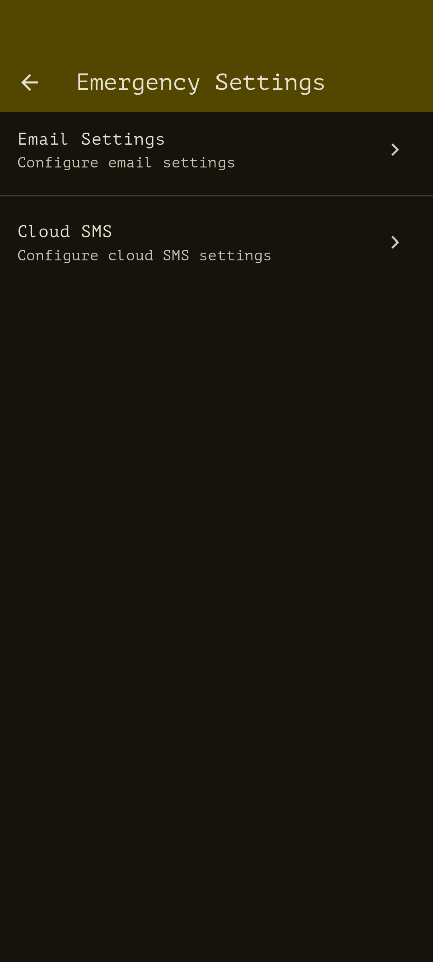

      On the watch, the S+ app has an “SOS” button. In the mobile app, you can setup emergency contacts to be contacted via email and cloud SMS. On the watch display, the bottom button is dedicated to sending the SOS alert. It must be pressed for at least 2 seconds to send the alert. I haven’t tested this, so I don’t know if it asks for confirmation or immediately sends out the alert to your contacts.
