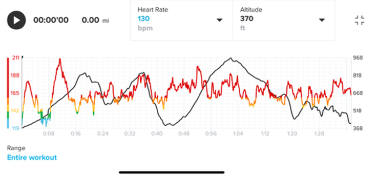

      I’ve been getting unreliable readings from my smart HR belt, which is now over 10 years old.
      I tested the belt resistance with a multimeter and it’s still under 10kΩ — it used to be under 1kΩ, but now reads around 7kΩ.
      I’m considering replacing the belt, but I’m concerned the issue might actually be with the sensor module.
      Has anyone replaced the belt only to find the module was the real problem?
      I’d rather not buy a new belt if I’ll end up needing to replace the whole set anyway.

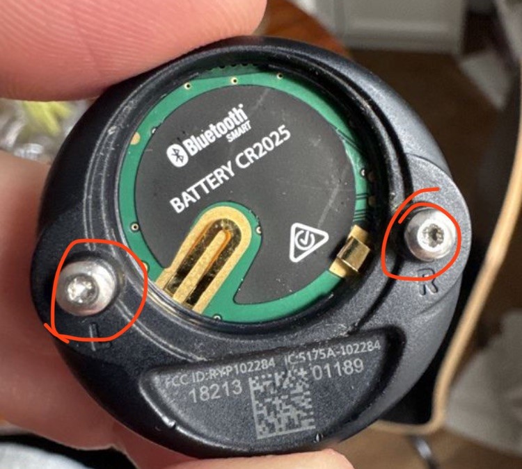

          Check the area around the pins for cracks.
          If there are any cracks, moisture may have gotten inside, which could cause measurement errors.

            Yes, exactly this happened to me.
            Purchased a replacement belt, as it was a few years old and this had previously been the root cause of the issue, but turned out to be the sensor itself.
            On closer inspection I did find some moisture inside the old sensor.

              Thanks all, I’ve checked the sensor & all looks ok with that so I’ve ordered a replacement belt.
