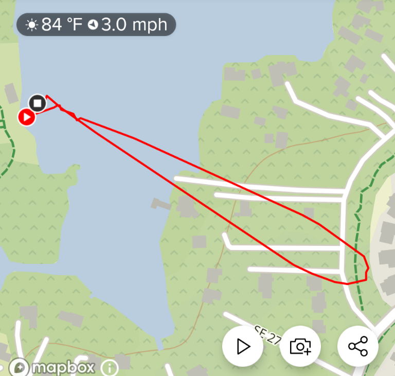

                    In case anyone has forgotten what a good OWS track looks like, I used… another watch yesterday. I was using my FORM goggles, with their swim straight feature (shows a compass heading live as I swim, so I can be confident of swimming in a straight line).
                    My inflammatory post aside, has everyone logged this with Suunto support, with a reference to this thread?

                            I am not a good swimmer, but I tried a short open water swim yesterday - my first with Suunto - and it was a complete failure.
                            If I bought this watch for swimming, I’d be very disappointed!
