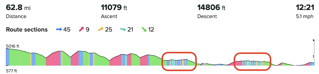

      But let’s take a looks at what users like me may encounter in reality. Here is a profile from my recent 100K race - note that the projected total ascent is 11079 feet:

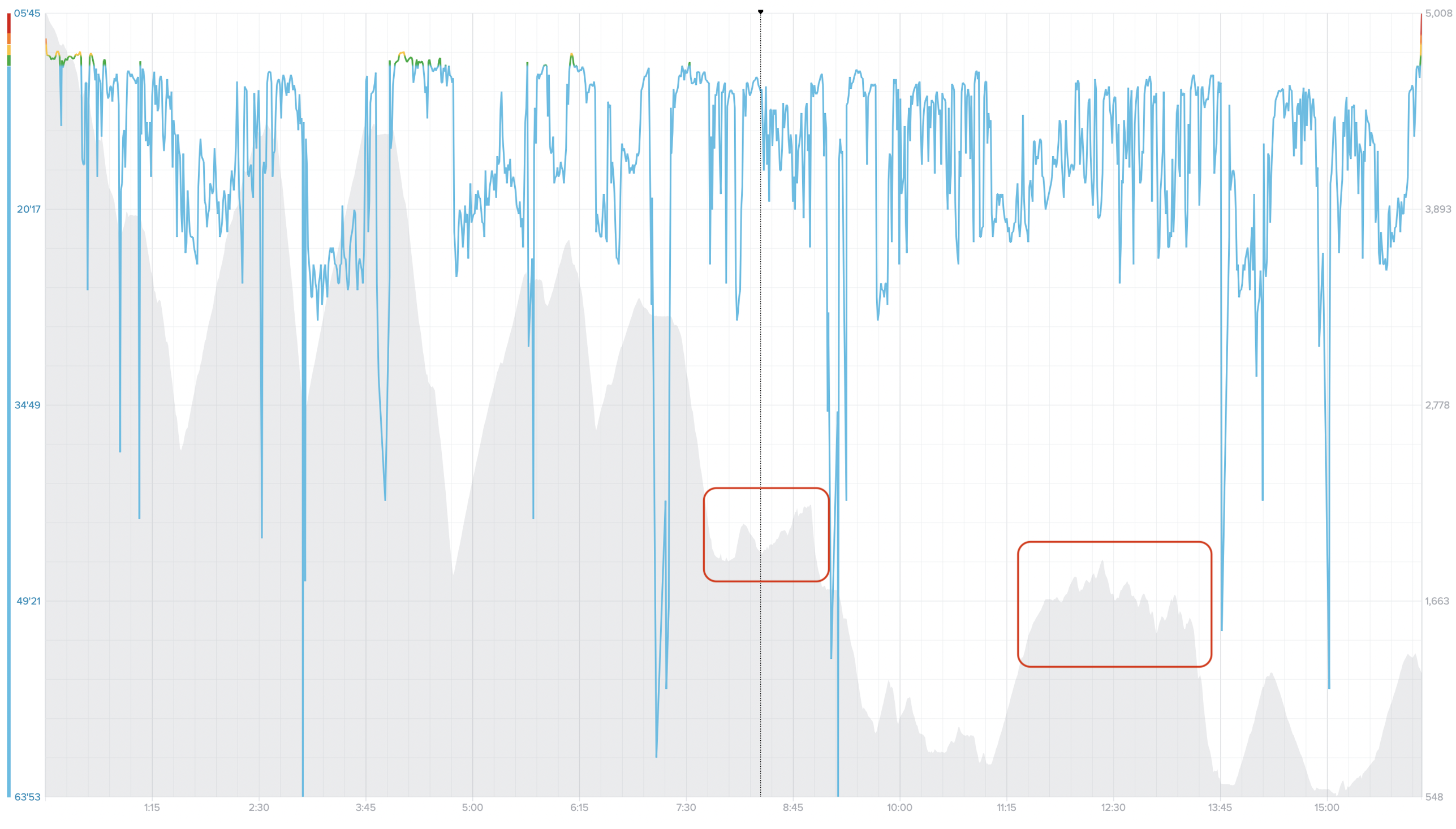

      Here is what the actual elevation profile was after finishing the race - the actual total ascent was was 13055 ft, which is 18% more than projected:

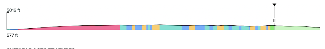

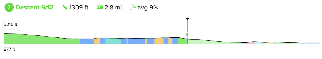

      Now let’s zoom into the two segments where I had the most frustrating experience with the climb guidance vs. what I actually experienced - they both are highlighted on the pictures above.
      [1]:
      [2]:
      What we see in this zoomed in climb guidance profiles from the app and what I have experienced during the run is that it tends to break the elevation profile into sections based on average grade rather than the actual lowest and highest points in the route. What that means is that:
      1. Every climb always start a bit too late - usually I am already climbing for 1-2 minutes before the climb starts in the climb guidance, and that is worse on rolling terrain. That is probably because it takes some time for the average grade to change.
      2. Similarly, every descent ends too early. Often it tells me I have reached the end of the climb, but in reality I may still be halfway through the climb, perhaps with a bit less steep part of it ahead of me.
      3. It has a tendency of breaking long climbs into seemingly arbitrary sections. For example it may tell me a tiny 27 feet climb is coming. But then when it ends it immediately shows another tiny climb, then another, even though they all a part of a longer climb. It may arbitrarily break a longer climb into multiple fairly short sections of steep climb, less steep climb, a flat section which is in reality continues climbing, then another less steep climb, etc.

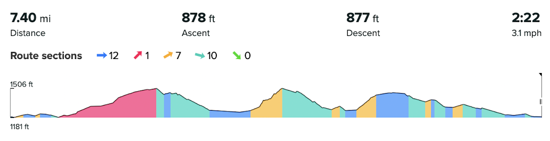

            Here is the route profile from my today’s run - as planned:

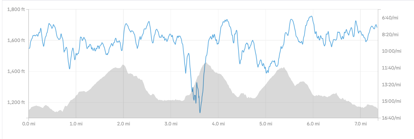

            Here is how it actually was recorded and shown in Strava - I ran the route exactly as planned:
            What I don’t find right:
            1. Why does the second climb show as yellow (uphill) vs. the first climb shown as red (a true climb)? I thought that was based on the grade! But the second climb is clearly more steep and we can see that in Strava’s screenshot. The app shows the first one as being 4% (321 ft in 1.4 miles). The app doesn’t even show the grade for the second one because it is a mere uphill, but in reality it is about 11-12% (248 ft in 0.4 miles according to Suunto App route shown above). If that is based on the distance or some other criteria, I find that arbitrary.
            2. Why the third climb is so different between Suunto App and what was actually there. During the run, the yellow uphill segment had finished about halfway through the climb, and then it showed the rest as a “flat” blue segment, but in reality I continued running uphill, although it was a bit less steep. The shape of the profile looks quite different too between Suunto App and Strava. But what I really want to see in the climb guidance is an entire climb being included - from the lowest point to the highest point. If the grade changes during the climb, that can be shown with the color the way that is done in the overall profile. In other words, I think the 3rd climb should be shown on the watch as something like this:
