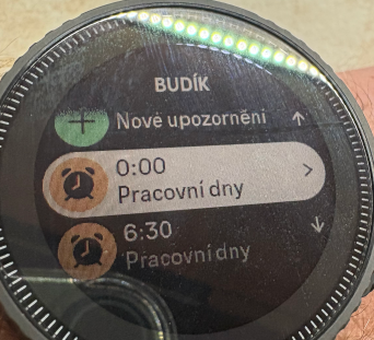

          Even more strange situation. My alarms are set to 0:00 and 6:30, both only workdays.
          At midnight it was not trigerred, however at 00:08 there is still 0:00 given on my watchface as the next set alarm - this is wrong, since that time there should be 6:30 shown in the complication.
          A few seconds after taking this photo the time shown in the complication changed to the following set alarm, which is expected behaviour.
          Now there are no alarms on my watchface now, which is correct (TGIF).
          @isazi What else can I do, please, so that this problem is officially reported and worked on?
          Thank you for your support.
          MIlan
          isaziI 1 Reply Last reply Reply Quote 0

            @Milan-Šádek this is just refreshing, in do not disturb mode the MIP screen and complications are refreshed less often, so values can be wrong if you do not press a button and wake up the screen.
