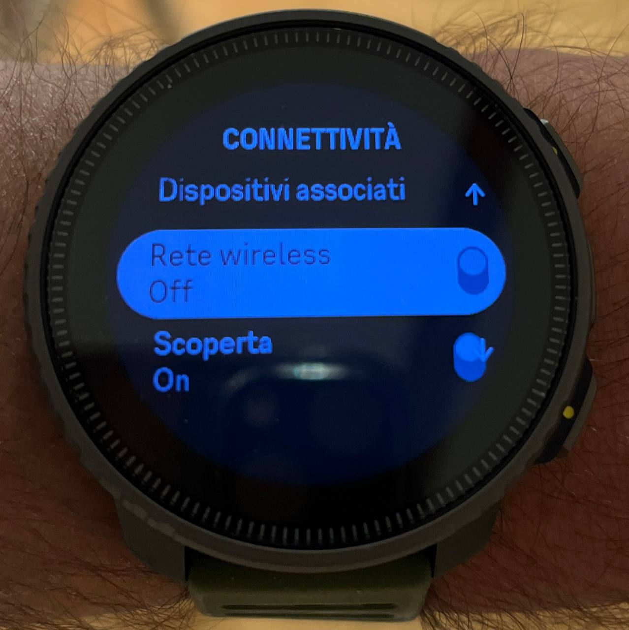

      Hello, thanks for your reply.
      WIFI is 2,4GHz (and not 5 GHz which is not supported by the watch), Wifi is activated on the watch as well as Discovery mode, plane mode is off… I tried many times, and it still does not work.
      Any idea?
      Thanks a lot, cheers

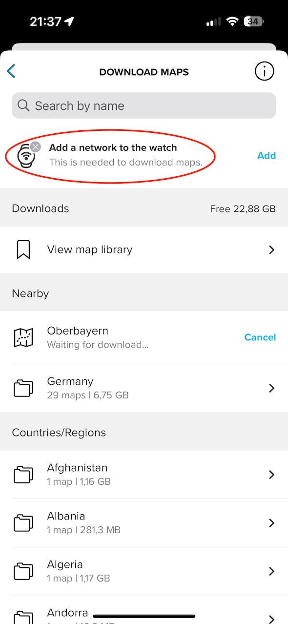

                                          I did a factory reset on my Race S, restarted the Suunto APP and restarted even the mobile phone, but I have the issue that the App is not remembering my Wifi and the map download cannot start.
                                          The Wifi I have connected uses 2,4 GHz, but for the watch it does not exist anymore. This is really annoying. The Software is 2.43.12.
                                          What’s wrong?
