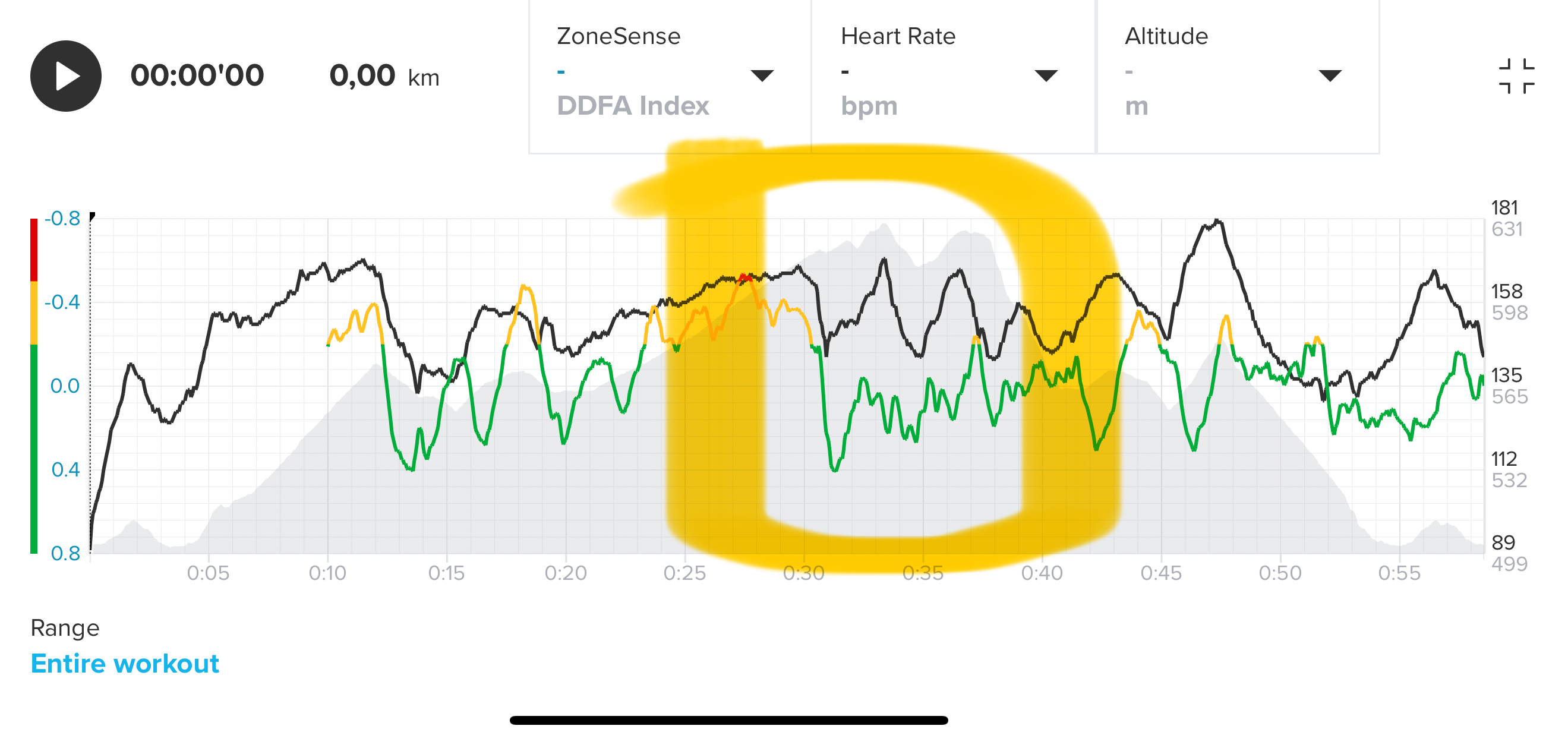

                        AntoniusGaius @thanasis
                        @thanasis said in Suunto ZoneSense:
                        @Brad_Olwin can you help me with why this happens ?
                        14e8b40b-6876-43a0-87c4-ea5dc0d9a958-image.jpeg 79713120-2a44-4be0-9d64-8afb52a96487-image.jpeg 12a5ebf9-0875-4828-8398-17b6dfeede65-image.jpeg
                        While the app seems to be running it also shows waiting for data
                        Also the there is a big difference in the data in the watch ( eg I had some 5-6min the red zone ) while in the app the duration is 0
                        Same here. On the watch it seems to work as expected but in app total different and nonsense. Maybe I dont get it right but, if this should be real time effort monitoring then what is post workout analysis for? At least it must be in line. For me real time is real time. One of this is wrong.
                        I did relatively high altitude hike with nice elevation gain, on the watch there were all three zones divided in thirds - which perfectly sits with my feelings. In the app red zone 0 min. In green zone 3:50 hour yellow 19 min. Hell no 🙂
                        On the same day run in the city with some steep uphills (I wanted push it really hard) Normal zones: zone 5 25%, zone 4 46%, zonesense red zone 1 minute 🙂 I was in red on the watch most of the time.
                        Zone sense is interesting concept but I will use standard zones as rest of the world does. Feel little bit scamed. I see, that lot of respected guys here have it working, but for me it is always very strange especially data in the app. If something is so extremely different you can hadly trust it.
                        I use brand new Polar H10 and in runalyze I have 0% of anomalies - so data correct.
                        S9PP and iOS app
                        SUUNTO M2 - retired, SUUNTO M5 with bike pod - retired, SUUNTO Ambit3 Peak Sapphire customized, SUUNTO Spartan Trainer - retired, SUUNTO 5 Peak, SUUNTO 9 Peak Pro Titanium, SUUNTO Race S
                        stromdiddilyS 1 Reply Last reply Reply Quote 1
