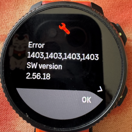

                              My Vertical 2 is for the last ± 5h since firmware update in a boot loop. Its either “The device is being restored to a safe state”, “Improving your watch for adventure”, or “This is taking longer than expected. Thank you for being patient”. It always ends at the attached error screen, which is hard to capture since it reboots again a few seconds later.
                              Not sure what to do now. no key combos change that, probably the battery will run out soon.

                                  @makoc maybe it is a good idea to contact support about this.

                                    @makoc there is a separate thread with the same problem… in this thread a possible workaround is described by @dimitrios-kanellopoulos
                                    https://forum.suunto.com/topic/15551/suunto-race-2-device-is-being-restored-to-a-safe-state-bootloop

                                      @SuperFlo75 I think I solved my own problem. But indeed the solution seems to be keeping up. And watch is still operational after a 2,5h ‘move’.
                                      @makoc ; seems to be the same error as yours, so give it a try. good luck. For me it took two days to have the bootloop drain all the power from the watch.
