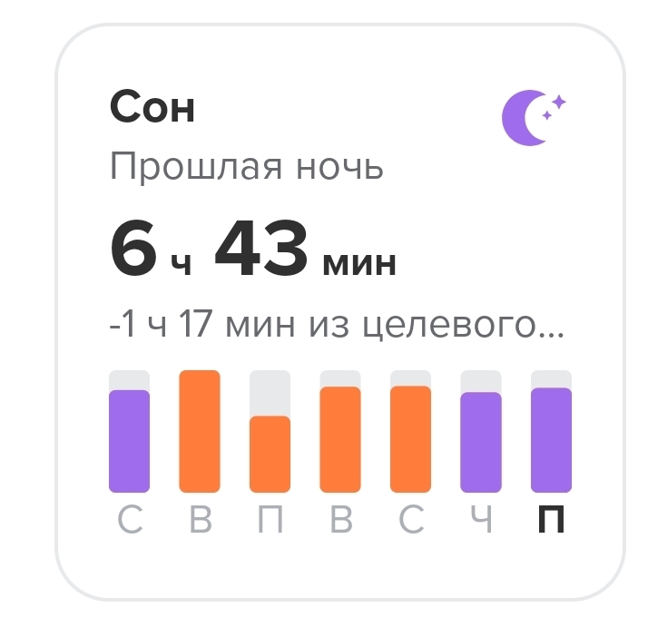

            • Александр ДаниленкоА Offline
              Александр Даниленко @Dimitrios Kanellopoulos
              @Dimitrios-Kanellopoulos
              I dont know what happened, but last 2 nights watches detect my sleep as a nap only:
              Also, not all the times, when I had a “nap” are correct on the watch - this happened before pretty often.
              Suunto Race S
              Manuel ExtremeM 1 Reply Last reply Reply Quote 0
              • Manuel ExtremeM Offline
                Manuel Extreme Silver Members @Александр Даниленко
                @Александр-Даниленко
                Check the heart rate monitoring. If you find gaps in the graph, it also affects sleep tracking.
                The interrupted monitoring is likely due to a sensor “sensitivity” issue that I have reported several times.
                        Александр Даниленко @Александр Даниленко
                        Still detects my sleep as napping 😅
                        Going to do hard reset. Soft reset didn’t help 🫤
                        Update 1:
                        Hard reset didn’t help:
                        Update 2:
                        Unlike hard reset, soft reset helped:
                        Suunto Race S
