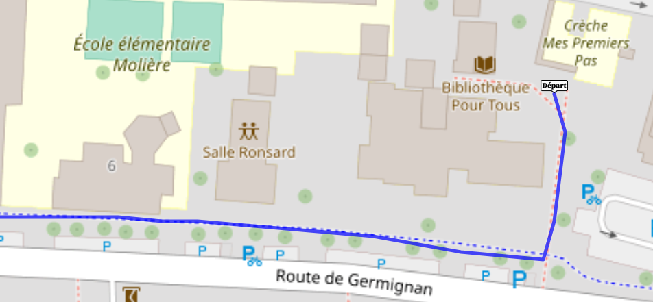

                            @Egika As planned, I did a test this morning with both watches at the same time. Here are the results.
                            Ambit3Peak:
                            Vertical:
                            As you can see, in the exact same condition, the Vertical is better than the Ambit3Peak :
                            • both start position are kinda off, it should be on the “P”. Don’t know why, any ideas?
                            • the first half of the Ambit3Peak is quite accurate, but then go quite off when entering the park (green zone on the left) whereas the Vertical stays accurate
                            I’m kind of relief, but I’d love to understand what could explain the difference between yesterday and today on the GPS accuracy for the Vertical.
                            EgikaE 1 Reply Last reply Reply Quote 1
                            • EgikaE Online
                              Egika Platinum Member @Hiking Bear
                              @Hiking-Bear as written above.
                              The conditions that change the measurement error are different.
                              Regarding the starting point: It makes sense to let the devices sample the position before actually pressing start for maybe a minute.
                              GNSS receivers will start looking for satellites and lock on them one after the other.
                              So once like 4 satellites are acquired, you will have a position fix with quite a big error.
                              Then subsequently more satellites are tracked and the position becomes more and more accurate.
