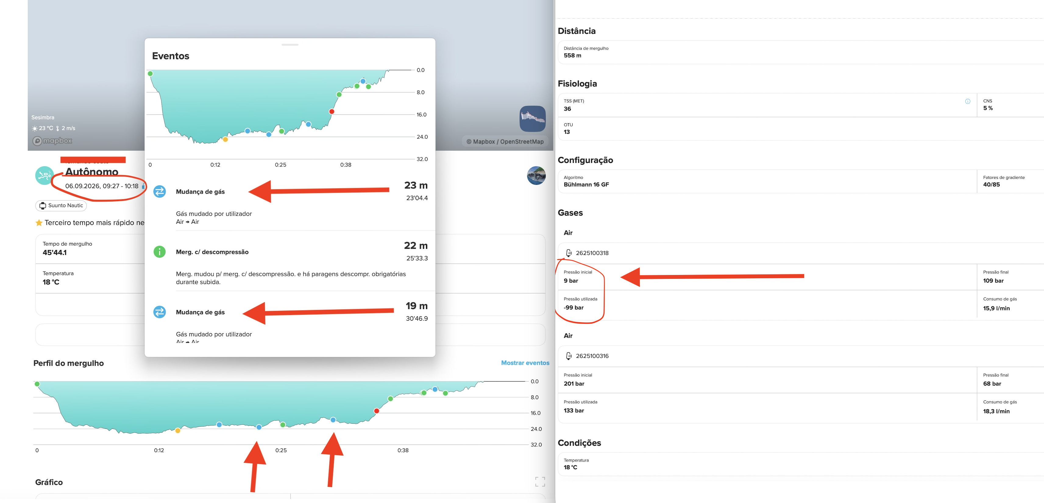

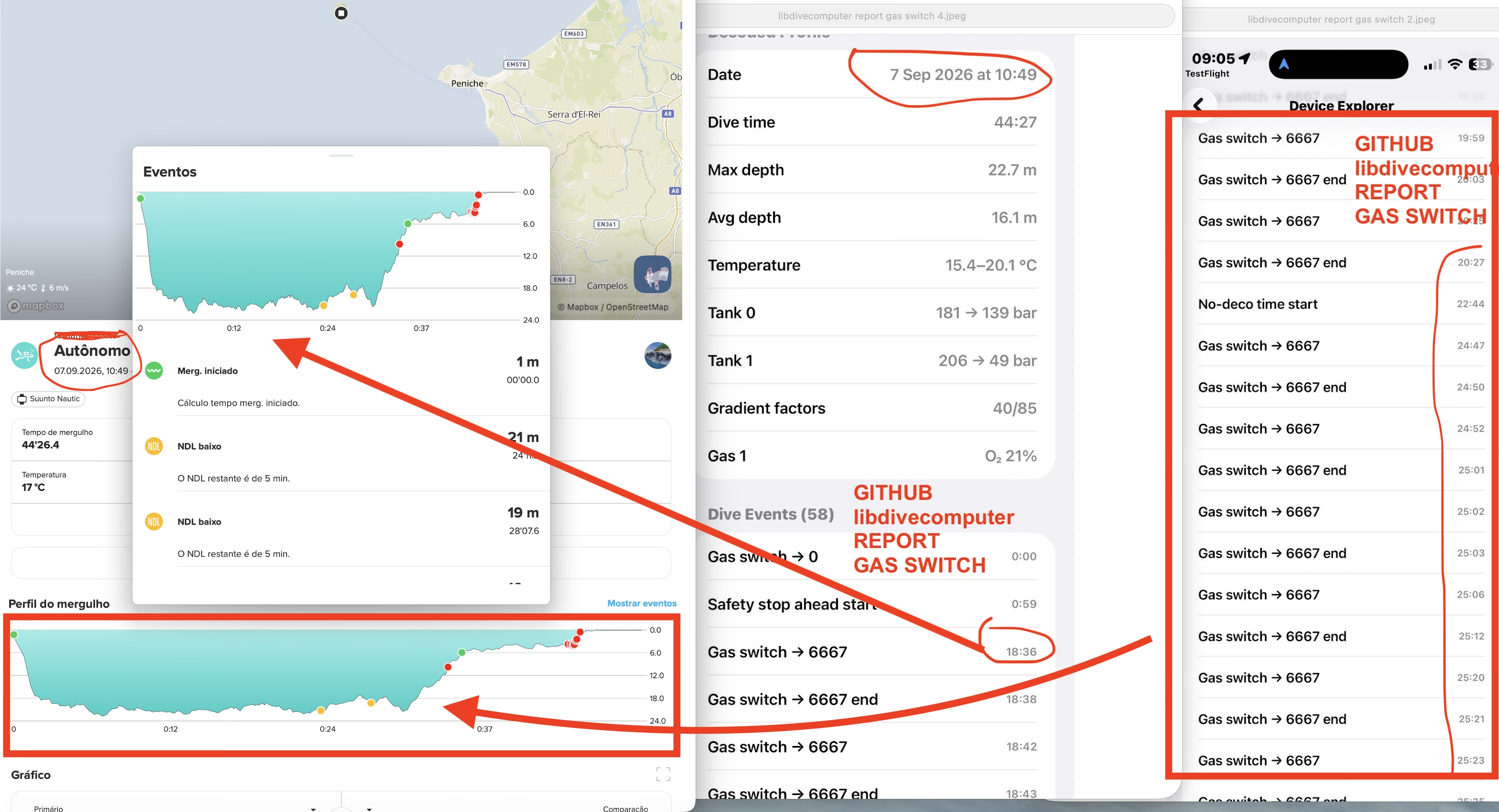

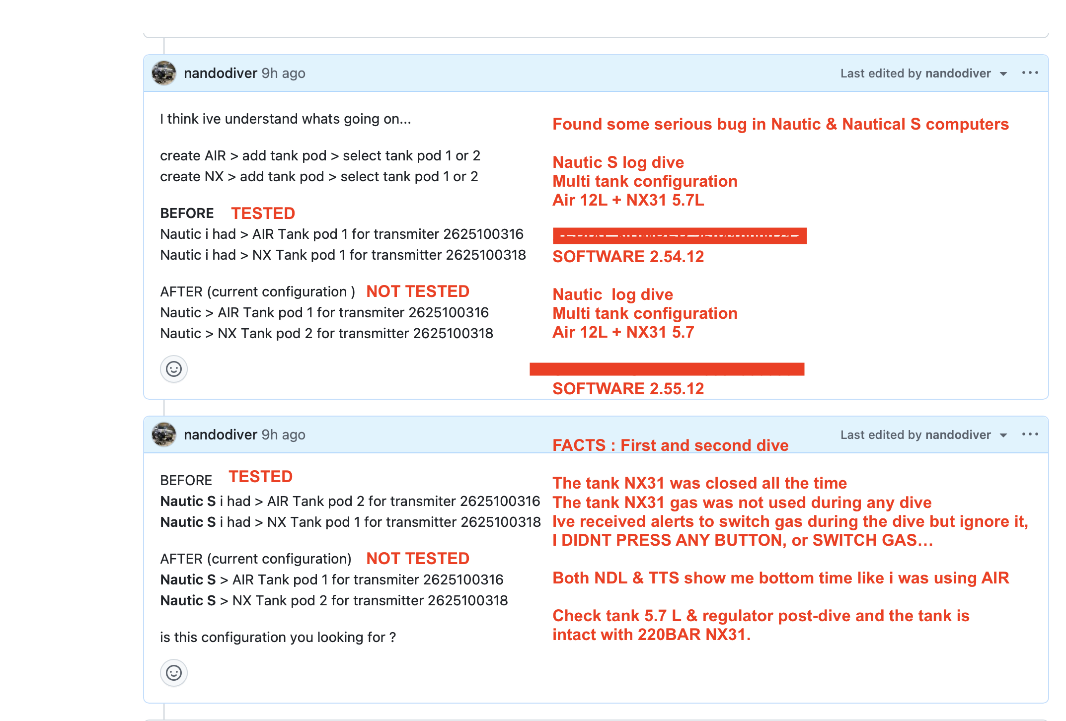

      Found some serious bug in Nautic & Nautic S computers (report to suunto moments ago)
      Nautic S log dive SOFTWARE 2.54.12
      Multi tank configuration
      Air 12L + transmitter n: 1
      NX31 5.7L + transmitter n:2
      Nautic log dive SOFTWARE 2.55.12

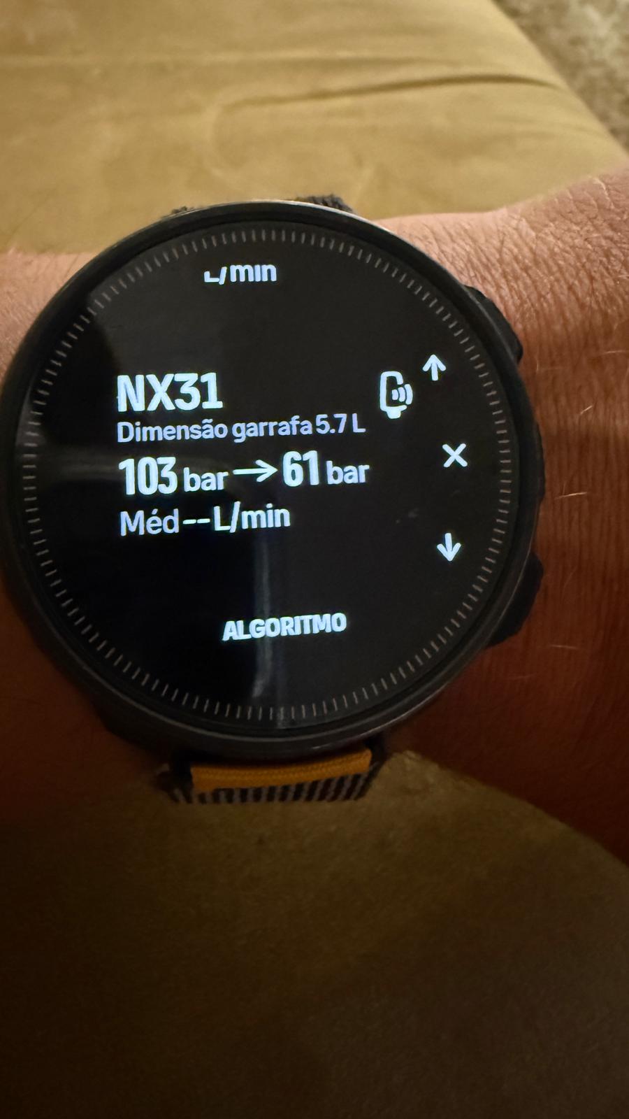

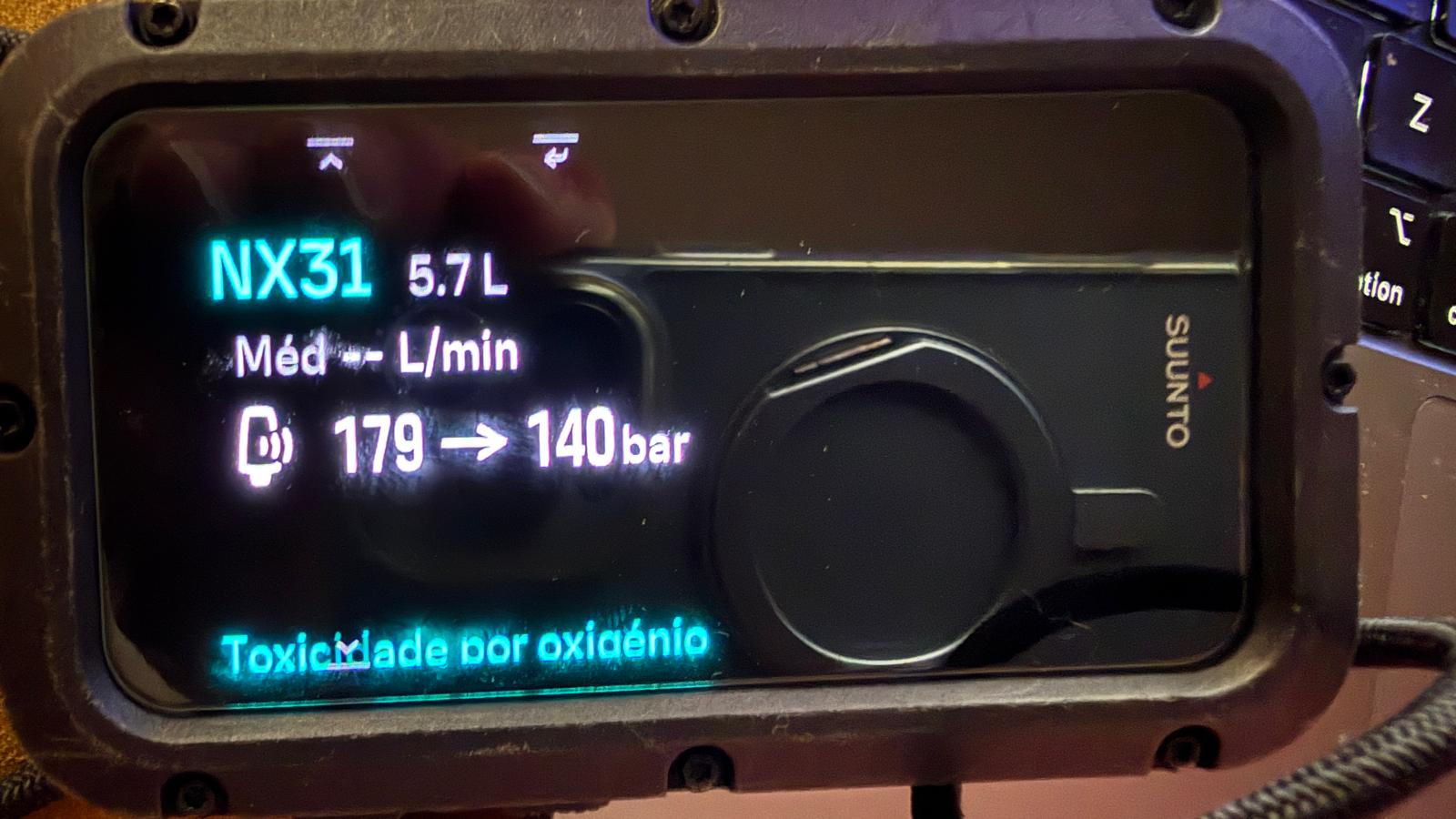

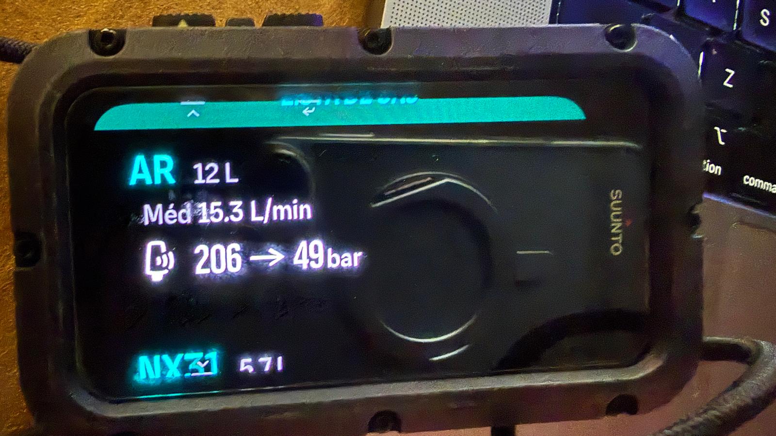

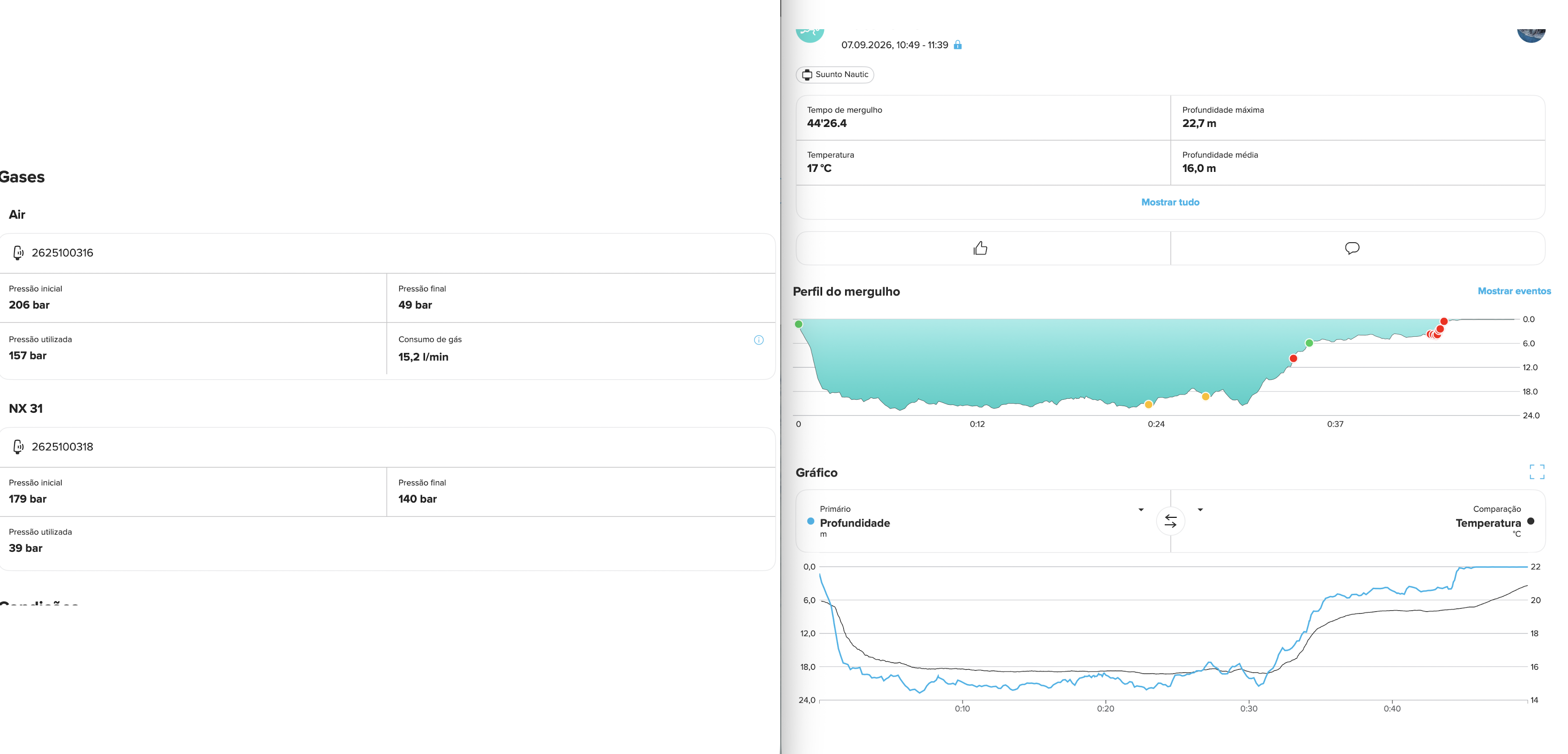

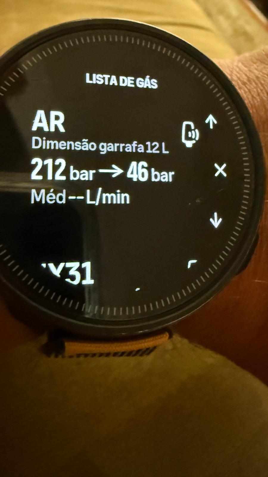

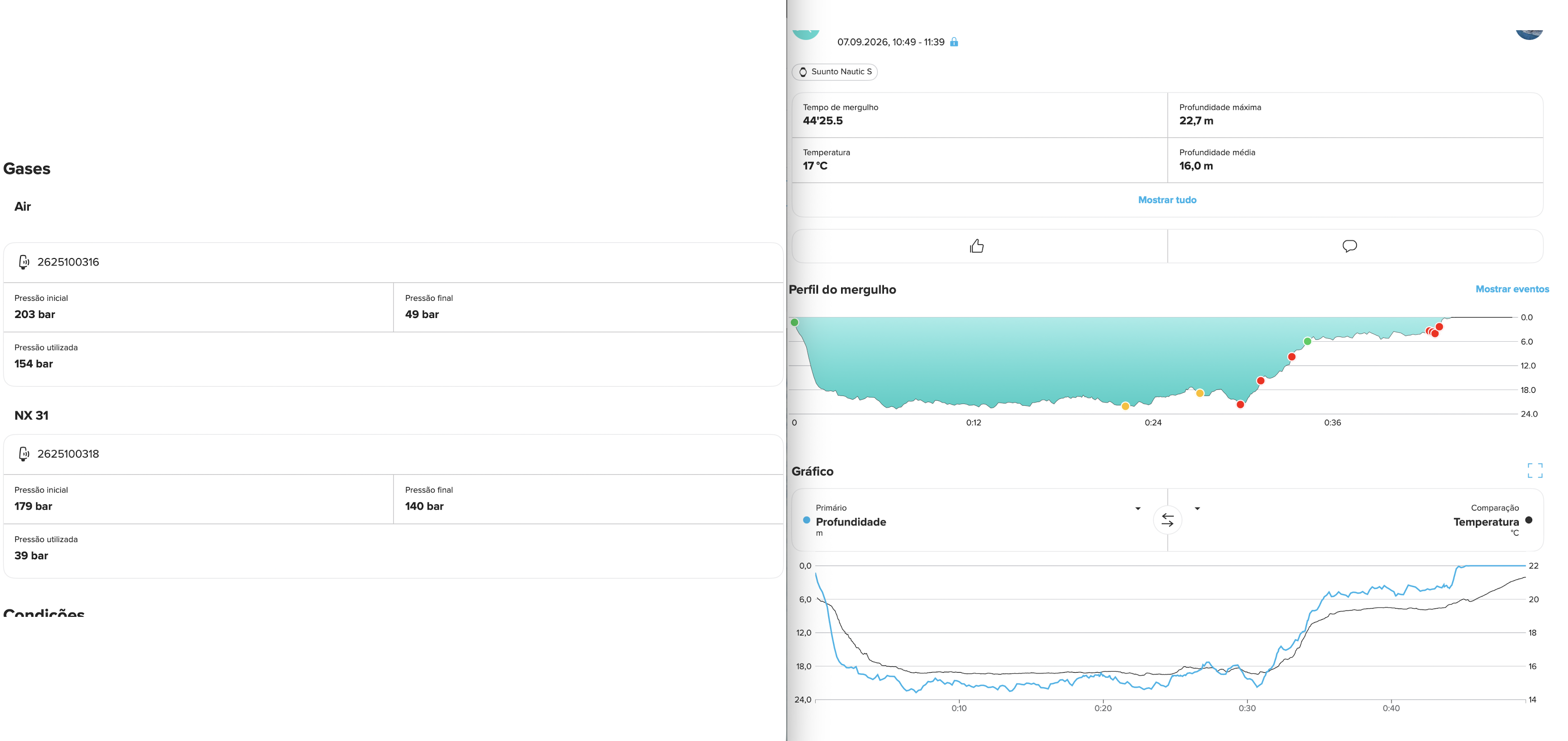

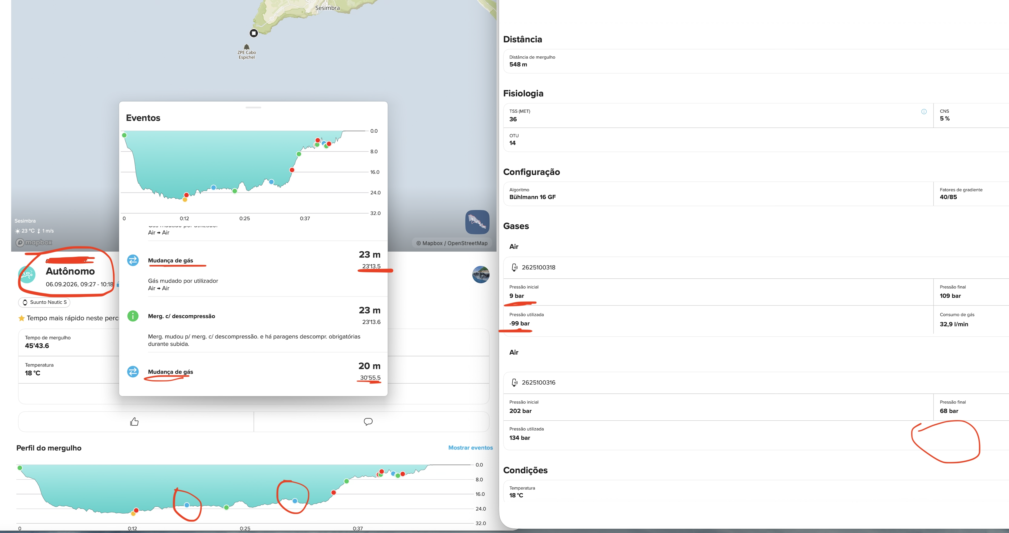

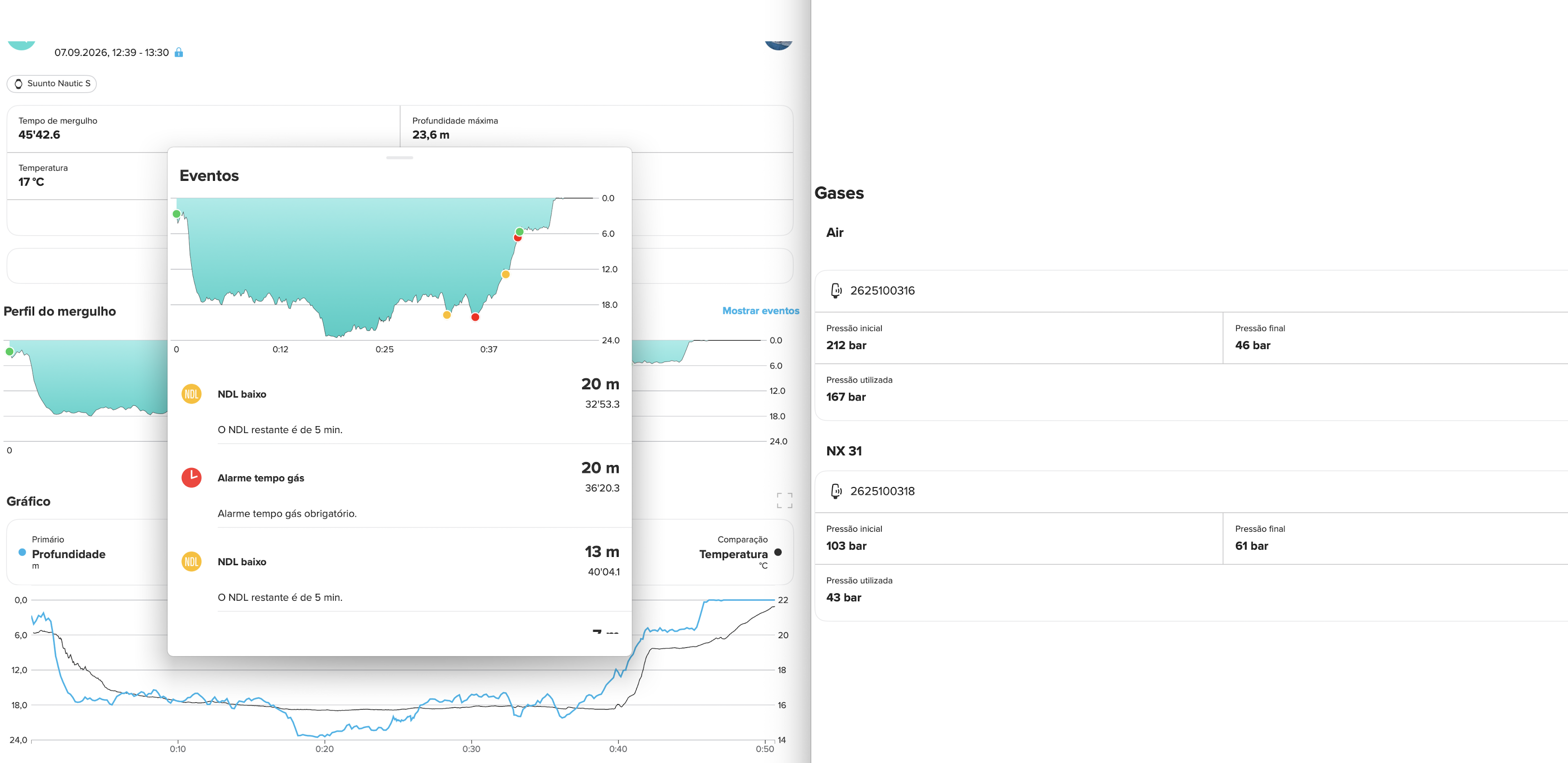

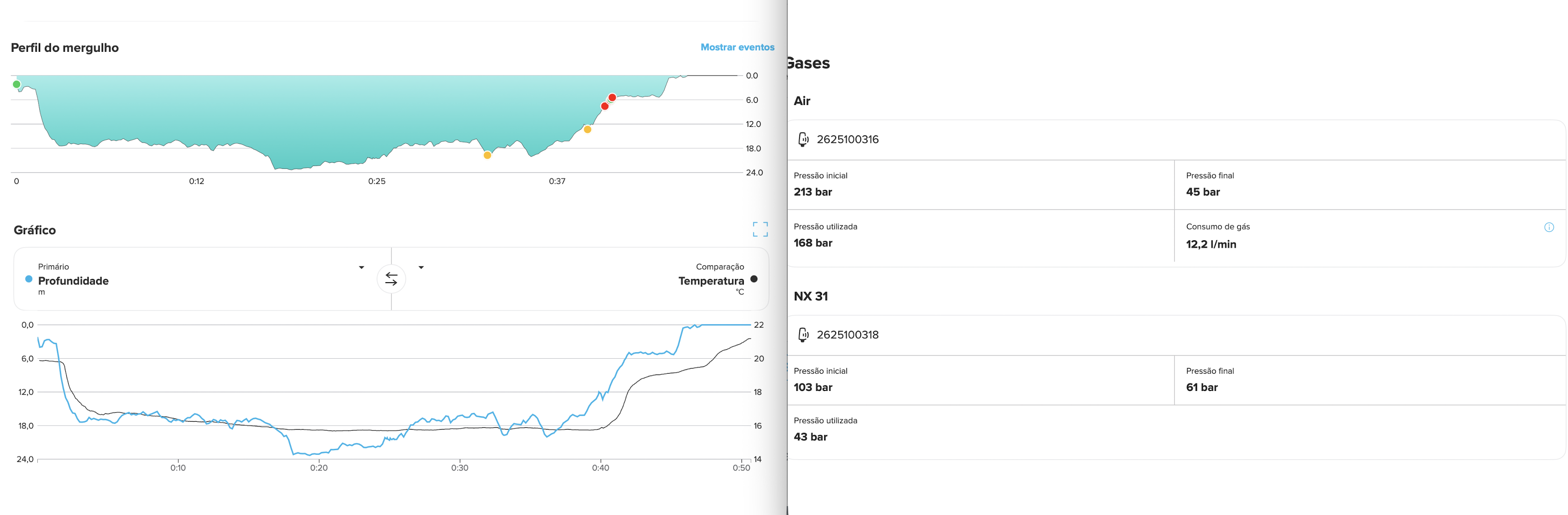

      FACTS : First and second dive
      The tank NX31 was closed all the time during the dive
      The tank NX31 gas was not used during any dive
      Ive received alerts to switch gas during the dive but ignore it, I DIDNT PRESS ANY BUTTON, or SWITCH GAS…
      Both NDL & TTS show me bottom time like i was using AIR (and i was)
      Check tank 5.7 L & regulator post-dive and the tank is intact with 220BAR NX31.
      Im divemaster with +400 dives on my belt, it was not diver error (im 100% sure) the other dive buddies they are also on AIR, and bottom time and safety stop was done together with similar safety stop time.
      This is critical bug, the gas switch recommended intervene in some point at software and computer level.
