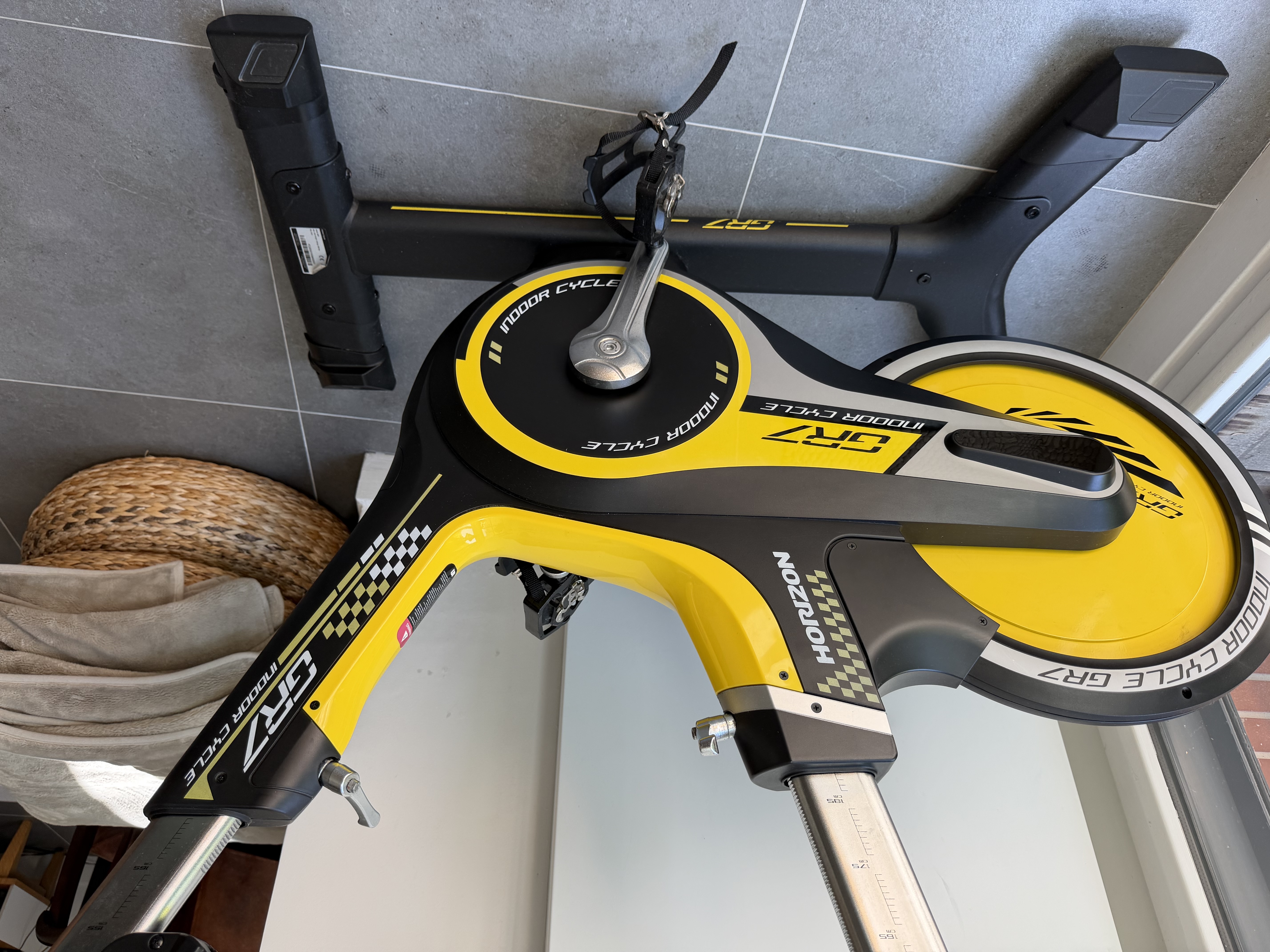

Hello suunto community, my Indoor Cycle Bluetooth FTMS link app has been published this morning.
The app connects to the bike automatically, shows the data in real time and records it as the data points in the workout summary.
The app is currently tested and works well with Kettler HOI bike family, and theoretically should support other FTMS indoor bikes as well as Kettler follows the standard pretty closely.
I’m looking forward to add the new features and fix any issues with the other bikes. Please don’t hesitate to leave any feedback, bug reports or feature request here or through the feedback form in suuntoplus app listing
