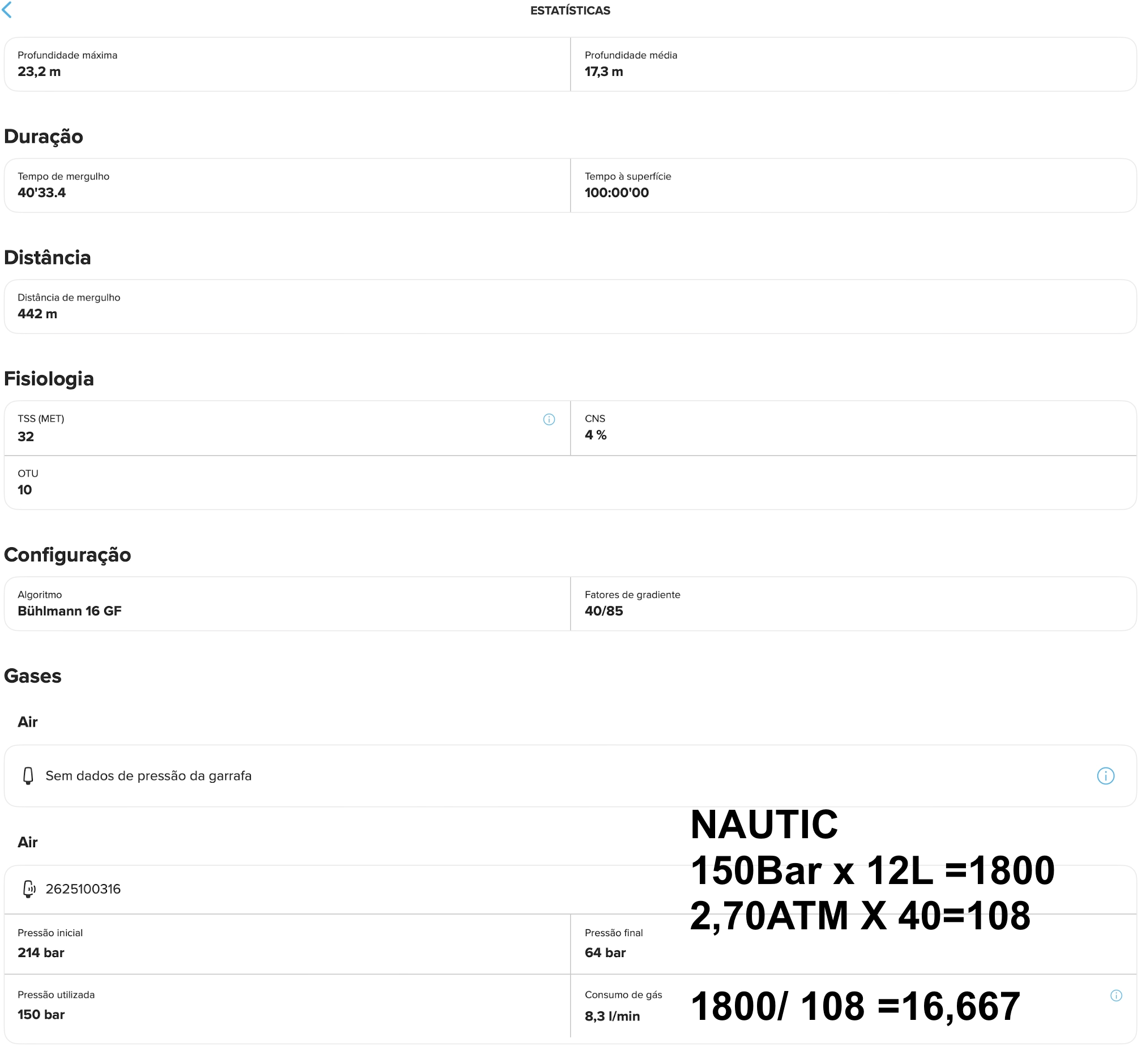

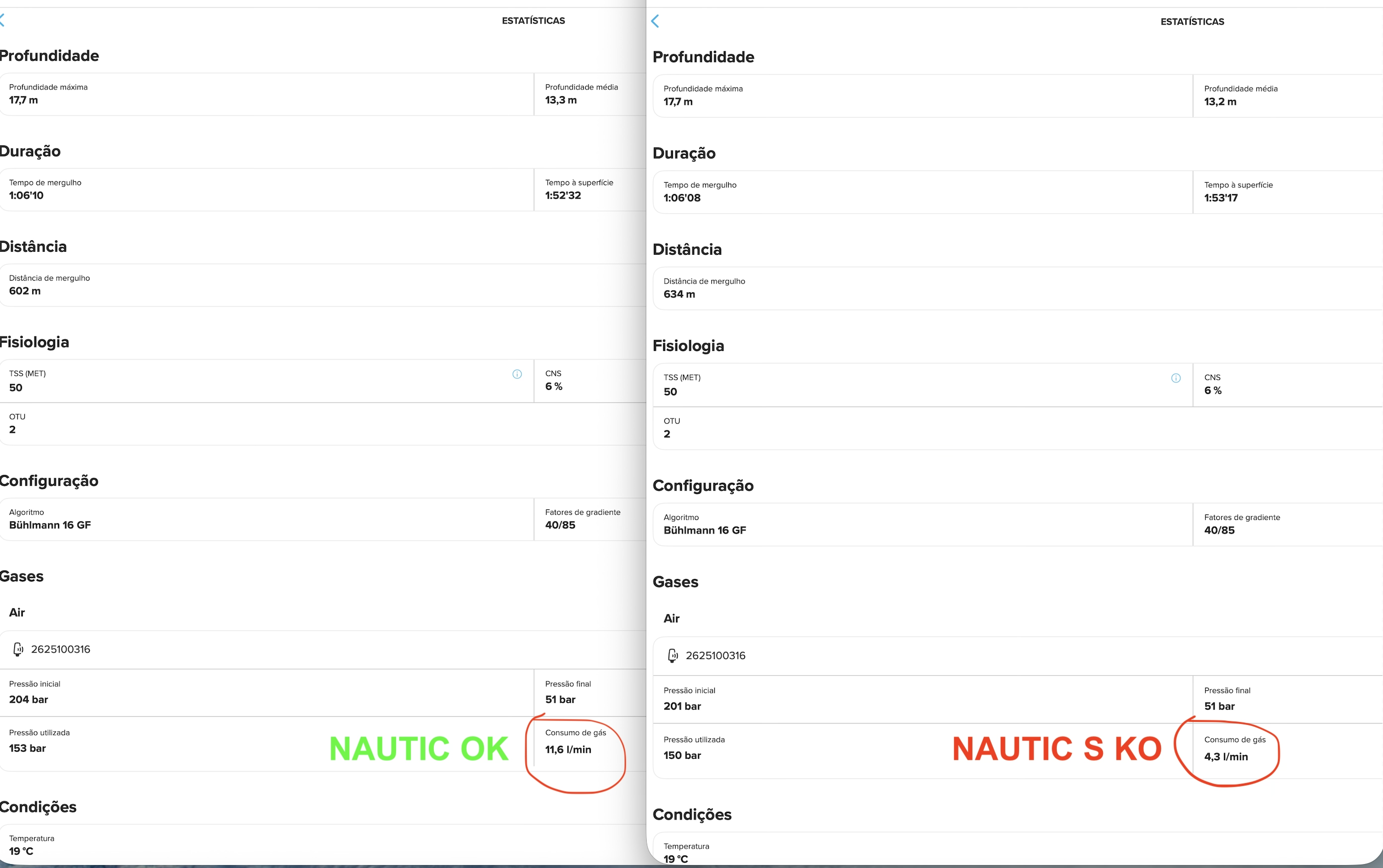

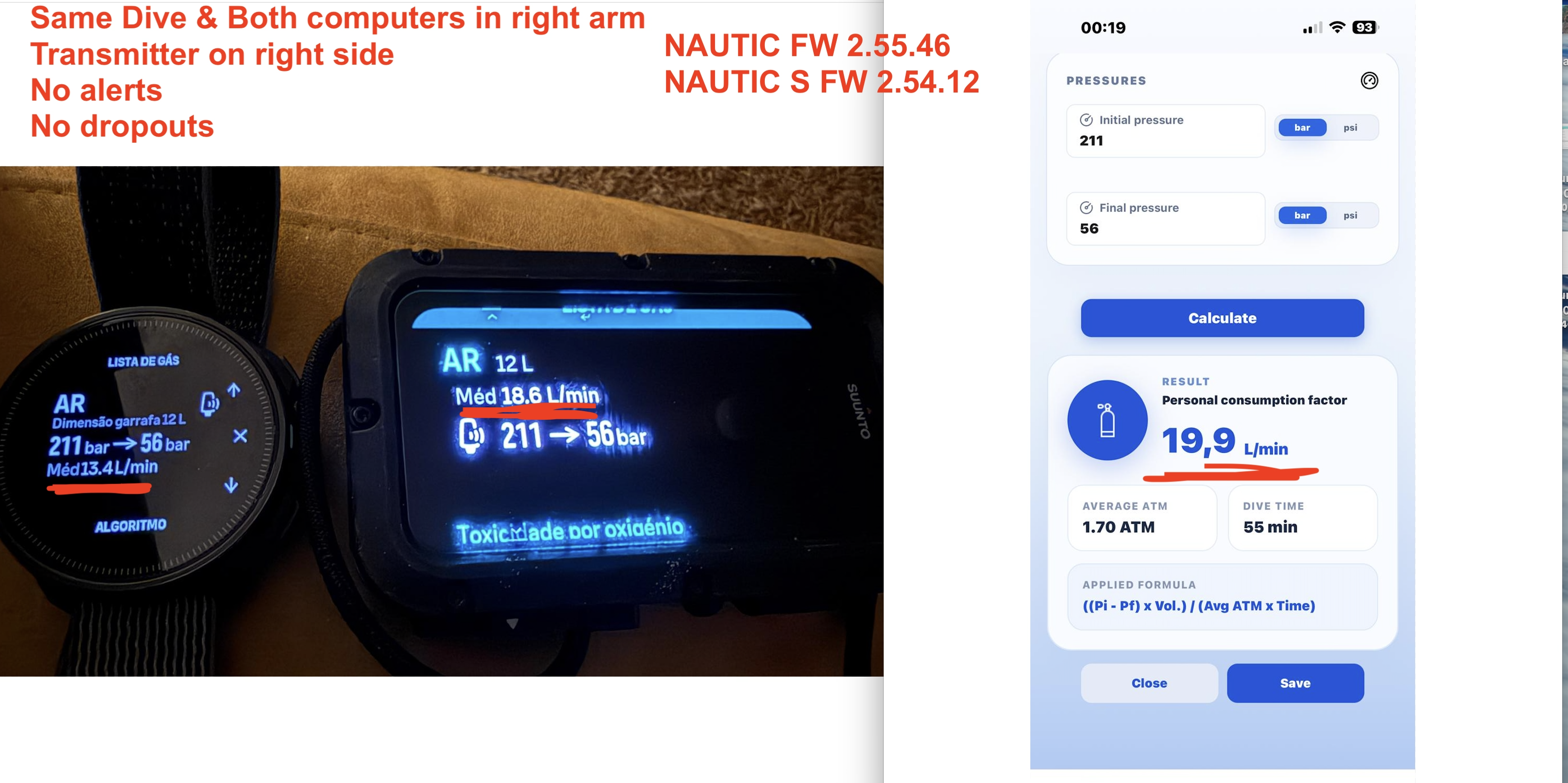

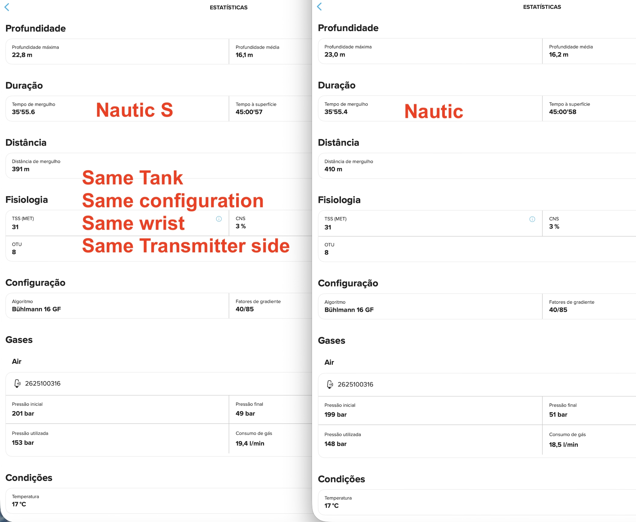

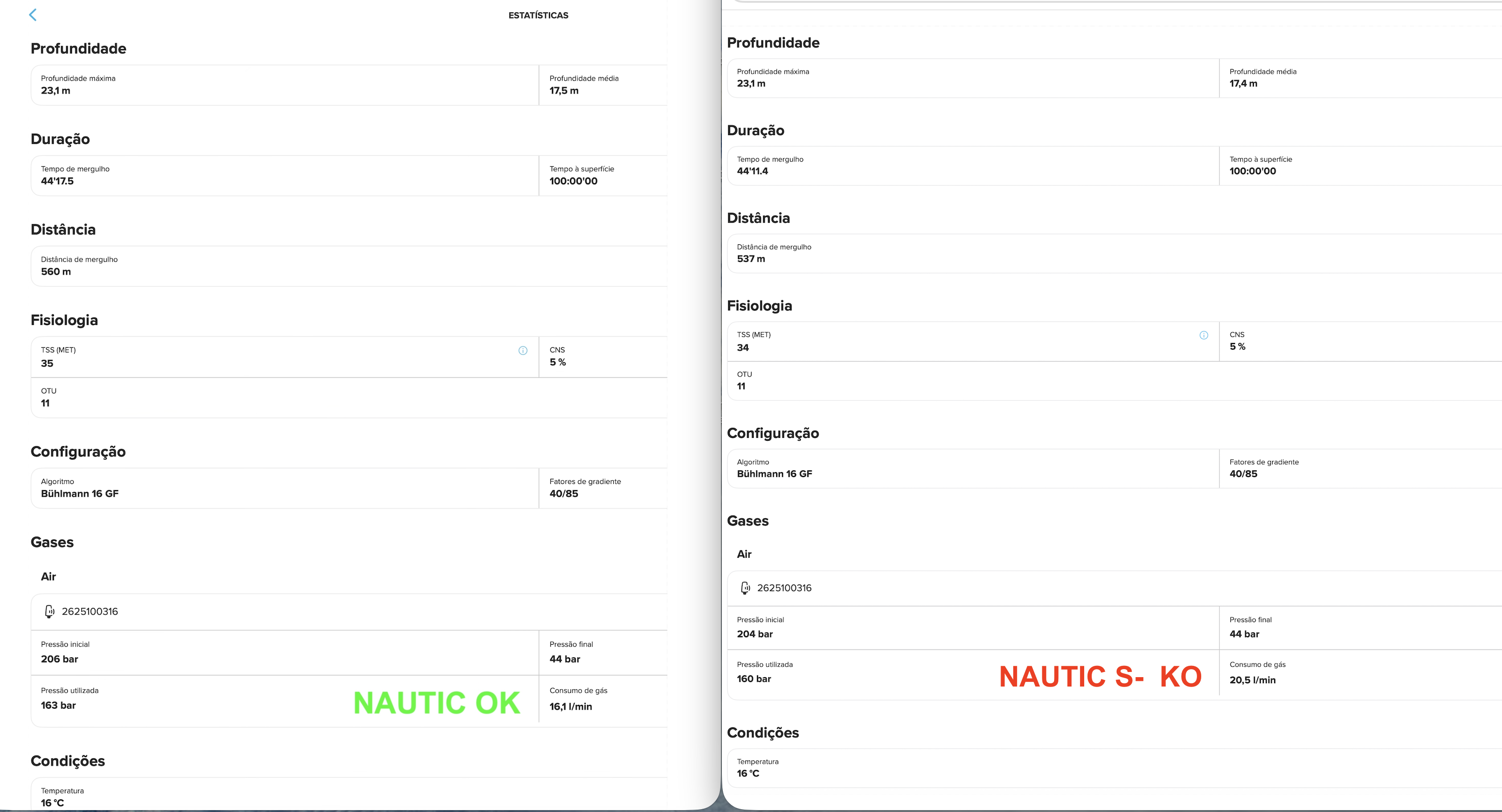

      The following air consumption is not making sense on the Nautic S, the Nautic might be correct.
      Nautic S & Nautic the have the same tank configuration (12L)
      Tank 12 L x 197 bar = 2364 bar
      start 197 Bar
      end 43 Bar
      154 Bar x 12L =1848
      2.70 ATM x 44 minutes = 118
      1848L / 118 =15,6L minute
      FORMULA ((Pi-Pf) x Vol.) / (Avg Atm x Time )

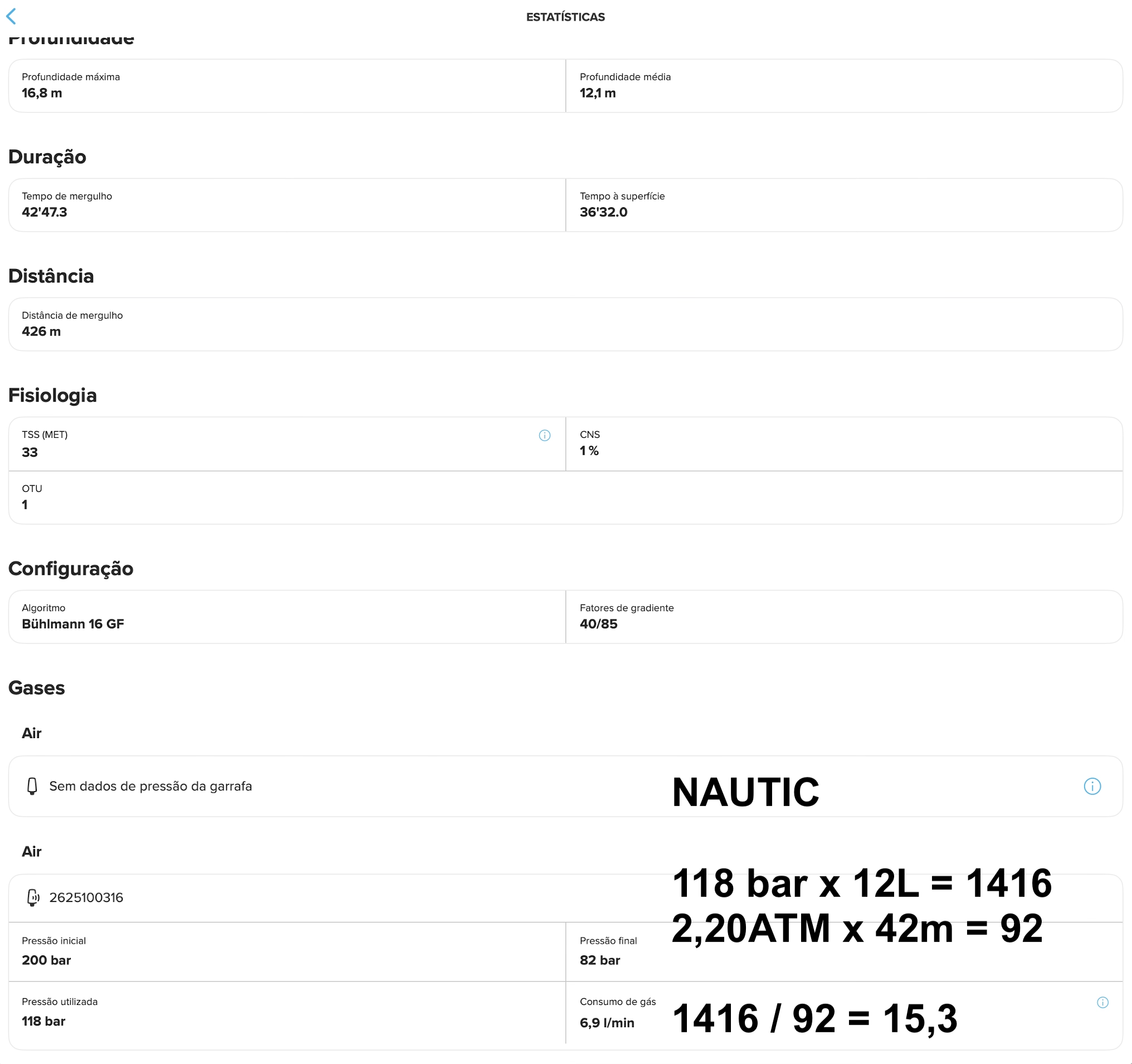

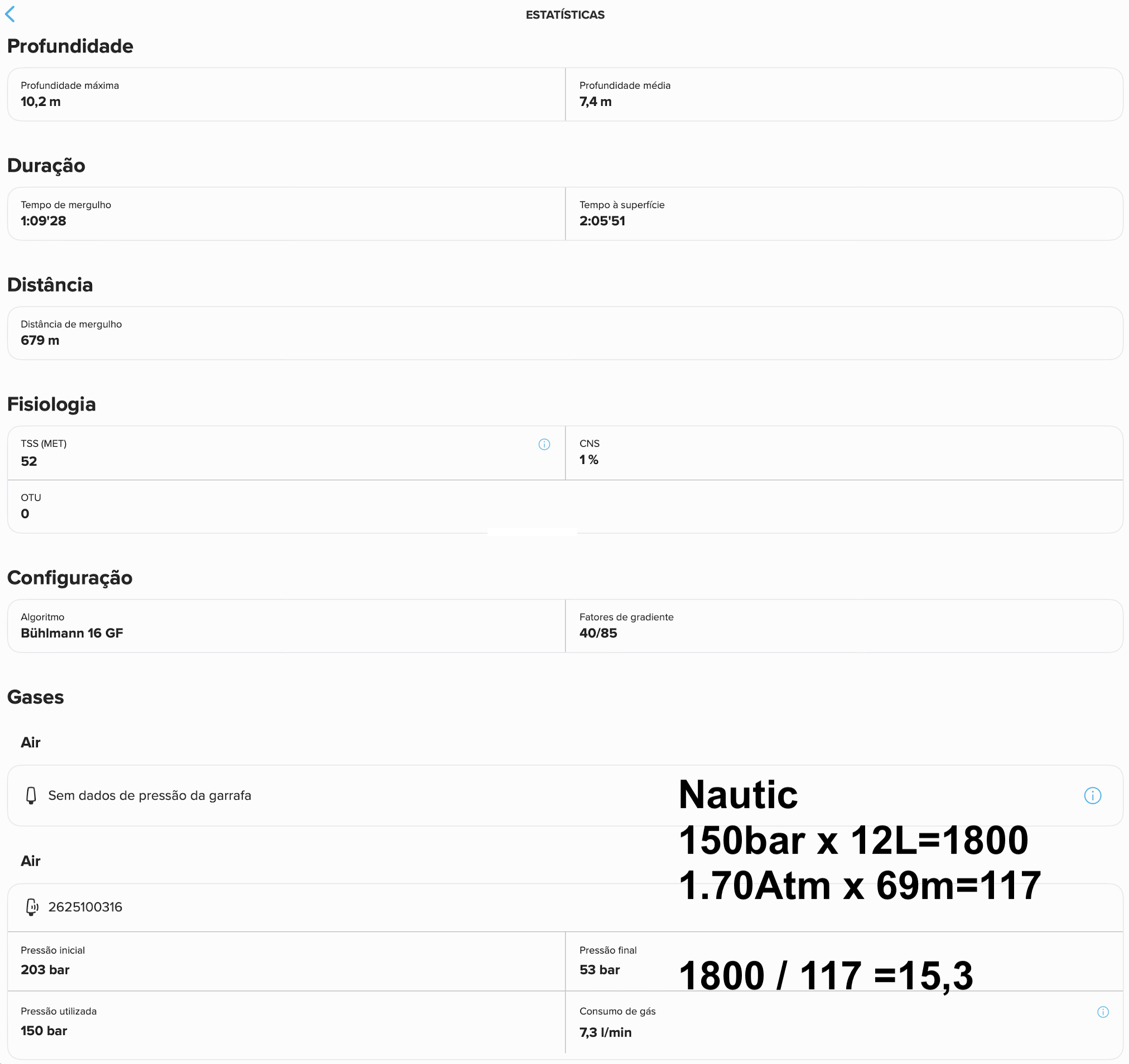

        Nautic
        Configuration Multiple gases
        12L + 5.7L
        Note: 5,7L tank has no transmitter and was not used

            Nautic
            12L + 5.7L
            Note: 5,7L tank has no transmitter and was not used during dive

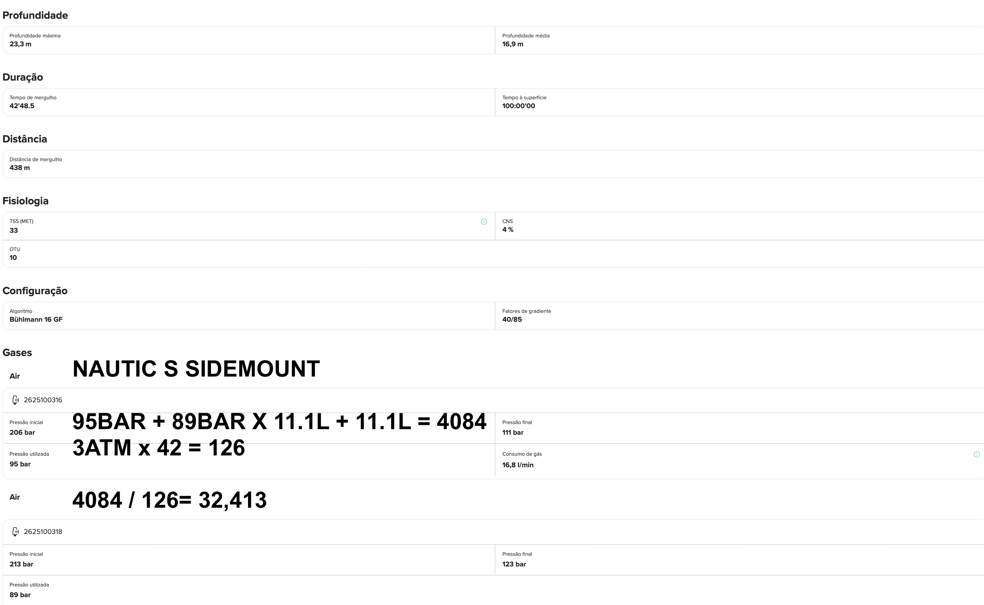

              Sidemount
              2x 11.1 L is also incorrect
