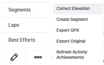

      Edit: I have added the output of the Correct Elevation option available on Strava that one of my co-workers showed me. This could be an useful addition also on the Suunto App!
