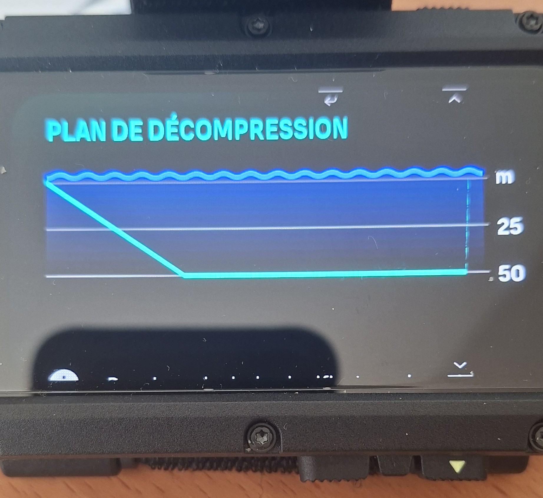

      Hello,
      Strange behavior of the dive planner.
      In some cases you can end up with a dive with only 2 steps (descent and bottom time), no out profil, just a straight vertical line from bottom to surface.
      To reproduce issue:
      Plan a first dive:
      GF: 40/85
      Gas: AIR
      Surface interval 48:00
      Dept: 50
      Bottom time: 10
      Computation seems correct.
      Get back using back button.
      Select same depth (5)
      Stay more than 10s on the selected depth, NDL an TTS get reset to 0
      Select Bottom time (10)
      The computed dive plan has only 2 steps…
      Is it a bug or am I missing something
      Cheers

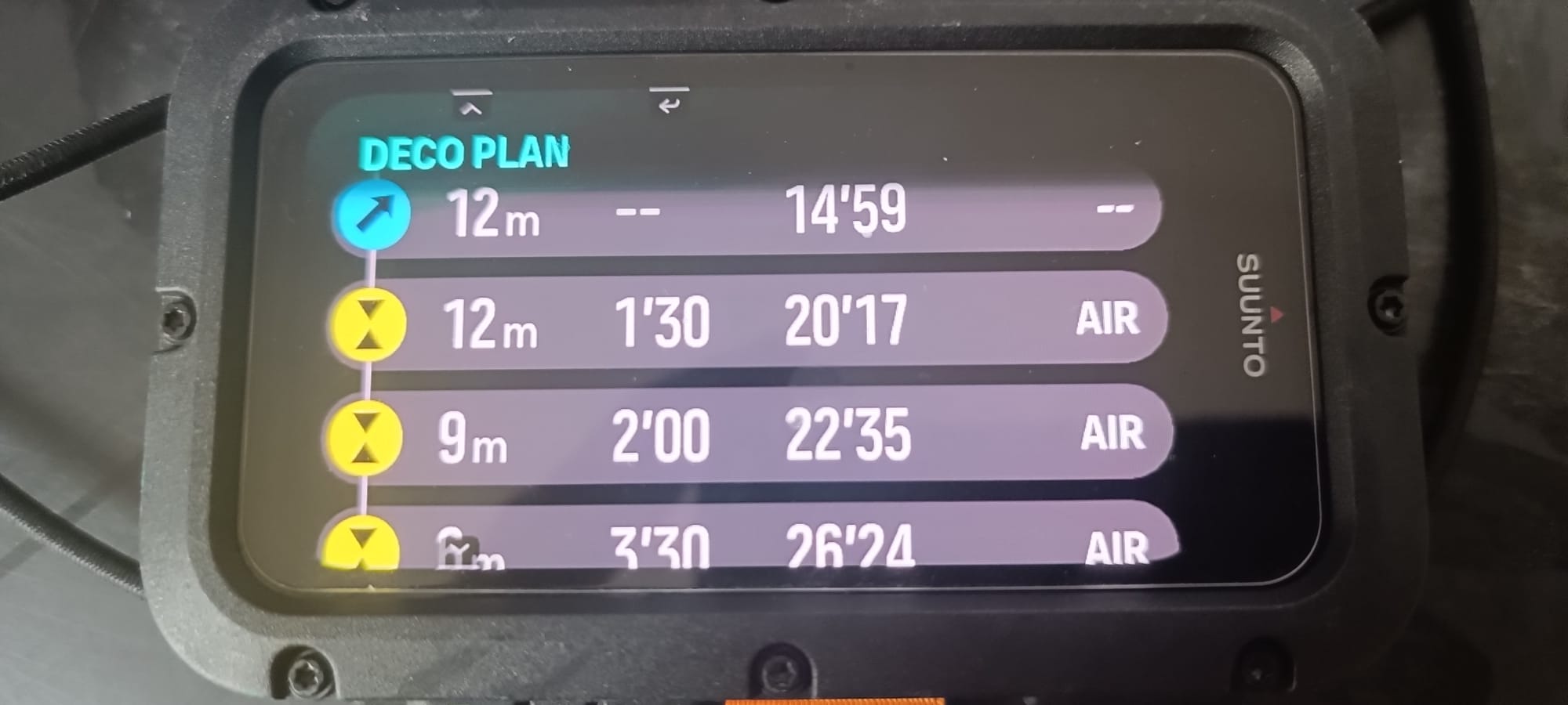

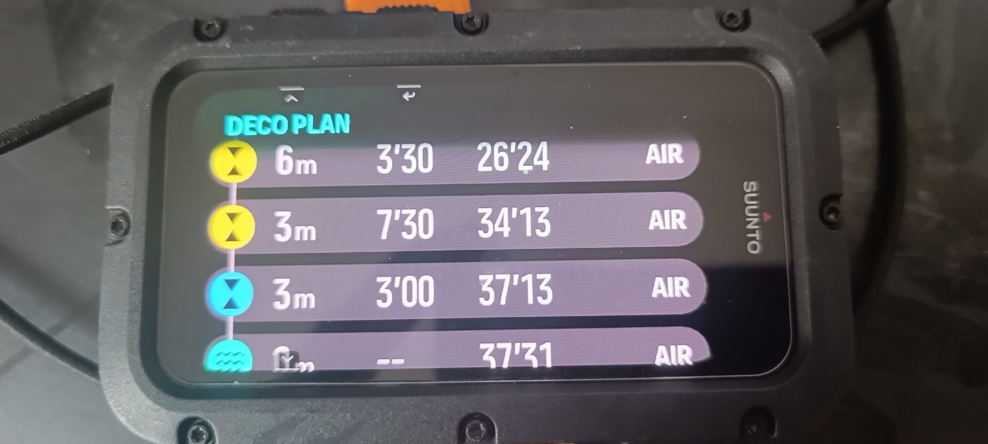

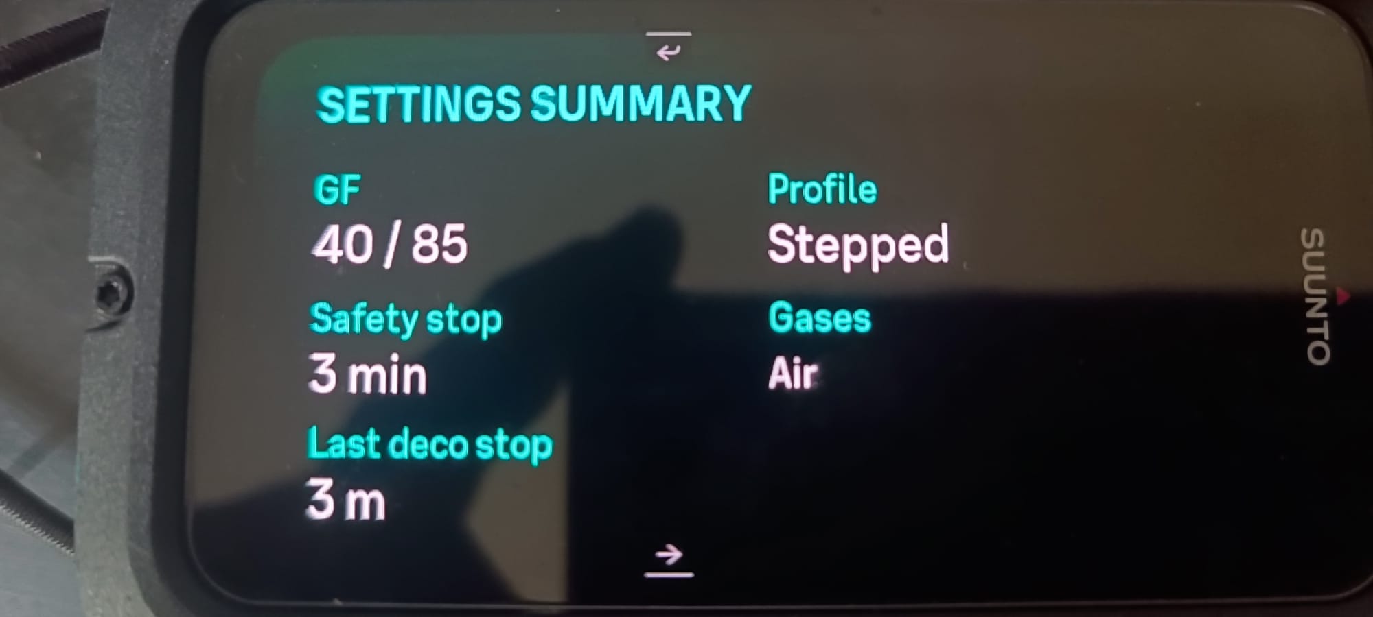

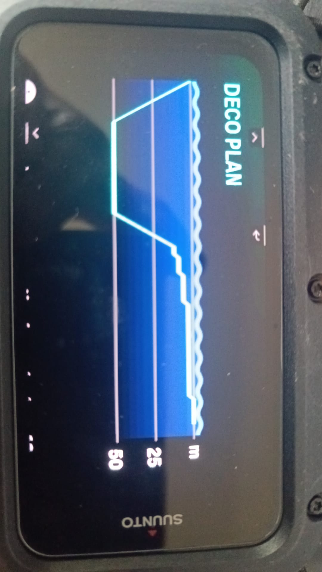

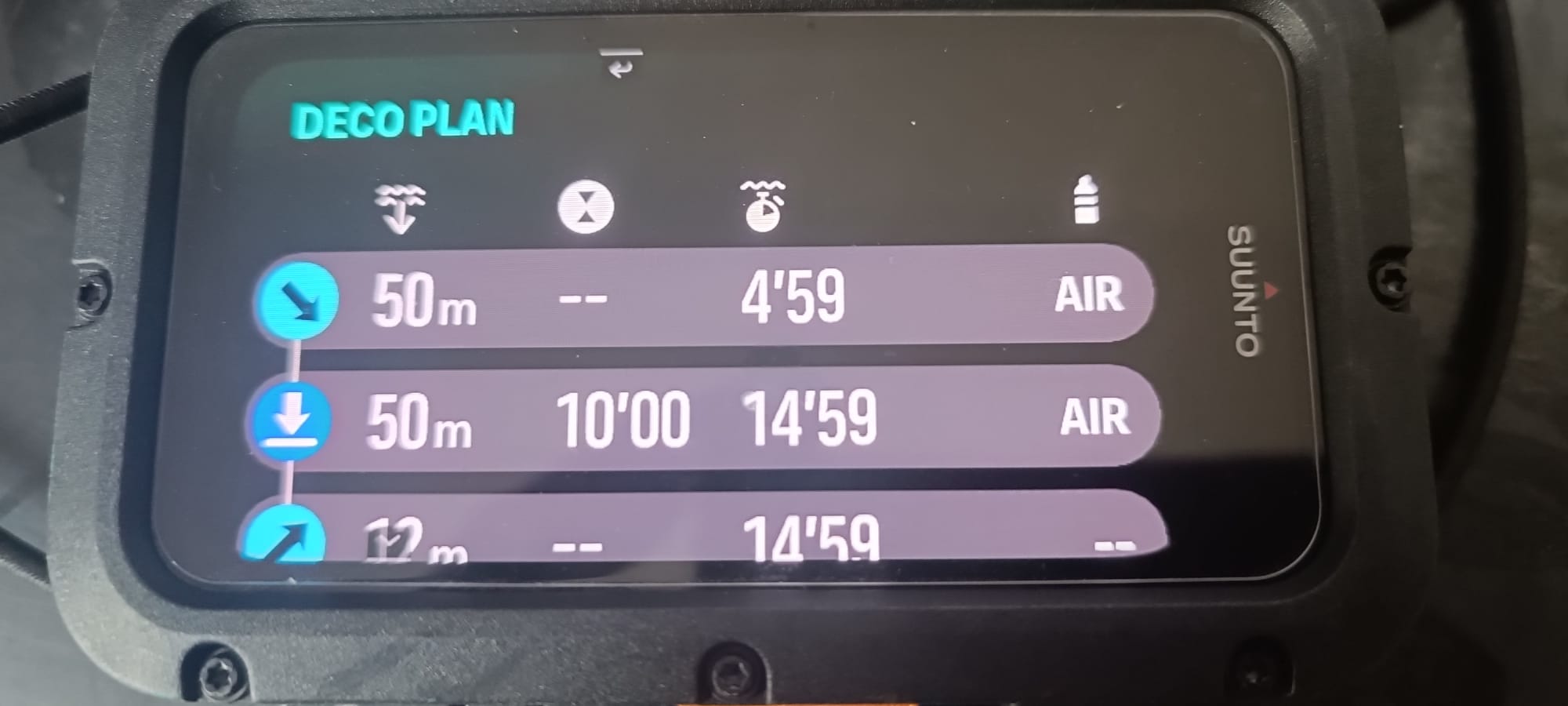

          WhatsApp Image 2026-06-16 at 11.41.48 (1).jpeg WhatsApp Image 2026-06-16 at 11.41.48 (2).jpeg WhatsApp Image 2026-06-16 at 11.41.48 (3).jpeg WhatsApp Image 2026-06-16 at 11.41.48.jpeg WhatsApp Image 2026-06-16 at 11.46.50.jpeg
          Same parameters, NDL and TTS effectively turn to 0 but not the same result than you…
          Etrange !
          S 1 Reply Last reply Reply Quote 0

            @Ldive Thank you for taking the time to redo the test 🙂
            The issue occurs only when you run the simulation twice.
            The first run is ok (looks like the one you posted).
            The second one must be done by going back with the back button from the last screen of the first simulation.
            If you have followed this procedure, I’s really Etrange, and also a good news for you 😉
            I’m using le latest firmware, don’t know if it makes a difference.
            Cheers
            L 1 Reply Last reply Reply Quote 2

                @soryp I confirm I did it twice following your instructions… That’s why it is so strange !
