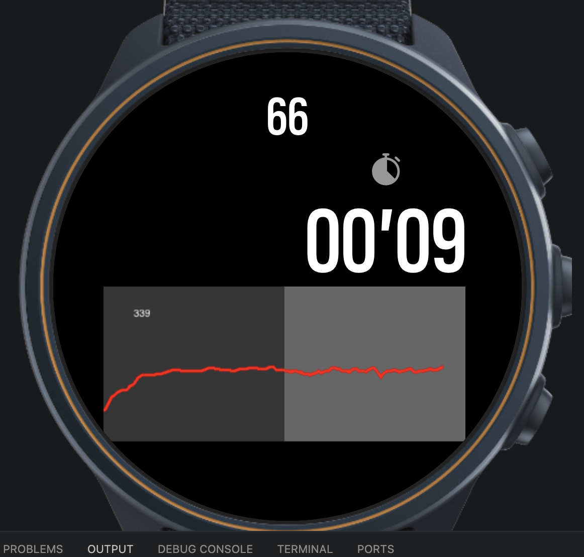

      Both canvases are refreshed from the same 10 Hz tick:
      $.subscribe('/Dev/Time/Tick10hz', function() {
        control('#cnv2', 'REFRESH');
        control('#cnv3', 'REFRESH');
      The two canvas elements sit flush side by side in the layout:
      <object id="cnv2" type="canvas" build="ctx => renderChart(ctx)"
        style="position:absolute; left: 50px; width: 180px; top: 233px; height: 160px;" />
      <object id="cnv3" type="canvas" build="ctx => renderChart2(ctx)"
        style="position:absolute; left: 230px; width: 180px; top: 233px; height: 160px;" />
      The result is a seamless 360 px HR chart — six minutes of data at 1 Hz — with room to spare in both render budgets. Here’s what it looks like with real HR data from a training run, showing the warmup ramp and settling into aerobic pace:
