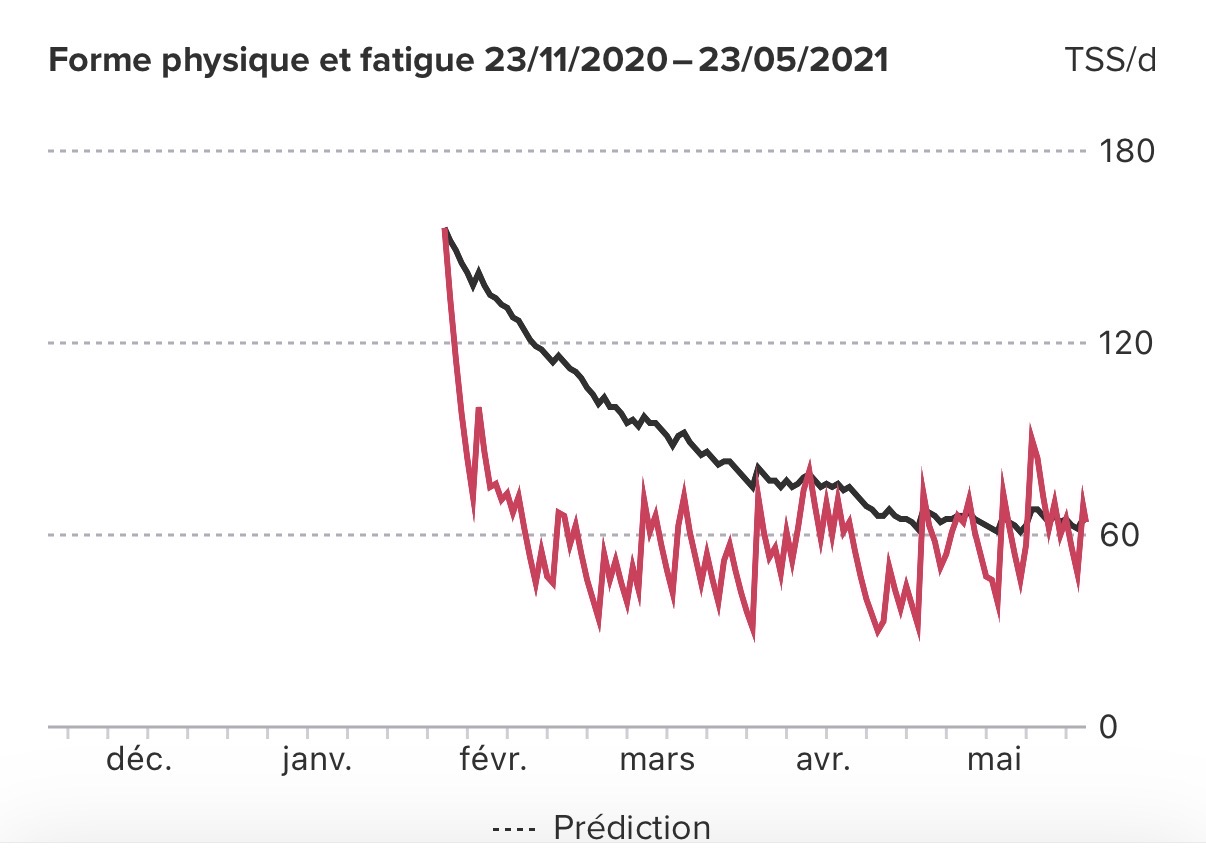

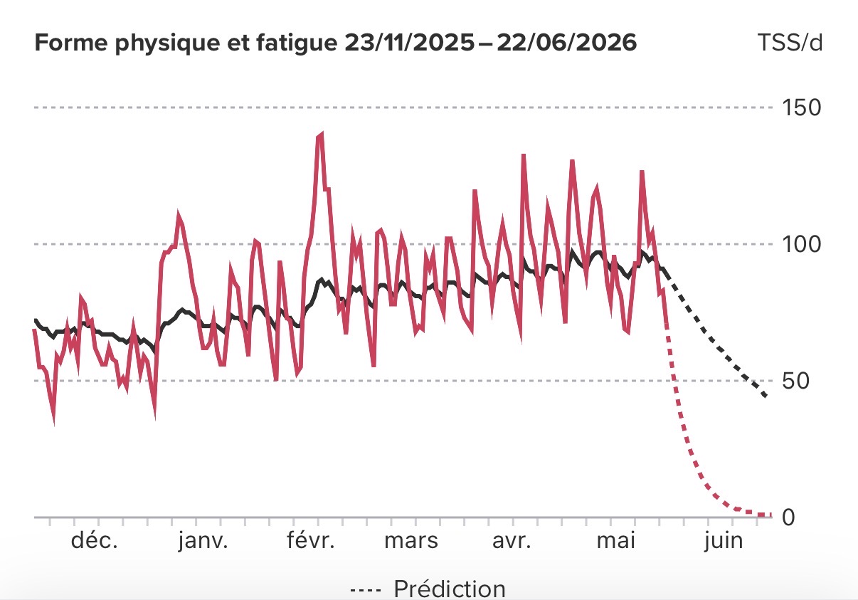

                      @Elad-Solomon absolutely normal, fitness level at beginning starts very high, then decreases before it’s stabilized depending on your load
                      As exemple my first 6month when training load was introduced and the past 6 month below
