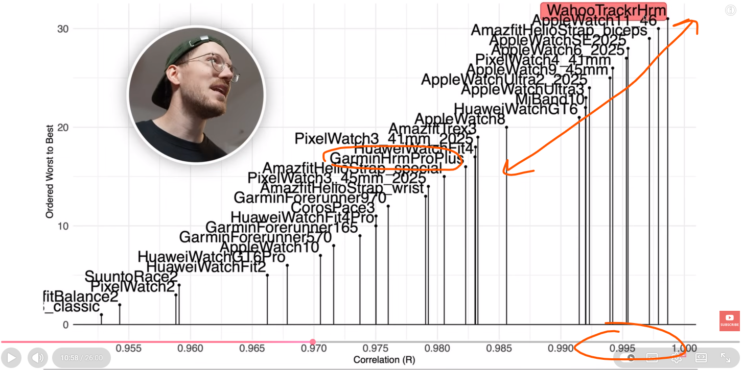

                        @elbee I agree with you on almost every point—especially the importance of being comfortable to wear.
                        There are subtle differences even among HR chest straps; Wahoo is among the best when it comes to this.HR Belts.png
                        E 1 Reply Last reply Reply Quote 0
                        • E Offline
                          elbee @laufbursche7
                          @laufbursche7
                          Please look at the horizontal scale. It’s not from 0 to 100. It’s from perfect usable to perfect usable. 😉
                          So, in reality there is zero difference. Only for some youtube influencer to make movies about (without questioning the relevance)
                          Suunto t3c | Suunto Ambit 3 sport | Tomtom runner 2 | Garmin forerunner 935 | Garmin forerunner 965 | Suunto race s
                          Stryd | Bryton Gardia R300L | Polar H9 | Polar oh1+ | Wahoo bolt v2 | 4iiii precision 3
                          laufbursche7L 1 Reply Last reply Reply Quote 2
                          • laufbursche7L Offline
                            laufbursche7 @elbee
                            @elbee
                            The correlation is weak, but it is there.
                            It is not just some YouTube influencer, but a postdoctoral researcher at the Research Center for Molecular Medicine (CeMM)
                            He is a data-scientist who analyses immunological data for work, and data about hisself and different wearables as a hobby.
                            E 1 Reply Last reply Reply Quote 1
                            • E Offline
                              elbee @laufbursche7
                              @laufbursche7 said in Race titanium with Wahoo TRACKR HR:
                              @elbee
                              No. The correlation is strong! In all of the devices in the graph.
                              Sure he is a postdoctoral researcher. But research center for molecular medicine doesn’t sound relevant for measuring correlation in heart rate monitors.
                              I’m just saying, there isn’t better than good enough but if someone thinks it makes a difference and wants the top item in the graph, by all means, buy the wahoo.
