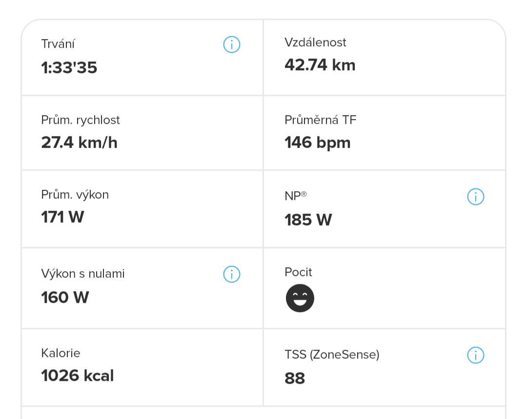

              @Stoke80 I have DUO version. No problem with pairing. You can only see total power, not separate L/R.
              But I suspect that Suunto counts the time from automatic pauses into the average power even so it shouldn’t. I never got same values from Wahoo and Suunto if I have some auto pauses during ride. If I reduce the average power from Wahoo by a proportional amount taking into account the pauses, I get the same power, or a maximum difference of 1W. Normalized power is always same. So don’t be afraid, you can use it without problem!

                        @herlas Yes, Suunto shows both average powers, with and without zeros and in Wahoo settings, you can set if you want average power with zeros or without. I have set this to without zeros and I got SMALLER average power without zeros from Suunto than on Wahoo. Never got higher values from Suunto. On last ride, the difference was 3,6%. It’s clear, that algorithm will differ Suunto vs. Wahoo, but I think, this difference is high and this is the reason, that I’m not sure, if Suunto really doesn’t count auto pauses to the average power…
                        With connecting to device which doesn’t support dual sided wattmeter, Assiomas should send the instantaneous power at a given time and it should be the sum of both pedals.
                        EDIT: On ride with “longer” snack pause, the difference was 5,1%.
                        EDIT2: So no, the difference is not because of auto pause🫤.

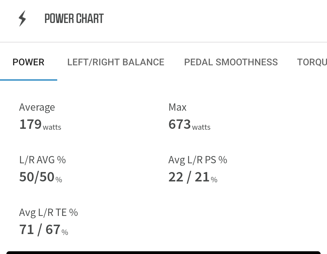

                                          I just got back from a bike ride and I compared how the average power was calculated in Strava, SA, and Garmin Connect.
                                          Strava is always the lowest (on this particular ride - 122 W), Garmin Connect is in the middle - 123 W, and SA shows 129 W and 122 W with zeros.
                                          I wouldn’t read much from the 122/123 difference, but to me both Strava and Garmin show the average power with zeros (?).

                                            @MdzOtt yes, SA is the one not doing it ;). In my case with Karoo Gen 3 I see same avg power with zeros included (gold standard) like you get see with garmin/Strava
