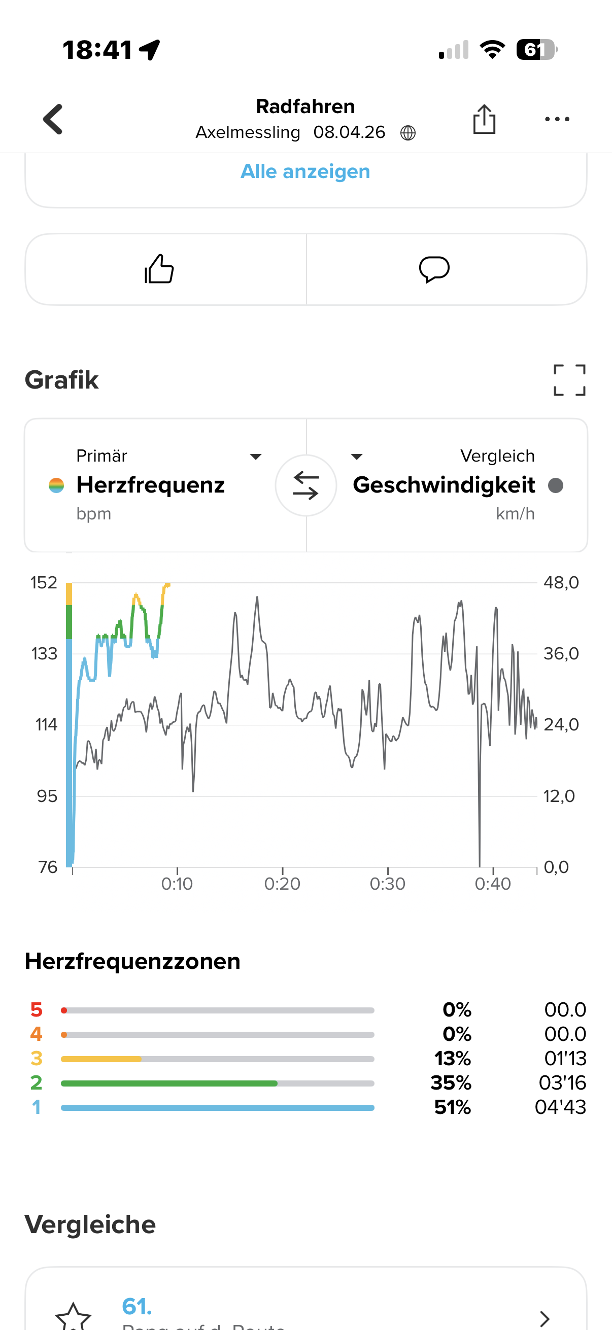

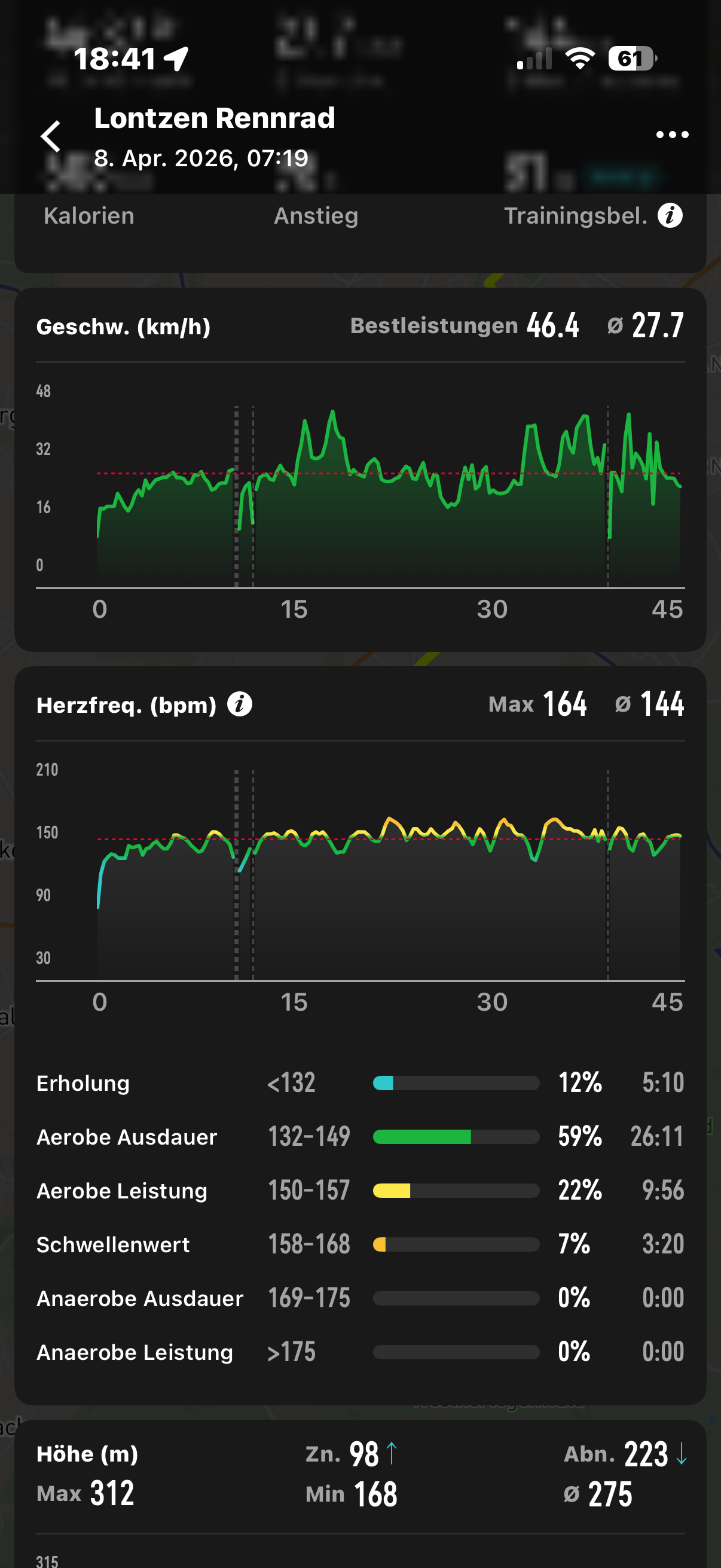

      Error description
      Since update 2.50.26 and in all subsequent updates, the use of multiple HR devices is no longer possible. The connection between the watch and the HR device drops after a few minutes, the value on the watch display either freezes or no value is shown anymore. This also happens when the correct sensor is selected in the options before starting the workout.
      As soon as one or more HR sensors are connected to the watch and at the same time to an external GPS device (here Coros DURA), reliable measurement is no longer possible, the connection is lost, sometimes after pauses, sometimes after a few minutes without any apparent reason.
      Even if only the Suunto HR belt is connected to the watch and the Coros Dura and all other HR sensors have been deleted, the watch loses contact with the belt, even though it was displayed correctly at the start.
      The error is reproducible, but the trigger cannot be attributed to a specific duration or always to a stop. In most cases the disconnection occurs within a few minutes.
      Screenshots of the last activity showing the error in the MySuunto app and on the Coros Dura are attached.
      I tried to transmit the logs to Suunto on 8 April 2026 at 18:50 but it didn’t work until 1910, I will add this information.
      M isaziI 2 Replies Last reply Reply Quote 1
      • M Offline
        manno02 Bronze Member @manno02

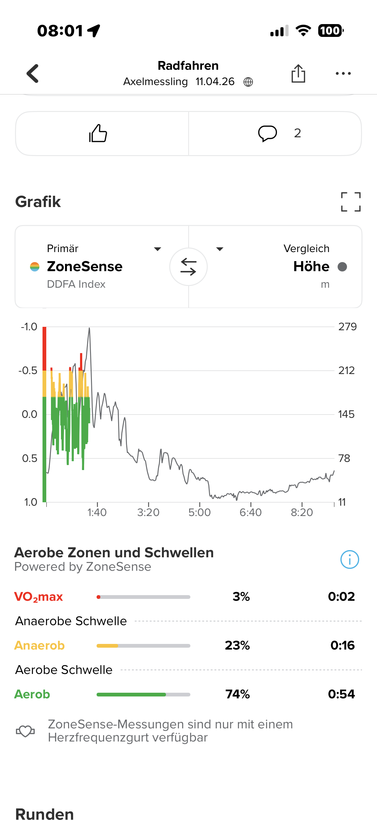

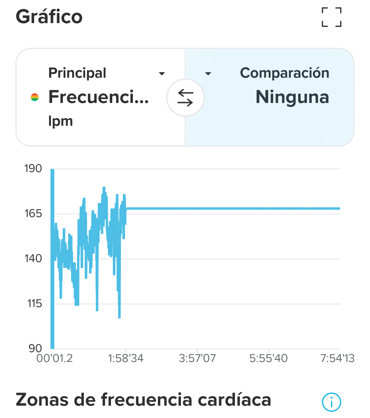

          Same here! I need to disconnect and reconnect the sensor in order to restore its functionality. I have only a single Suunto HR belt.
          Hardware
          Pixel 8a
          Android 16
          Suunto Smart HR belt
          App version 6.7.12
          Watch
          Race
          Software version v2.53.42, installed 7 April 2026
          Previous versions
          2.50.28 same error as in the current version
          2.50.26 same error as in the current version
          2.48.16 no dropouts
          Logs sent at 19.28 CEST
          Screenshot from yesterday:

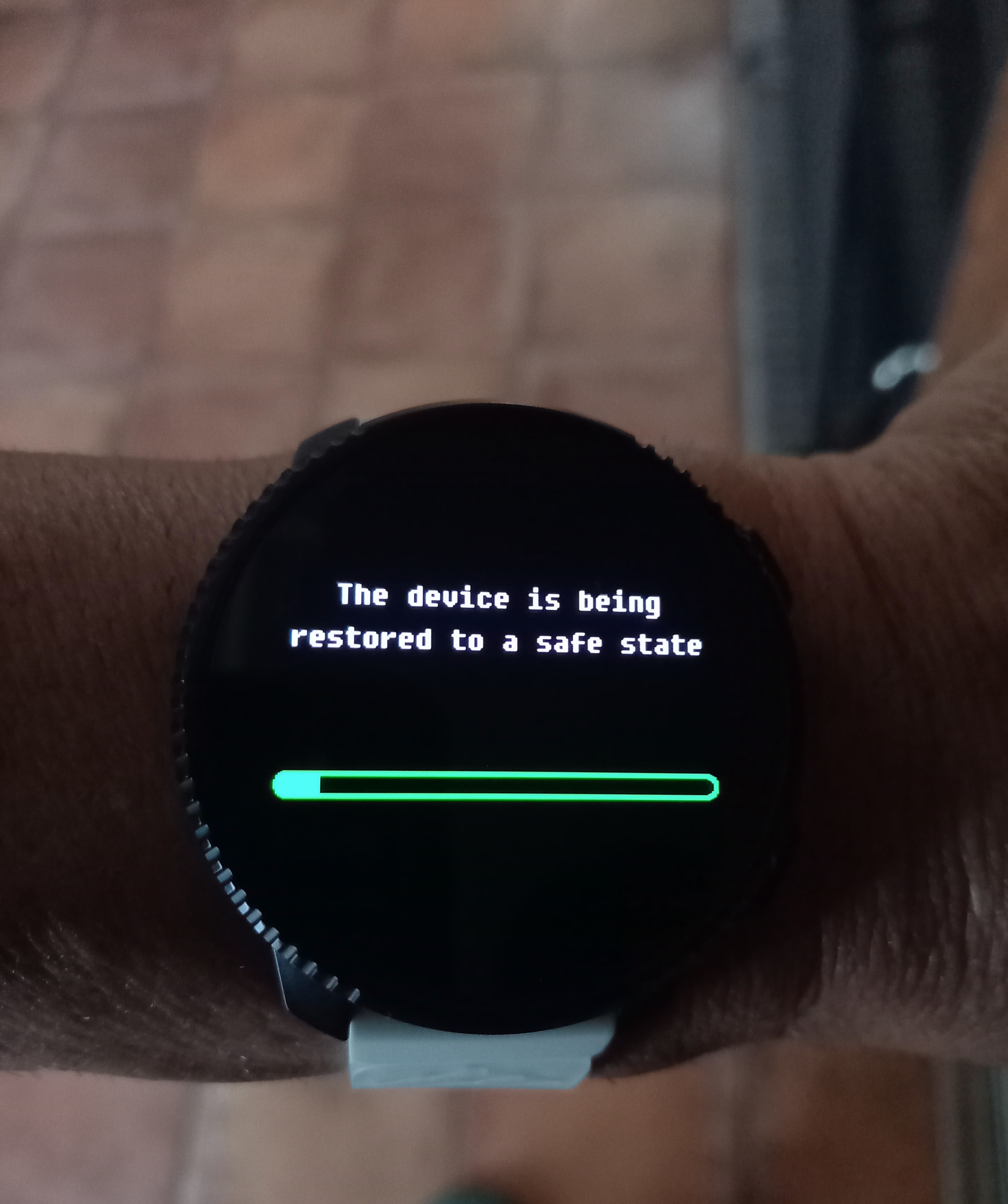

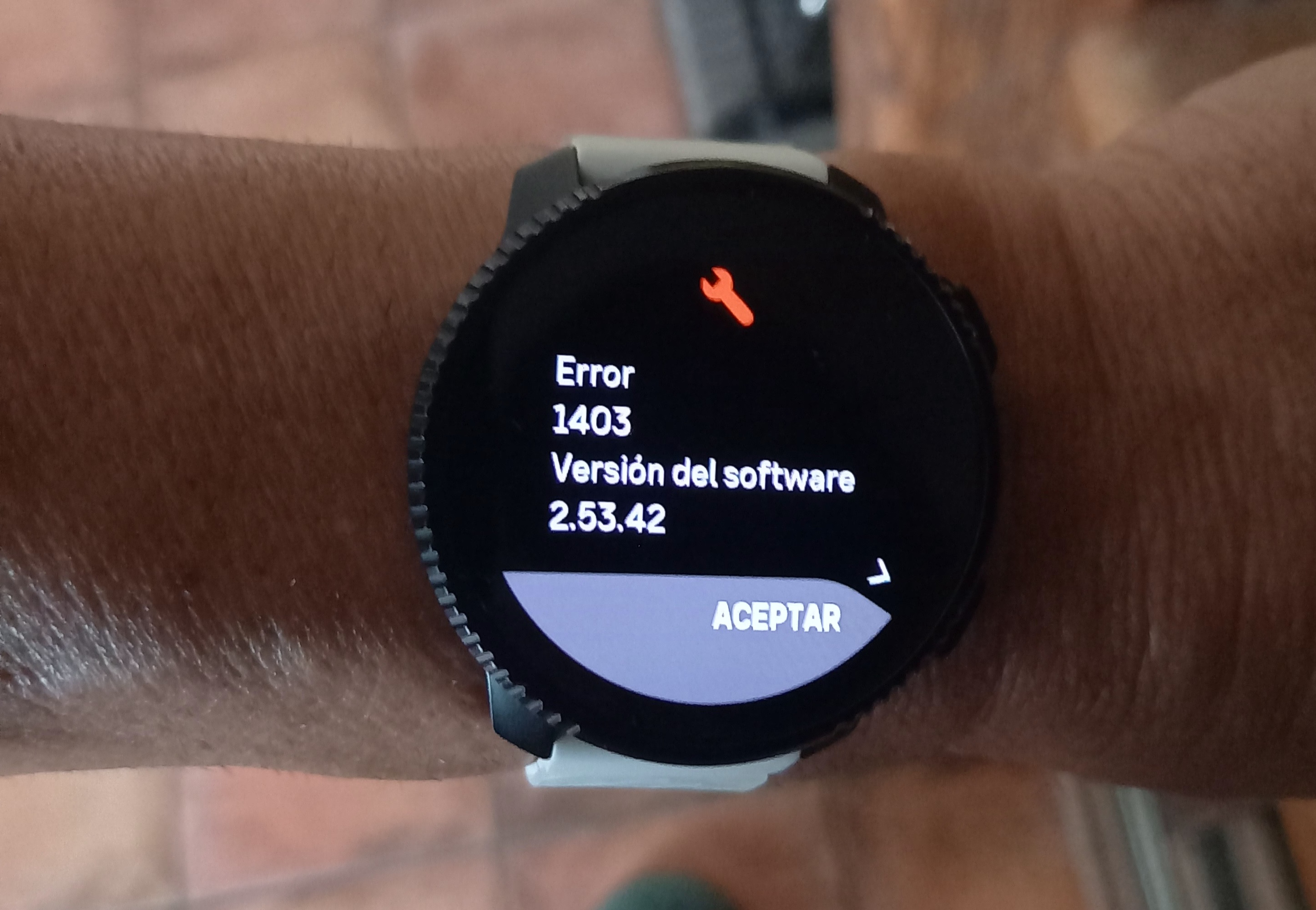

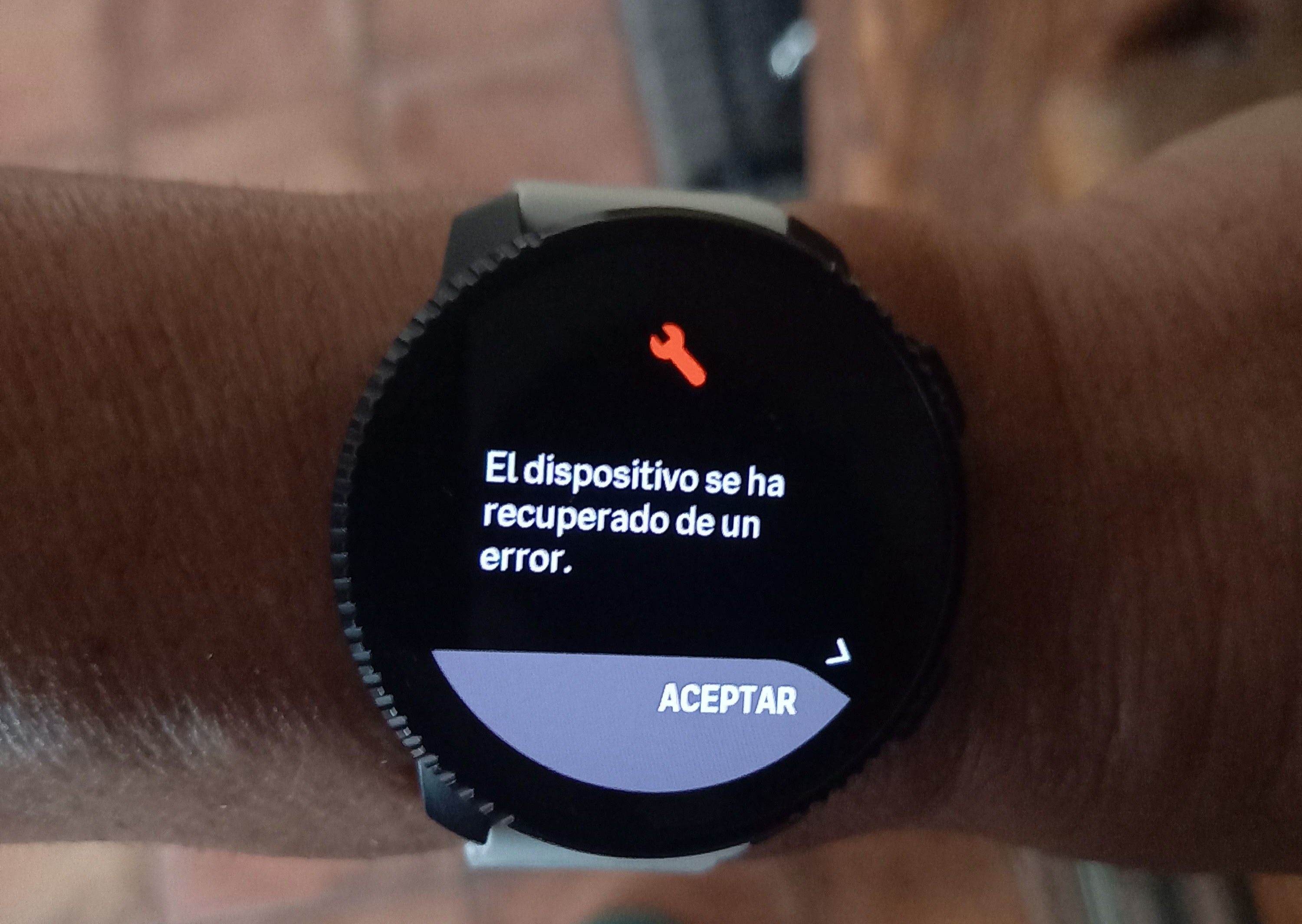

                      Hello everyone, same problem here (again) because a while ago Suunto’s technical service replaced my Suunto belt due to the same connection problems, after approximately 6 months of use of the Suunto band.
                      Tomorrow I will completely disconnect the band, install a new battery (after resetting the Suunto band) and then test it again with activity.
                      I’ve also considered that it might be possible using “Sports Mode Customization” after the last update a few days ago…it’s a shame and quite strange because.
                      Today I even started experiencing watch restarts when I unpaired the power meter from the bike, as I was ruling out sensors. After a 55-minute activity, it started disconnecting again approximately every 2 minutes.
                      I’ve attached images showing the clock reset and error message, in case it provides any useful information.
                      Sunnto VERTICAL 2
                      SALUD y SENSACIONES
                      isaziI 1 Reply Last reply Reply Quote 0
                      • isaziI Offline
                        isazi Moderator @Elmiuel
                        @Elmiuel how long has passed from the crash? Can you send logs?

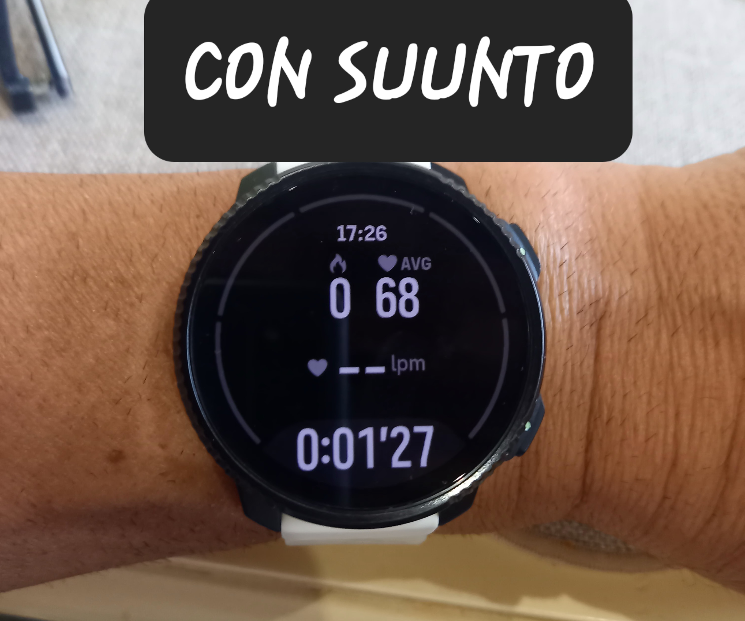

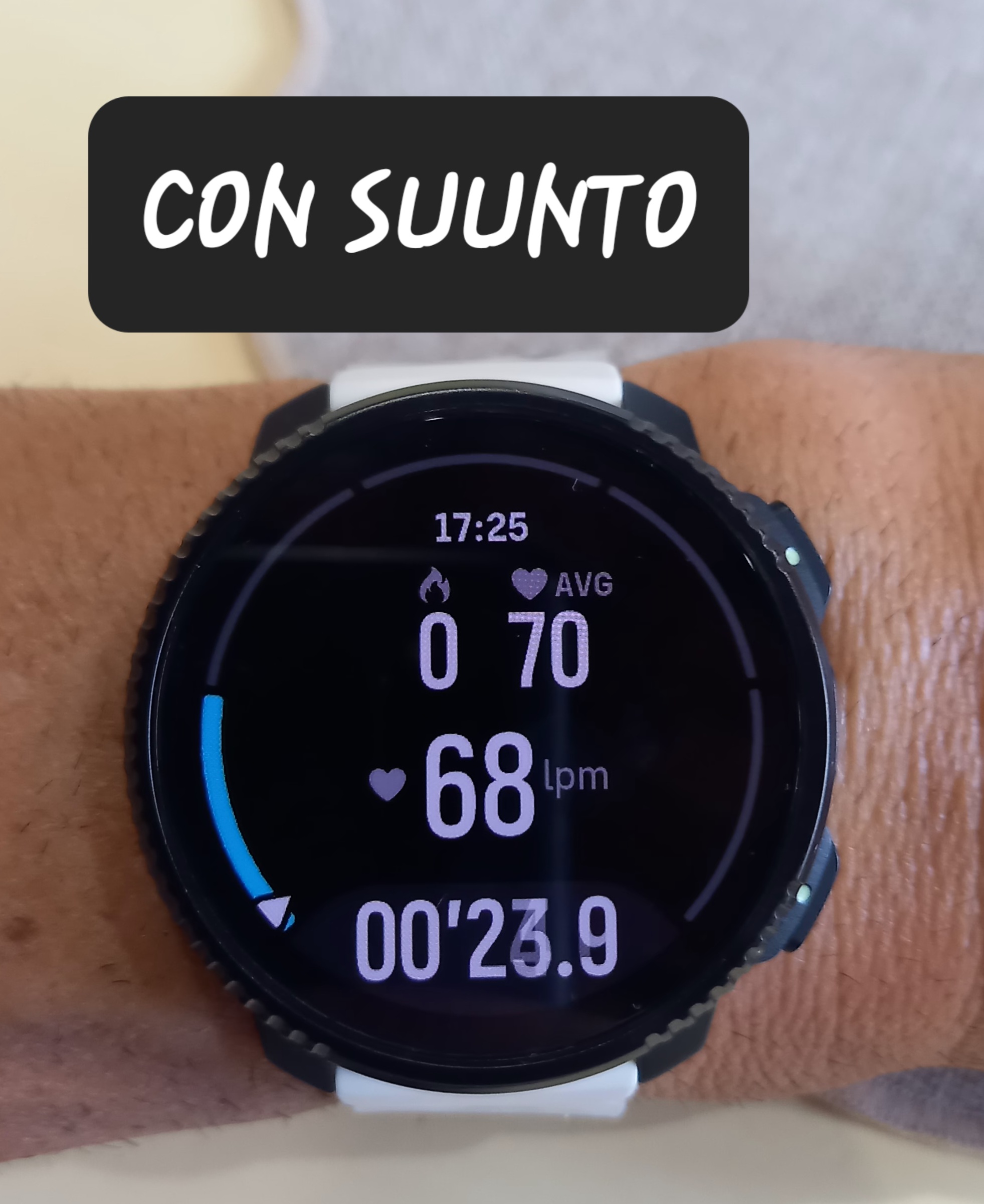

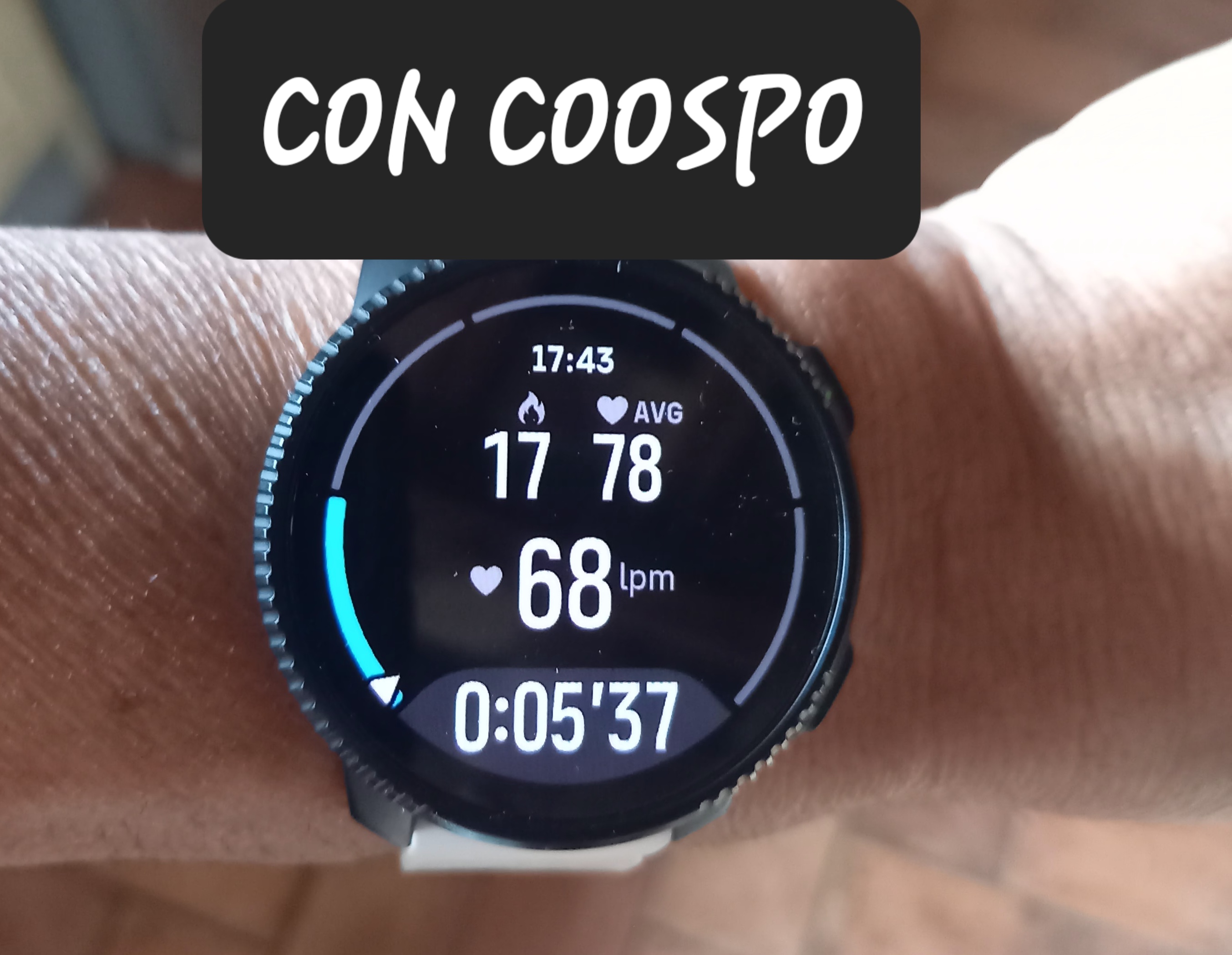

                            Hi everyone. So, I did a test with two different types of external heart rate monitors: the usual Smart Band Heart Belt and a supposedly inferior brand called “Coospo.” It was disappointing. I even recorded an activity that didn’t require GPS (dancing) for the test…
                            Using the Suunto strap, after a few moments…
                            Now with an external one, Coospo brand…
                            In my case, it’s clear: my original headband, after being serviced and replaced (theoretically) with a new one, has stopped working again after 7 months. I’ve tried hardly washing it… only by hand. I’ll send it to the repair shop tomorrow, as it still has a year of warranty left. After that, I’ll sell it in case anyone wants to continue the crusade 😓. I’m going back to the Polar H10…
                            Sunnto VERTICAL 2
                            SALUD y SENSACIONES
                            M 1 Reply Last reply Reply Quote 0

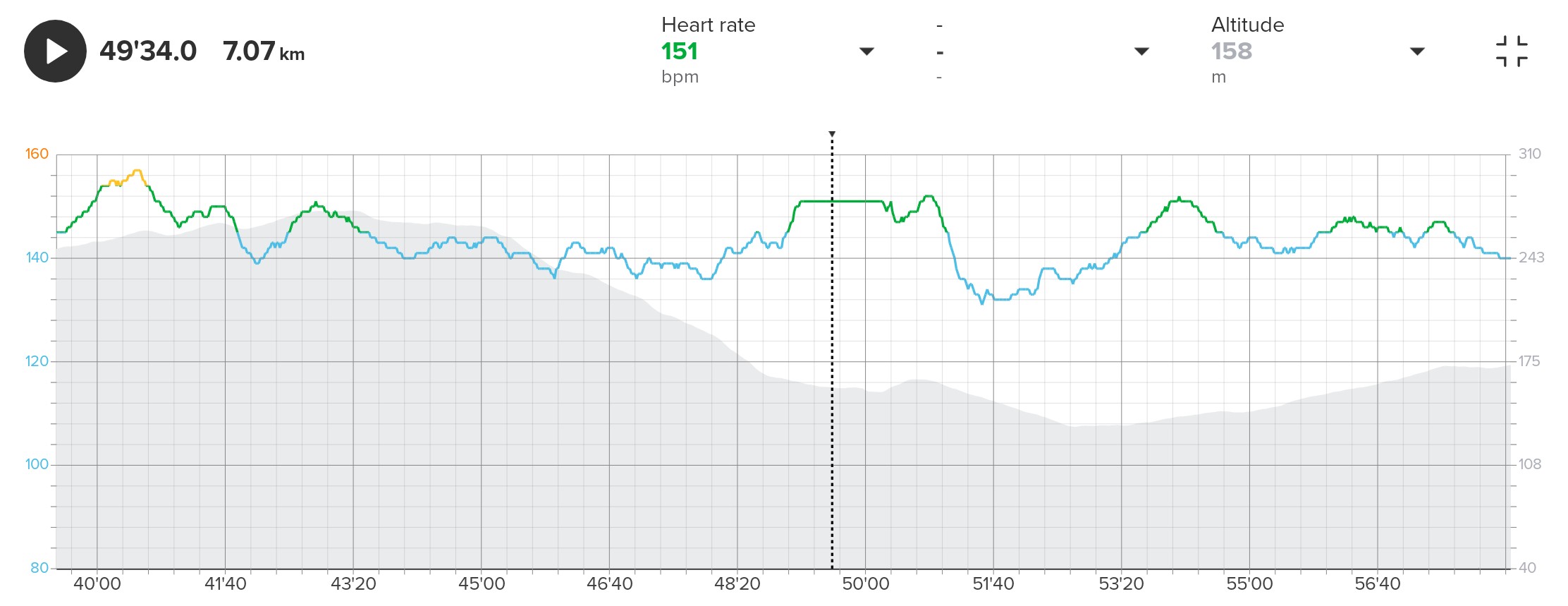

                                  In my screenshot above the area when the sensor is disconnected is flat lined, as other commented, I would prefer to have no data.
                                  Possibly it’s a limit of how data is represented having to link two values?
                                  I had another occurrence of this bug today and is always the same behaviour.

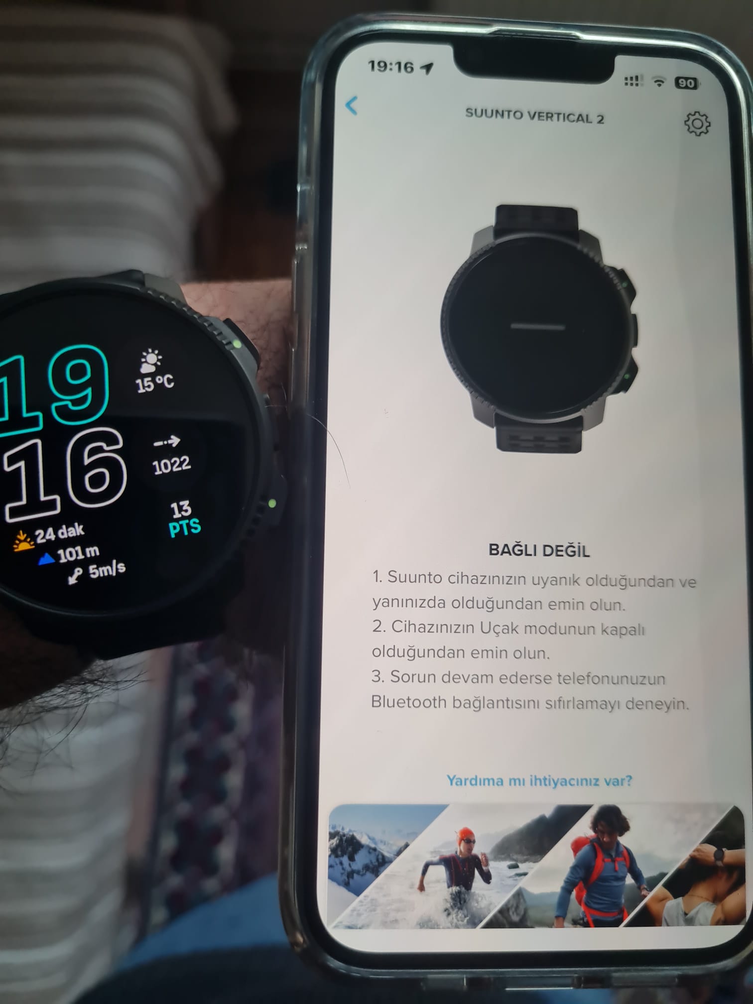

                                      The watch and phone are connected via Bluetooth, and I’m receiving notifications, but the app shows no connection. I turned Bluetooth off and on on the phone, but it didn’t fix the problem. What else can I do?

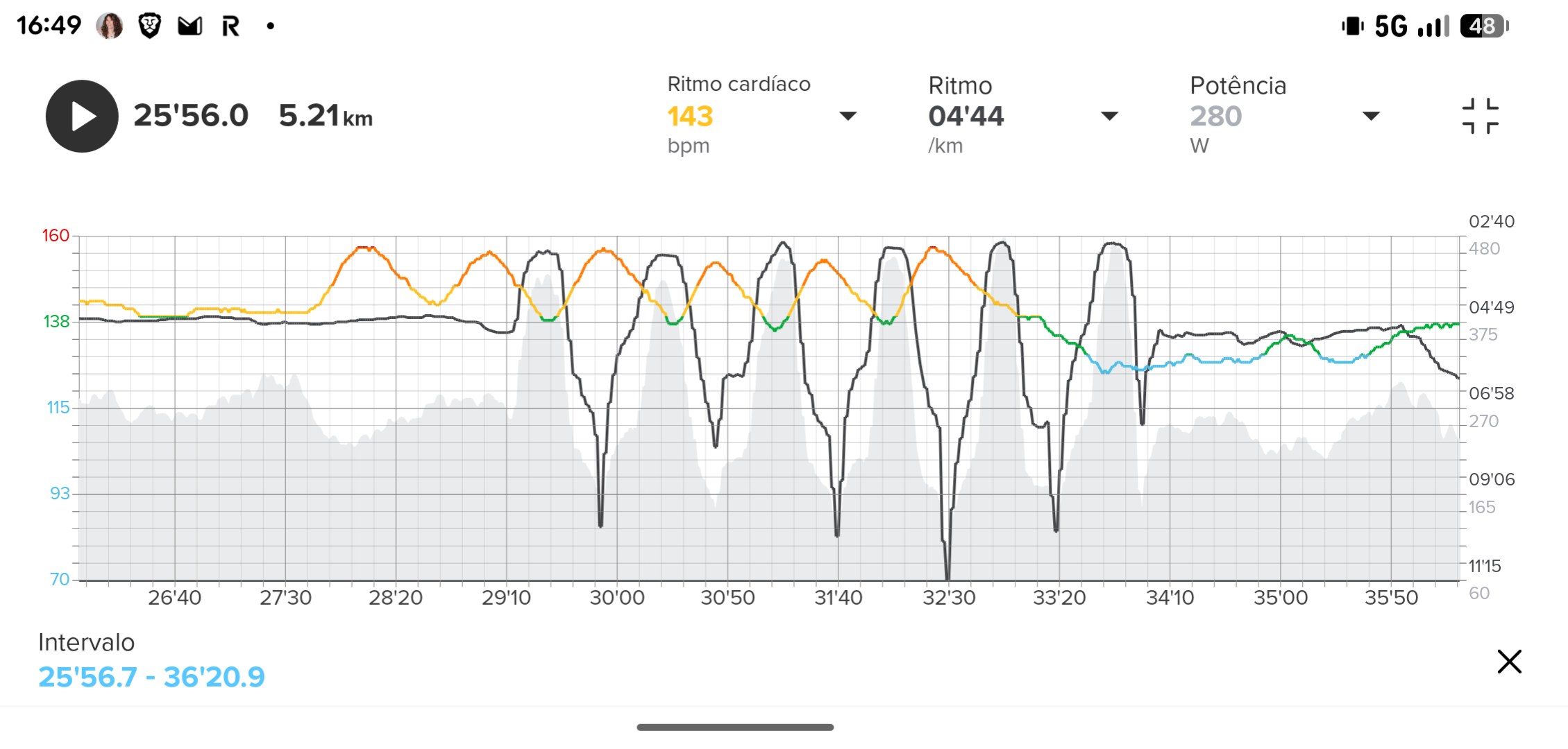

                                        Bluetooth connection to Garmin HRM crashed after few minutes. Logs sent 28.04.2026 21:44.
                                        It’s so frustrating, that bug present few FW ago is boiling my blood again.
                                        • Nelson DiogoN Offline
