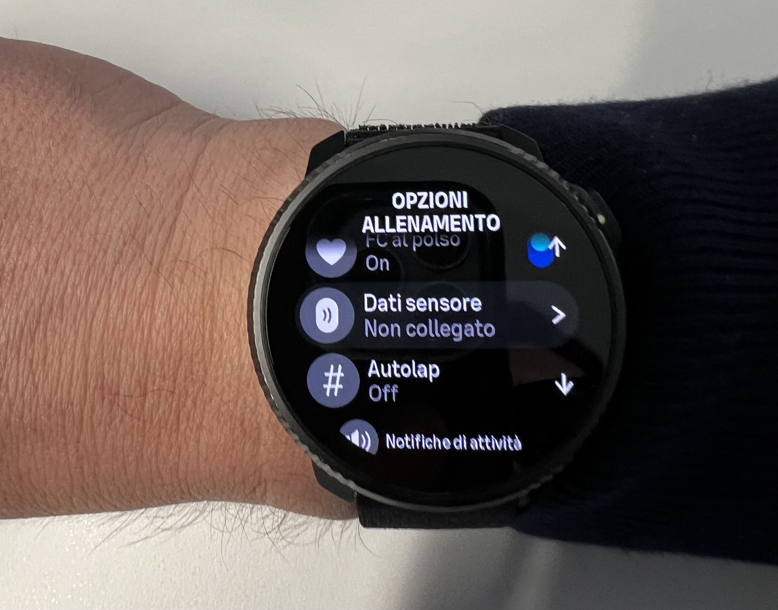

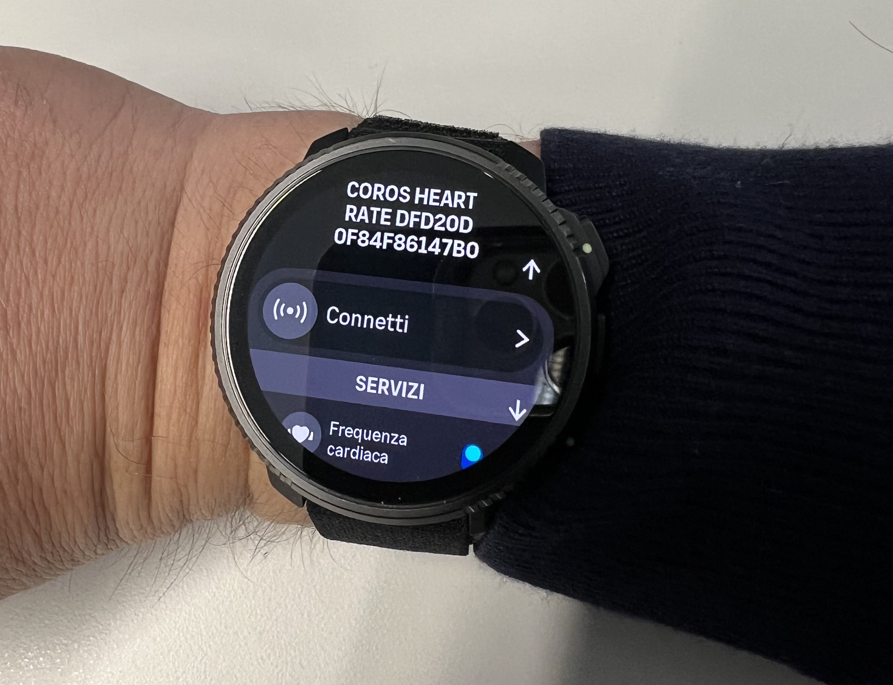

      Improvement: make the “workout options” menu accessible even after the activity has started, so sensors can be reconnected in case of disconnection or when switching devices due to battery depletion (e.g., during ultras).
      Currently, if the device loses connectivity with a sensor for a few minutes, it cannot reconnect automatically, and it is also not possible to reconnect it manually via the menu that is only available before starting the activity.
      Vertical 2 v2.53.42

          @isazi It’s not exactly a bug, but rather a feature that should be implemented.
          If I change the heart rate strap because the battery is dead, I’m not able to connect a new one since I can’t access that menu, which is only available before starting the activity.
          For example, yesterday I left the Vertical 2 on the treadmill and had to step away for a few minutes, which caused both Stryd and the HRM-600 to disconnect. I was no longer able to reconnect them unless I stopped the activity and started a new one.
          Vertical 2 v2.53.42
