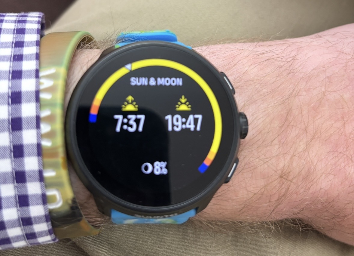

      Howdy all,
      Another bug to report—ever since the time change to daylight time here in the states, I noticed the outdoor watchface on Suunto Run has the indicator offset an hour early compared to reality, and compared to the sun/moon app (which aligns with reality). Numerous restarts haven’t fixed the issue—and I’m not that enthusiastic about ANOTHER master reset and reloading 2.5GB of music…just wondering if anyone else has noticed…

        @JebClydeNC If you like the layout, you can try “Ocean” watch face where you can select the same outer ring complication. I use that and it works correctly.
        But that is a bug for sure. (White 24hr triangle indicator an hour behind the actual displayed time.)
        @Egika please report this if possible.

            An update, for the developers, in case this helps: the sunset alert notification (which I have set for 30 min prior to sunset) displays a time an hour before actual sunset as well, so its off just like the watch face. And best I can tell, its been that way since the time change as well.
            In other words: actual sunset is 19:56, but the notification says 18:56, even though it triggers at the right time (19:26 in this case)
            I also uninstalled and reinstalled the watchface…and it did not fix anything…

              Update: Upgrading to 3.25.18 did NOT resolve the issues, neither with the watchface, nor with the alerts. Again, the alerts do occur at the correct time, but show a time for sunset and sunrise using standard time, not daylight time

                will report… other watch faces are buggy, too and I will put your report on that list

                  @freeheeler Update: Upgrading to 3.27.18 did NOT resolve the issues, neither with the watchface, nor with the alerts. Again, the alerts do occur at the correct time, but show a time for sunset and sunrise using standard time, not daylight time

                    watch face issues are independent from firmware updates.
                    I think it’s not a priority to fix it
